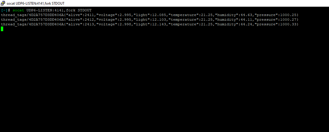

Step 6: Check the Data Incoming From the Thread Sensor Tag
Once the setup worked you can use socat to subscribe to the UDP port to receive the packets that the Thread Sensor Tag is sending. To do so first install socat on the Raspberry Pi by running
 sudo apt-get install socat
and with the following command you can subscribe to the UDP Packet Stream of the Thread Sensor Tag
socat UDP6-LISTEN:4141,fork STDOUT
This command will print the UDP Packets received from the Thread Sensor Tag every 30s which will look like this
thread_tags/XXXX{"alive":2411,"voltage":2.995,"light":12.085,"temperature":21.25,"humidity":44.63,"pressure":1000.25
where XXXX will be the unique ID of each device. The Thread Sensor Tag will measure the following data every 30 seconds:
You can run multiple devices in the same network and you can use tools like Home Assistant or node-red to translate this UDP pakets into meaningfull MQTT JSON messages or other usefull data formats to maybe save it into a database.
