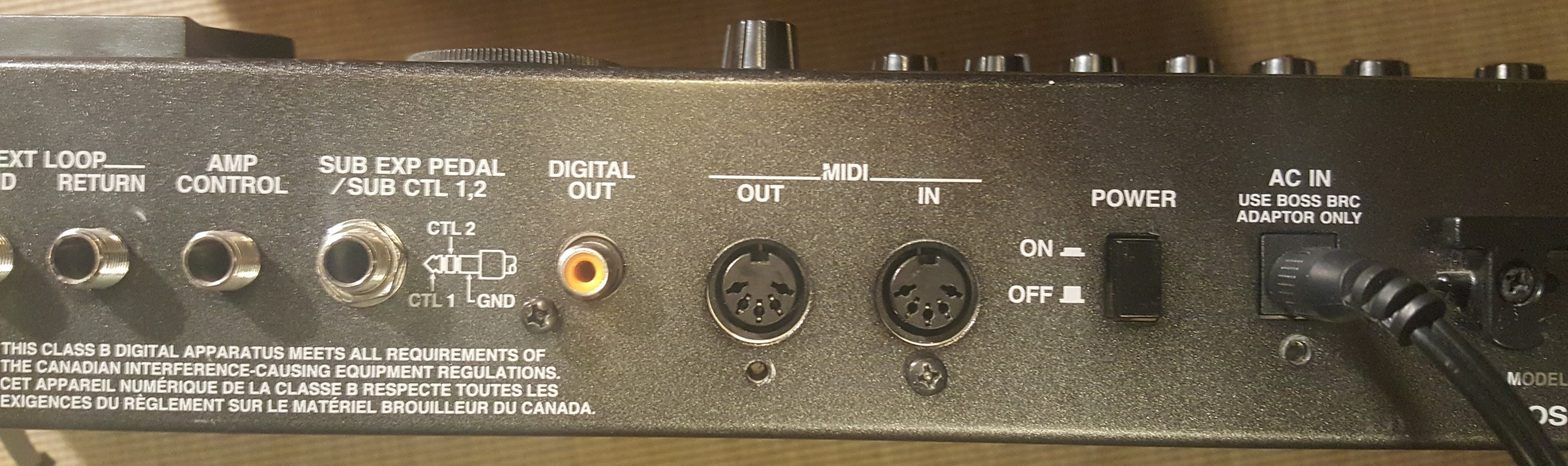

The expression pedal is nothing more than a potentiometer. My initial thought was simply insert my board between the pot and the main board. There is a 3 conductor cable that would have almost everything I need: power, ground, and a sense for the pot. For the LED meter itself, I had chose to use an pre-made APA-102 module with 8 LED's. I had used WS2812 before... not a fan. But the APA-102's do require 5V, so that had to be grabbed elsewhere. I've marked up the internals of the GT-8 to show where different signals are.
As it turns out though, the GT-8 outputs MIDI data for the expression pedal in real time. I didn't realize it until after I had sent the PCB out to be made. During my initial testing, I had unplugged the pedal to look at voltages, and ended up looking into the MIDI at the same time to see what the GT-8 sent out.... without plugging the pedal pot back in... On the bright side though, I always like to put a UART somewhere for debug. I was able to solder a connector awkwardly on the board and use the UART for my MIDI communication. This actually turned out to be a nicer solution, as the MIDI data doesn't need to be converted from analog reading like the pot (learning the pot min, max, then having to scale).
I am able to connect the UART in such a way as to not interfere with the normal MIDI communication to external devices, but still send and receive. I don't want to get into much MIDI specifics, but it's a pretty useful protocol when doing music stuff.
