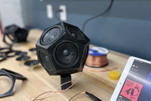

Hi, so I wanted a record lathe but did not have the money for one. So I made one. Then I wanted to buy a stereo cutterhead but could not afford one. So I made that too.
Details
Hi I'll try to get as much information of my lathe and cutterhead on here. I'm still continuing to improve aspects of the machine and i'll try to document the build as much as possible.
This model should be printed in polyamide using SLS or MJF. Alumide also works if you like the material. For use with a 2K S 160 A 2.0 NF dashpot from airpot.com
