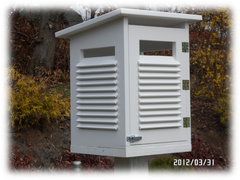

By the way, especially regarding measuring outside temperatures: Do you plan on making a special housing for your sensors to get "standardized" measurements?
Those are kind of mandatory to get the proper readings from your (temperature) sensors: http://www.wetter-weissenborn.de/bilder/Wetterhaus_1_gross.JPG
At least that's the typical style around here...
Weather.gov has a crazy detailed paper btw.: https://www.weather.gov/media/epz/mesonet/CWOP-WMO8.pdf
Capt. Flatus O'Flaherty ☠ wrote 04/30/2019 at 17:47 point
special housing for your sensors ….. Yes, that's a good idea. I've got some limited shielding, but have noticed bad temperature data when the sun comes round onto the device box.
