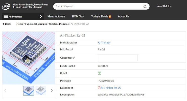

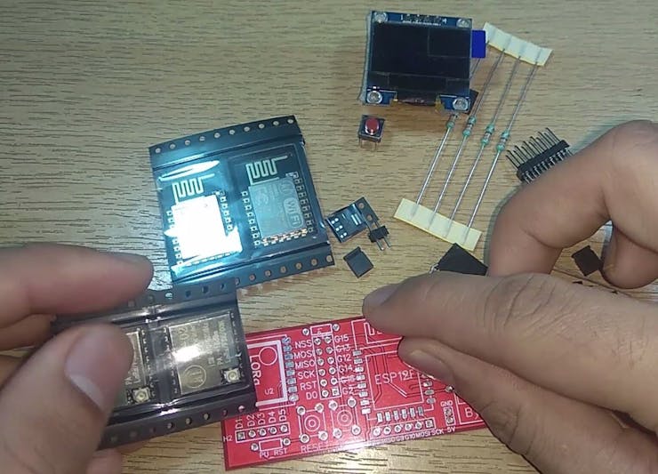

    I got the majority of the parts for my build from LCSC.
    You will need:
    1) Ra-02 LoRa module
    2) ESP8266
    3) OLED display
    4) Passive components like resistors and capacitors
    You would require the PCB to solder these components which we will take a look at the next step.

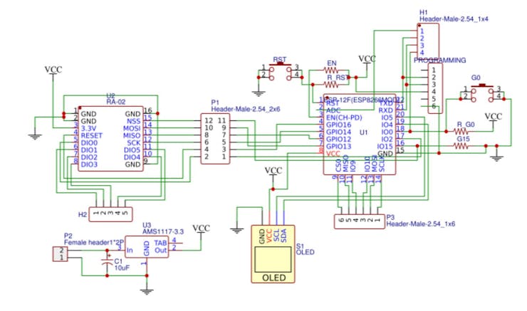

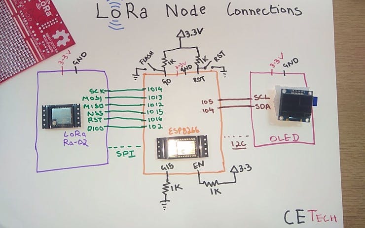

    Connections (THEORY)
    Mainly there are 4 aspects in connections here:
    1) ESP8266 just to function correctly needs some pull up and pull down the connection for G0, G15, EN and RST.
    2) Ra-02 and the ESP8266 modules are connected to each other using the SPI protocol
    3) OLED and the ESP8266 connect to each other using the I2C bus
    4) All the modules need to be connected to power rails for them to operate.(Obvious :P)
