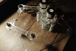

    I continue adding onto my controller program. I add another stop button, and LED button. At the bottom I add a custom command sender allowing me to test various other commands. After that I add sliders to control the pan and tilt of the camera and the driving speed. The picture below shows a glimpse of this stage of development, before I nailed down the details of the sliders.
