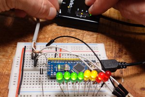

I'm just curious about how fast it is or is it possible to train neural networks on STM32 with limited FLASH and RAM, or even on 8-bit MCU Arduino. And it seems to be possible.

And test results on different MCUs:
MCUFrequencyFLASHRAMTrain TimePred TimeAccuracy
STM32F429IGT6180MHz1024KB256KB9s7ms96.0
STM32F401RET684MHz512KB96KB18s15ms96.0
STM32L475VET680MHz512KB128KB24s22ms96.0
STM32F103RCT672MHz256KB20KB32s26ms96.0
STM32F103C8T672MHz64KB20KB32s26ms96.0
Arduino M0 Pro48MHz256KB32KB135s97ms96.0
