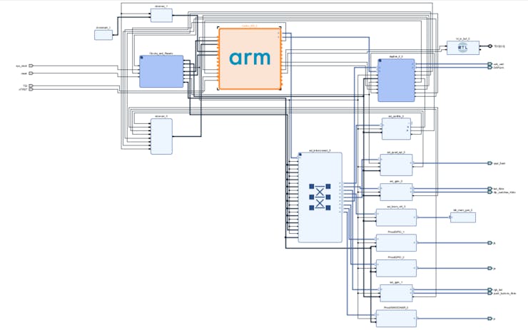

Within Vivado if you open the block diagram you will see the Cortex-M3 block and the supporting IP including AXI GPIO, AXI UartLite, AXI BRAM Controller and AXI QSPI.
Reference Cortex-M3 design in Vivado

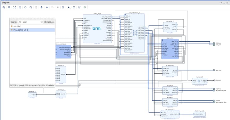

To dive both motors we are going to need to add in two PmodGPIO IP cores from the Pmod library. We can then port map these on the Arty Pmod Ports A and B.
The design will be updated as shows below
Adding in the PmodGPIO
Once the two PmodGPIO have been added you can run the connection automation to connect them into the system.

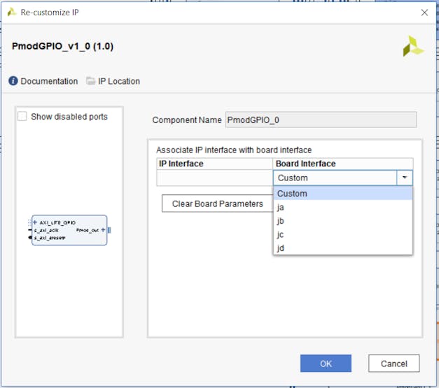

Once both PmodGPIO are mapped into the AXI system we can assign the outputs by double clicking on the PmodGPIO IP block and selecting the correct Pmod position from the drop down menu.
Selecting the correct Pmod

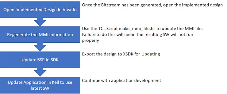

Once the design has completed implementation the next stages are shown below
Updating the design flow

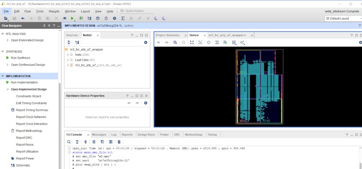

You can find the make mmi_script in the
V:\hardware\m3_for_arty_a7\m3_for_arty_a7
Directory, to run the file use the Vivado TCL console as shown below
Updating the MMI File with the implemented design open
Once the MMI file is up to date the next step is to export the hardware and update the BSP in XSDK.
Exporting the updated HW design
When we export the hardware design there is no need to include the bitstream, as we will be using Vivado to update the bitstream later.

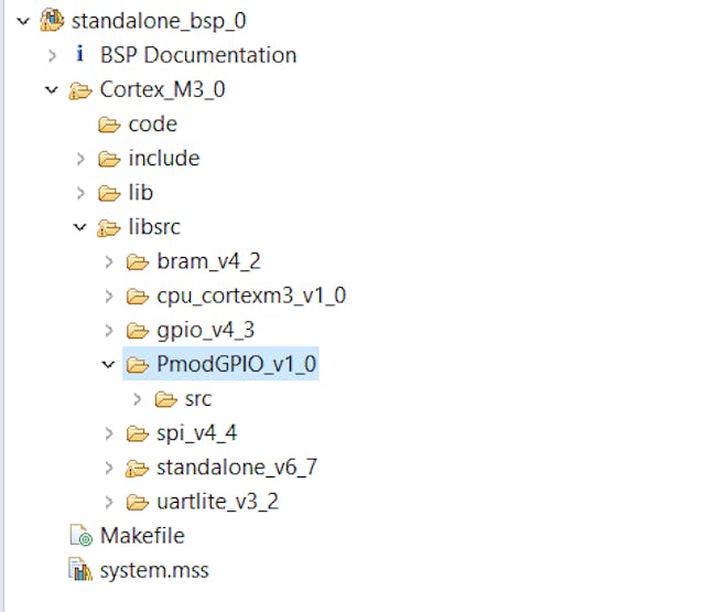

Click on yes so the hardware definition and BSP can be updated.
When this has finished under the BSP you will see the PmodGPIO drivers also included under the BSP Libsrc directory
Updated BSP with the PmodGPIO

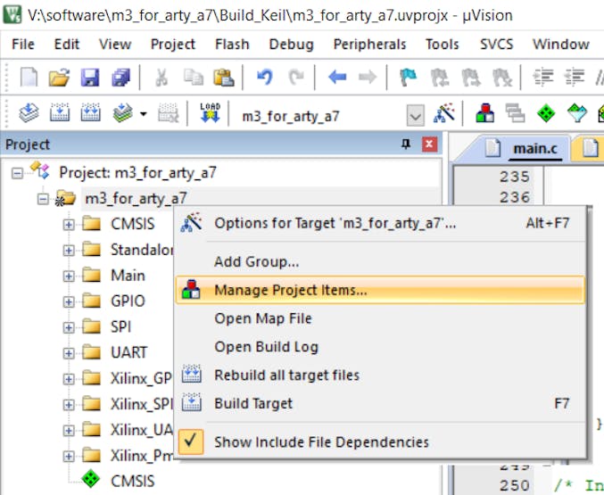

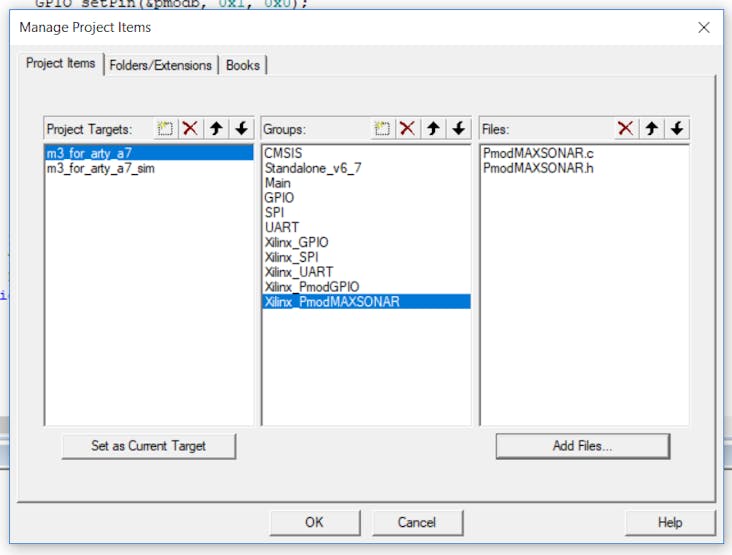

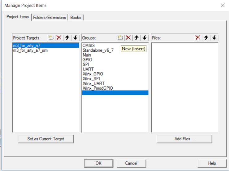

Once the BSP is updated, we can develop the application within Arm Keil. The first step is to pull in all of the new Pmod drivers. To do this we right click on the project and select Manage Project Items.
Opening the Project Items to Manage.
This will open a dialog, we need to add in the PmodGPIO and PmodMAXSONAR, we do this by selecting New and the entering a name.
Creating a new group
Once the group has been created the next stage is to import the source code and header files.
Importing the source code and drivers

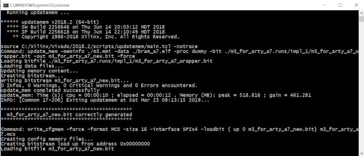

Once we have written the code the next step is to download it into the arty board.
When we build the code in the Arm Keil, a hex and elf file are created and copied into the hardware project directory.
Within this directory there is a batch script which will take these files and create a updated FPGA bit file which can be directly downloaded into the FPGA. The script will also produce a MCS file which is used for programming the Flash memory on the board such that the application is live at power up
Directory with the batch file and the ELF and Hex files present
Before you generate the updated files make sure the timestamps on the elf and hex have been updated.
The batch file running

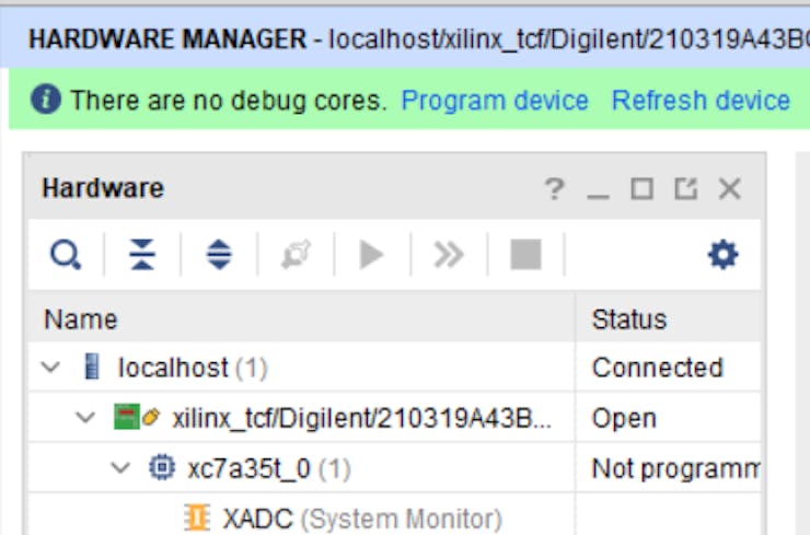

We can then use hardware manager in Vivado to download the new FPGA bit stream the application will then start running instantly.
Hardware manager
Hardware manager
Select the newly generated FPGA bit file and the image will download into the FPGA.

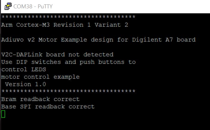

If you are connected over a USB serial link to the Arty board you will see the following message pop up
Application starting following download of updated bit stream

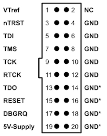

The JTAG pins are broken out on the Arty board to both PmodC and the Shield Connector.
The pins are
The pin out on the Segger J-Link is as below, we can use jumper cables to connect between the J-Link and the Arty A7.
SEGGER J-Link Pin out
The connections between the J-Link and the Arty can be seen as below, you should also connect the J-link to GND and VTref to the PmodC power pin.
J-LInk Arty Connections

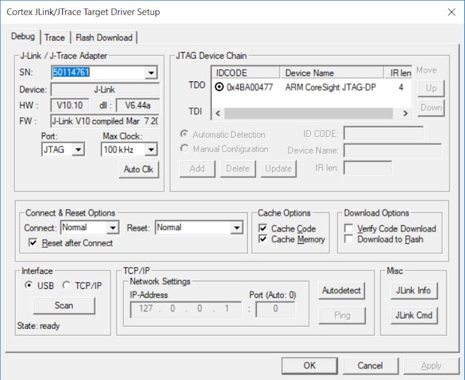

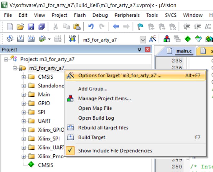

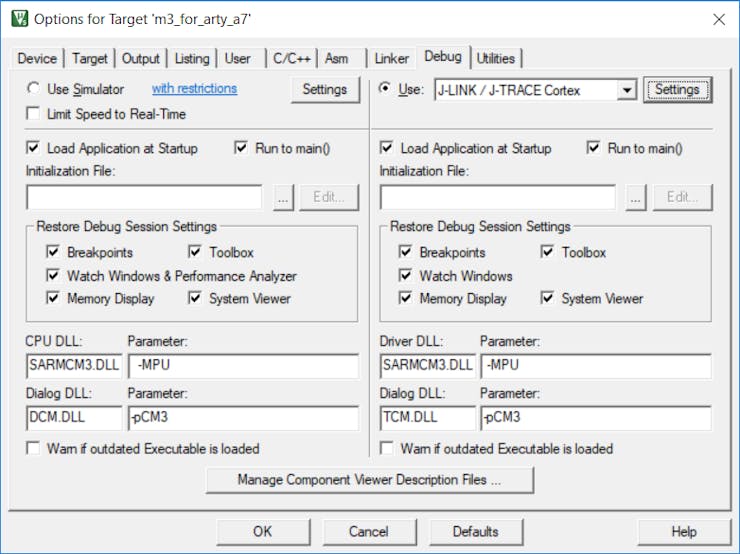

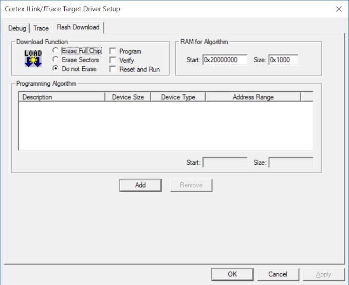

To use the J-Link within Arm Keil we need to configure the target options as below, we can do this by right clicking on the top level of the project and selecting options for Target 'm3_for_arty_a7'
Opening the Options
Opening the Options
This will open a dialog box, as I do not want to download to Flash, just debug. I configured my options as below.
Configuration of the Debug Tab
Select J-Link and click on the settings button
Configuration of the Debug Settings
Click on the Flash download and configure as below
Flash Configuration
Flash Configuration

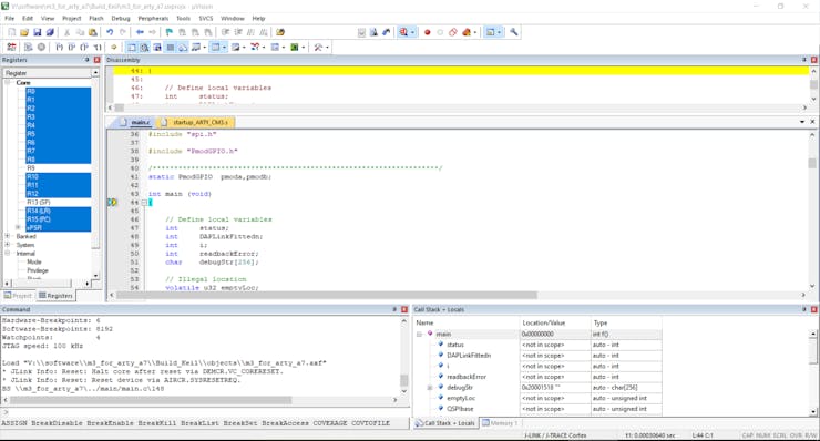

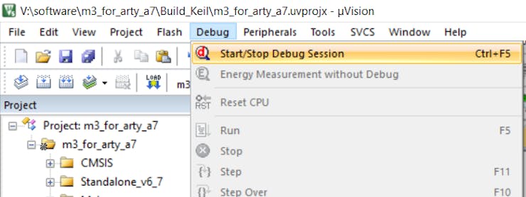

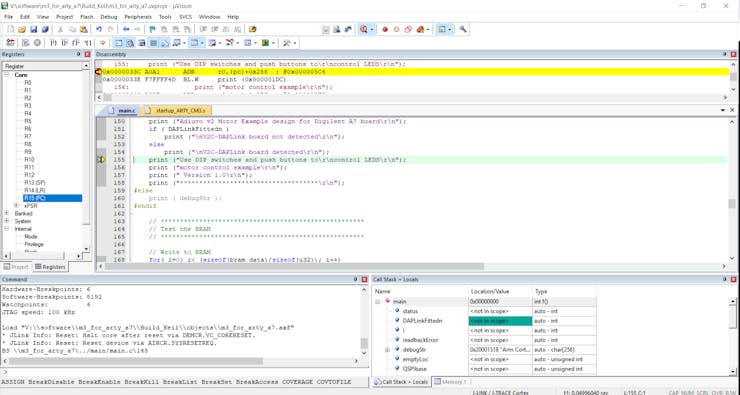

Once this is completed we can start a debug session, by selecting the start/stop debug session under the debug menu.
This will download the image and stop the program ready for execution. We can add breakpoints and single step etc just as we can with any other debuggers.
Debugger stopping at program entry
We can set breakpoints by double clicking on the left hand margin, the program can then execute until the breakpoint is hit.
Hitting a Breakpoint
