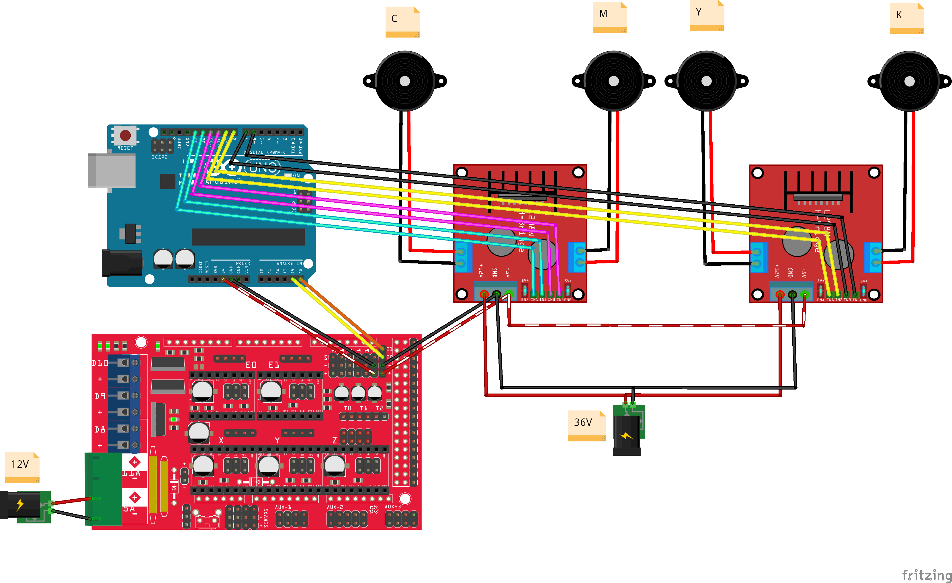

  • Redesign for Building Instructions
    Dominik Meffert06/05/2021 at 15:52 0 comments
    It's been more than a year since I last worked on this project, but for writing building instructions I redesigned it to be a printer add on, so that you can fit it on your own 3D printer, plotter or CNC machine.
    I again fitted it to an Ender 3 3D printer.
    On the pictures you can see that the build is made of the tubing for four colors, two SLA printed parts, four pumps, four filters and some electronics.
    The machine is powered by an external 36V power supply which is directly wired to the H bridges, stepped down to 4V for the pumps and stepped down to 12V for the printer controller.
    The printer controller controls two stepper motors and sends i2c commands to the Arduino UNO. The UNO sends signals (and 5V power to power their logic circuits) to the H bridges to drive the piezo discs in the printhead which eject ink droplets.
    Hope this pictures help you, if you are interested in the project and want to build it.
    I will also write step by step building instructions soon™.

  • CMYK
    Dominik Meffert01/05/2020 at 12:05 0 comments
    The last few weeks I changed a few things on the printer so that I can try CMYK printing. It would be a dream if it works out.
    I removed the 36V power supply, 3 L298Ns, the step down converter, the shift register, the WAGO clamps and the pump speed controller and added a 12V power supply, 3 more pumps, a much heavier speed controller and a step up converter.
    The printhead is now a 4 nozzle, single piece, height adjustable printhead for 4 different colors.
    The T fitting has been replaced by a SLA printed block for 4 different colors.

    • Piezo driver with Arduino Nano, transformer, 12V power supply, rectifier, MOSFET switch, fuses and WAGO terminals

coming to the points you mentioned for further optimizations, here is a bit of brainstorming, I hope this helps progressing further:
- Increase the resolution with the use of a smaller nozzle and optimized piezo control
if the nozzle of the 3d printer can be removed then the width of a single printhead can be reduced, this will enable stacking more printheads in smaller space. what do you think about drilling the nozzle on the printhead? 0.1 mm drill bits are available (on ebay for example) and can be used without breaking them using a proxxon or dremel with a drill stand. this should allow a spacing between nozzles below 3mm
- Simplifying the piezo driver electronics
I am thinking about using one single L298 to drive all piezos. this can be achieved if we can connect/disconnect the piezos pins from the L298 on demand. An easy way for realizing this, is to use relays. 16 channels relays are available. we can even think about reducing the number of pins by using the parallel interface of a shift register (such as 74HC595) instead of using arduino pins directly. From arduino side SR can be controlled using SPI (CLK to srclk and MOSI to ser) and  a gpio pin to rclk. this shift registers can command the relays. it can even be cascaded for a bigger number of nozzles.
