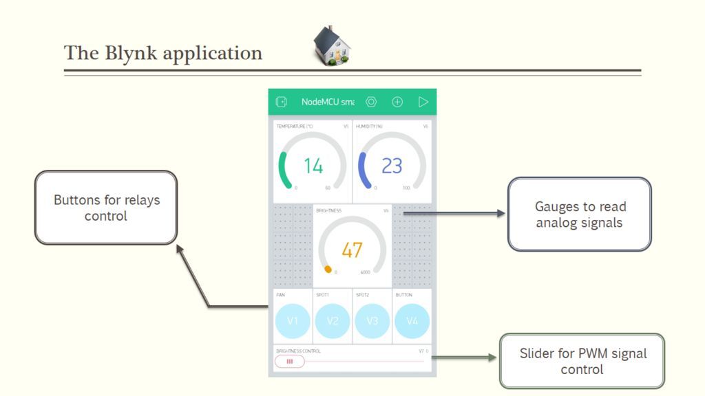

About the actuators, we will control some 220V AC bulbs and a DC fan and all these actuators will be controlled through an android app that we have developed through Blynk application. So in this application I inserted some gauges to read the analog values from the sensors and I placed some buttons and sliders to control my outputs.

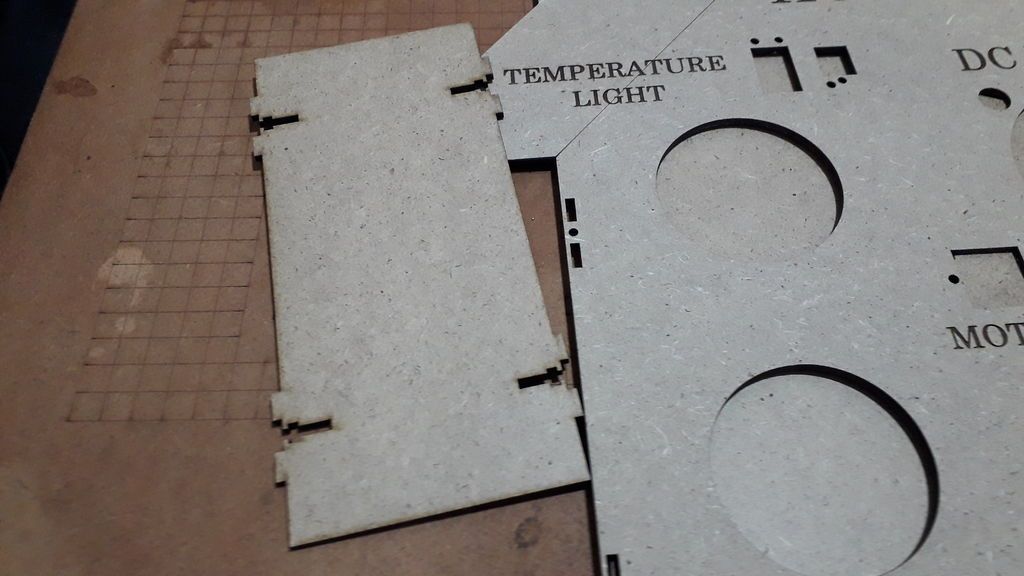

I used solidworks software to design this house model which already has sockets for the lightning spots the sensors and the fan, you can get the STL files from the download link down below, after preparing the design I have got my parts very well produced through a CNC laser cutting.

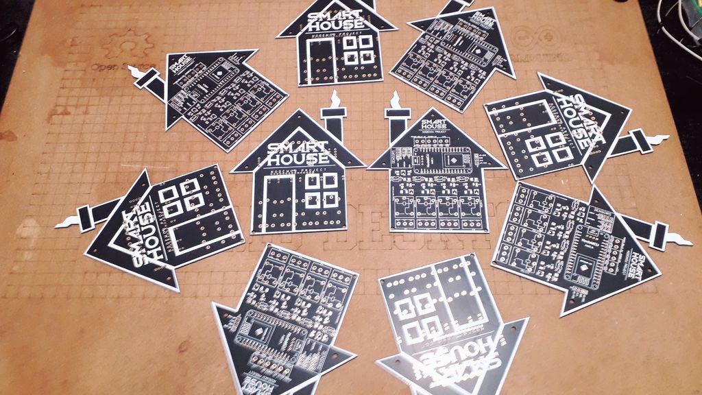

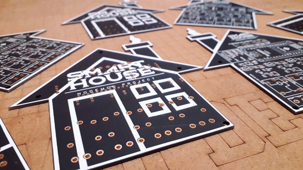

Step 4: PCB Making
About JLCPCB
JLCPCB (Shenzhen JIALICHUANG Electronic Technology Development Co., Ltd.), is the largest PCB prototype enterprise in China and a high-tech manufacturer specializing in quick...
