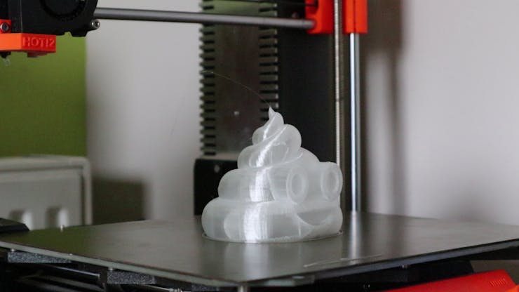

3D Printing
First things first, we need a container. In this case we chose to 3D print a nice colorful one. You can also use something else, as long as all the electronics fit.
Happy with our box, we can 3D print a poop emoji made by 3DCreatorPurzi. All we have to do is add a hollow space in the bottom to hold our NeoPixel ring.
All the model files are attached.
