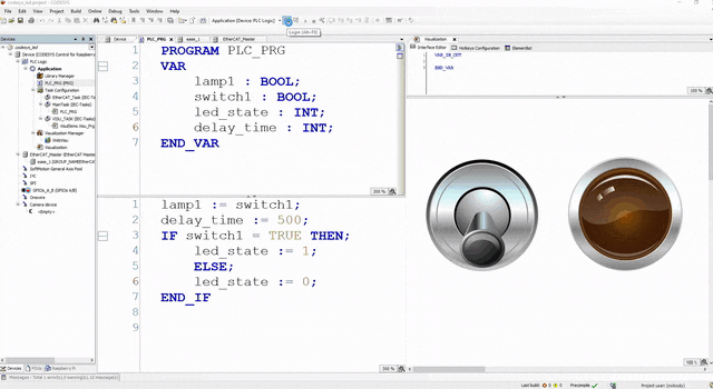

In this tutorial, you will learn how to set up a Raspberry Pi with Codesys to act as both a PLC and an EtherCAT master. It will be used to control the on-board LED found on the EtherCAT Arduino Shield by Esmacat (EASE) Slave device that is attached to an Arduino Uno.

Programming the Esmacat Master: Open the Codesys software and import the.project file downloaded from the Code section and build the source code. Suggested Reading: Section 8 Getting Started with EASE & Codesys. Coding the Arduino: Open the Arduino IDE and create a new sketch file. The complete code for this tutorial is available under the Code section named "EASE_codesys_onboard_led". Compile and Upload this code into the Arduino board connected with EASE. Note: Make sure you check whether the Board and Port are chosen correctly in the IDE.

When running the master code you get a result similar to the following on the Codesys environment (with a graphical UI showing the update of registers in EASE).
Results:
By now you have successfully programmed the Arduino boards and the Esmacat master! The visualization tool in Codesys gives a graphical UI to control the on-board LED in Arduino similar to the GIF attachment at the start of the tutorial and the YouTube video below. Final Notes: A detailed step by step tutorial for this project can be found in the document attached below. Suggested Reading: Getting Started with EASE & Codesys.
