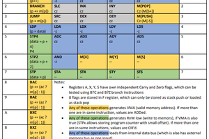

A microcode compiler developed to fit into FPGA toolchain and validated to develop CDP1805-like CPU and text-based video controller
Make creation of complex CPUs and other controllers easier by extending the usual FPGA toolchain with a new tool: microcode compiler.
Microcode compiler converts a symbolic, macro-assembler like language (common for ANY CPU or controller!) into 2 memory blocks of any size:
- "mapper" that maps higher level CPU instructions into start points of microcode routines
- "microcode" that describes steps in executing a higher level instruction
These two are consumed by a standardized, auto-generated control unit (see digisim illustration) which can be dropped into the design, along with the 2 memory maps above. These 3 components can make up over 50% of any design, the remaining is specific / custom, but even that follows simple rules.
To validate, a CDP1802 microprocessor and TTY to VGA controller have been written and are free to use (see gallery for samples of BASIC code test runs)

  • Boilerplate VHDL code generation from microcode
    zpekic11/15/2020 at 07:28 0 comments
    As I started working on a new design, I realized quite a bit of VHDL code needed could be generated by the microcode compiler itself.
    Typically, a micro-coded CPU/controller contains:
    1. control unit (generated using .controller statement)
    2. microcode store (generated using .code statement)
    3. instruction mapper store (optional, generated using .mapper statement)
    4. various registers that need to be updated from different sources (register + MUX)
    5. internal components (such as ALUs) fed from different sources (MUX)
    6. various lookup tables / ROMs
    7. other combinatorial logic
    The guiding principle behind my microcode compiler and associated hardware is  a pattern and template oriented approach as a trade off between increased productivity and quality vs. somewhat less flexibility and compactness. To keep with that design philosophy I improved the compiler so that in addition to 1. - 3. above it can also generate boilerplate for .4. and 5.
    Basic idea is to generate a (commented) boilerplate VHDL code which developer can choose to copy and paste into the design and modify there as needed.
    While there is an extra copy/paste step, the beauty of this approach that no tooling updates or touches the human developed code, they remain independent.
