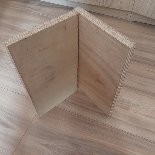

So I first started out by making a frame out of some wood panels that I had laying around. I cut 4 pieces of 16, 5cm x 33cm (6, 5 inch x 13 inch) and connected two of them with screws together like you see in the picture below:

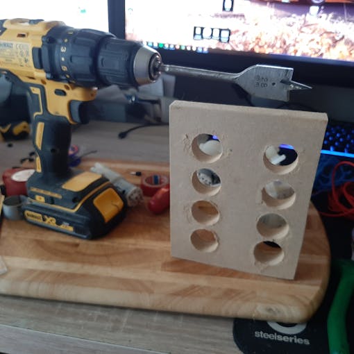

Then I cut a another piece of wood to the dimension of the inner side of the square when you would connect all plates together we cut previously. And drilled some holes in it with the 28mm drillbit. Make sure the centre of the holes are 5cm (2 inches) spaced out so you have enough room for the pumps there.

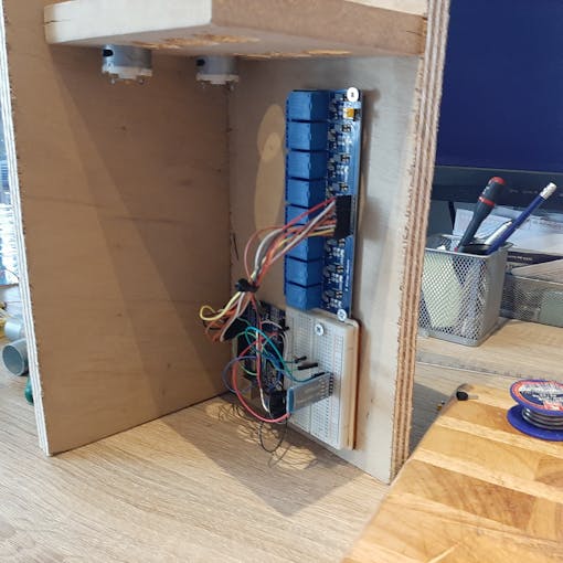

Then it was time for connecting the Arduino Uno with the Bluetooth module and the relay board. You don't have to connect the pumps. Use the wire schematic to do so.
We wan't to check if the circuit of the relay board, Bluetooth module and the Arduino Uno work. So after this download the code to the Arduino Uno.
So now I should recommend testing the circuit. First you should download the app and connect the Bluetooth module. Make sure the Bluetooth module is powered on and is blinking.

Pleas note that I made the app so that you have to press for a longer time on a button to make sure accidents stay at a minimum. So push the buttons for 2-3 seconds.
So when pressing a cocktail you should hear the relays turn on and off. You can also check the lamps on the relay board. A good way to test all pumps is to run the cleaning program. Each relay should be activated for 5 seconds each one by one.

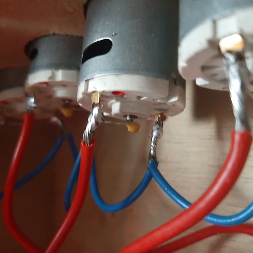

You should solder on the capacitor of 1qF. You have to do this because otherwise the radio frequency noise of brushes of the DC motor will cause the Bluetooth module to disconnect and other stuff you do not want.
The soldering of the wires should be done in a later step not this step

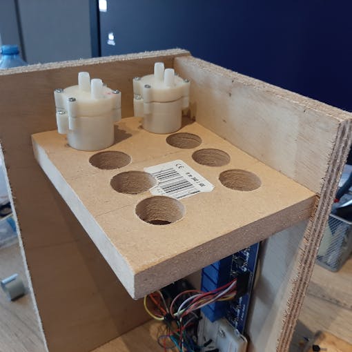

After this you can connect the power supply and the pump. Put the pumps in the holes we drilled earlier. To do so you have to remove the extra round shielding component. This snaps of easy. Keep one aside because we gone use it later.
No you can connect the power supply, relay board and pumps together using the wiring diagram. After this you can check with the app if the pumps are working. If you have problems with the Bluetooth communication you should check if any of the capacitors is came loose.
