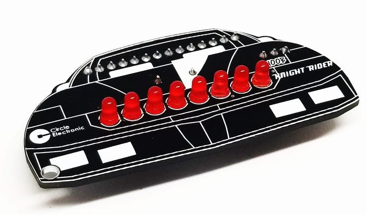

Meet the Circle Electronic NOOB Series Knight Rider!
https://www.circleelectronic.com/knight-rider
What can you do?
Knight Rider circuit LED Animation

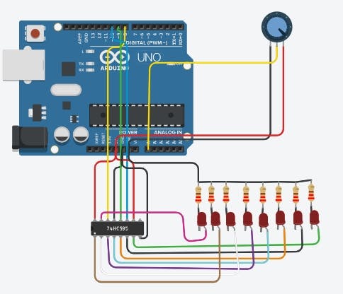

Circuit Diagram
Circuit Diagram
https://www.tinkercad.com/things/6KD66LWNaAa
We will use 74hc595 Shift Register in this project.
So, how to make this animation with shift register.

Now we will read the data from pot
We will connect the pot middle pin to arduino analog 0 pin and read the datas
int pot=A0;
void setup() {  pinMode(pot,INPUT);
void loop() {  int potvalue = analogRead(pot);
These are the data we get after making the connection. When we change the potentiometer, we read a value in the range 0-1023. We have to convert these values to 0-11.
We will use the map command to do this:
potvalue=  map(potvalue,0,1023,0,11);
