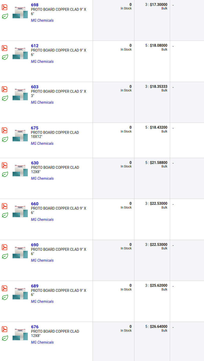

Lions started etching boards in May 2009.  Lions have always used single sided, photoresist coated copper boards, 1/32" thick, from MG Chemicals.
