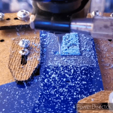

  • QFN-16 breakout (3mm x 3mm package, 0.5mm pitch, 1.7mm pad)
    Paul McClay05/02/2023 at 21:34 0 comments
    Apparently "QFN" is a broad category and "QFN-16" doesn't mean much without parenthetical elaboration. The buried point: 0.5mm pin pitch:
    That beats earlier 0.65mm "fine pitch" results.
    Yes, the two top-left holes are a little bigger. Getting through the whole process without error eludes me. Defaults and scripting in the toolchain (mainly FlatCAM & bCNC) would help, but first efforts at that haven't yielded much yet. In this case, I (i.e. it) drilled all the holes with a 0.9mm drill (25mil * 2^0.5), then switched the drill for a 1mm 2-flute end mill to cut the outline, then watched it re-drill two holes before remembering to load the cutout file. Sigh. (Earlier I tried plunging holes with the 1mm end mill, which would save a tool change, and which worked until the piece where each hole got shallower as end of the bit got duller.)
  • 0.2 mm center-to-center circuit board traces
    Paul McClay04/28/2023 at 21:14 0 comments
    • getting the 3d printed XY stage sorted well enough to match the laser-cut version
    • some "0.1 mm" Vbits are more equal than others
    At 0.2 mm pitch, the remaining copper is pretty near exactly one hairsbreadth:
    ...and the 0.15 mm traces -- even more thin than a hair -- aren't completely obliterated. The ends anchored to the 0.2 mm traces fared better than the ends that got cut free at the last pitch shrink to 0.1 mm. Maybe <0.2mm could work for short straight links between less thin copper areas -- like sneaking a trace between fine-pitch IC pins? Counting copper and two cuts, that would get a trace through a 0.3 mm gap or maybe smaller.
