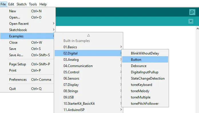

LED And Switch Using Arduino Uno
You can use Arduino to turn on LED when we press a button. A switch is a electrical component that completes a circuit when pushed & breaks.
292 views
0 followers
The project describes how we can easily use Arduino to turn on LED .
Build The Circuit
Build your Arduino circuit by looking at the breadboard designing image above or as per description mentioned below. Here letters and symbols combined structure indicate that combination of column and row.
Step 1 – Connect the blue jumper wire from the GND on the Arduino to the GND blue rail on the breadboard near column A & row 13.
Step 2 – Connect the blue jumper wire from the GND rail on the breadboard near Column A & row 17 and to the H Column 17th row.
Step 3 – Connect the red jumper wire from the power rail on the breadboard around row A column 27th row and to the column H row 26th.
Step 4 – Connect the green jumper wire from pin 2 on Arduino to J24 on the breadboard.
Step 5 – Place one side leg of 10k Ohm resistor in G19 and the other side in G24
Step 6 – Locate the push button switch into F24, F26, E24 and E26
Step 7 – Place one side of leg of 220 Ohm resistor in D5 and the other leg in G5
Step 8 – Insert the short leg of the LED in the GND rail around A5 and the long leg in B5
Step 9 – Join the black jumper wire from pin 13 on the Arduino to I5 on the breadboard.
Step 10 – Attach the red jumper wire from 5V on the Arduino to power rail (+) near A8.
Step 11 – Attach the Arduino Uno to your computer using USB cable.
Upload Switch Sketch
Upload the sketch to the Arduino that will allow us to use a switch.
In order to utilize a switch, we have to load the file called “Button” which can be seen here: File > Examples > Digital > Button
Switch Sketch
Switch Sketch
Next, you need to click on the check mark that is placed in the top left of the IDE box. Once it shows “Done Compiling” we are ready to upload it.Click the upload forward arrow to send the program to the Arduino breadboard.
Press the button switch on the breadboard and you should be able to turn on/off the LED. Check the project schematic shown below:
  • 1 × Arduino Uno Board
  • 1 × Solderless Breadboard Half Size
  • 1 × Jumper wires (generic)
  • 1 × USB Cable Electronic Components / Misc. Electronic Components
  • 1 × 5 mm LED: Red
View all 8 components
  • 1
    Run a Program
    const int switchPin = 4; //Switch Connected to PIN 4
    const int ledPin = 8; //LED Connected to PIN 8
    int switchState = 0; // Variable for reading Switch status
    void setup()
    pinMode(ledPin, OUTPUT); //LED PIN is Output
    pinMode(switchPin, INPUT); //Switch PIN is input with PULLUP
    void loop()
    switchState = digitalRead(switchPin); //Reads the status of the switch.
    if (switchState == LOW) //If the switch is pressed
    digitalWrite(ledPin, HIGH); //LED ON
    delay(3000); //3 Second Delay
    digitalWrite(ledPin, LOW); //LED OFF
View all instructions
Ken Yap wrote 08/25/2020 at 11:06 point
It would be much more enlightening and interesting if you showed how to toggle the LED with the switch otherwise someone might ask why don't we just do away with the Arduino in between. It would also illustrate switch debouncing.
