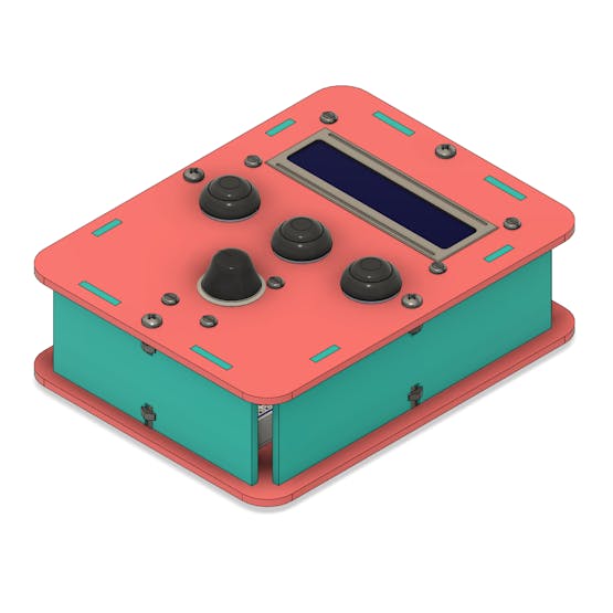

The project was developed from the structure presented below. This structure is responsible for guarding and protecting the gas leak detector circuit.

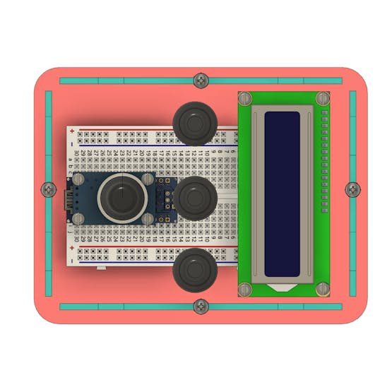

The case has an LCD display, 3 buttons, and an MQ2 sensor.
The LCD will be used to present the information of the gas level monitoring and to present a menu for adjustment of settings by the user.
This adjustment can be made using the 3 buttons.

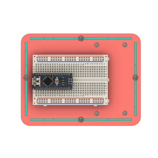

Next, we present the structure of the internal circuit. The internal space allows you to place an Arduino Nano on a small Breadboard.
After installing the Arduino, connect the elements of the project and start programming the project. Below, we present the connection structure of the circuit elements.

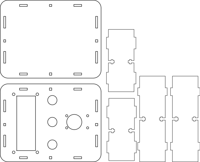

After that, download the files for laser cutting on 2.5 mm thick calls.

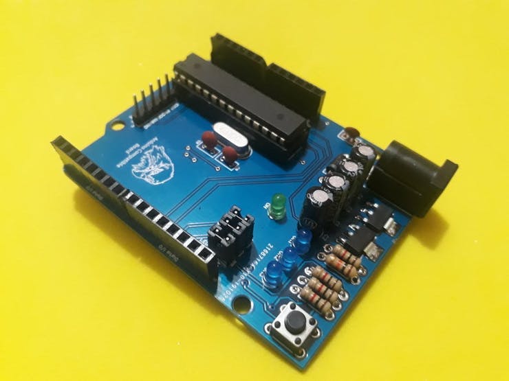

Download this file in the Attachment section.In addition to offering you the files, we will also offer the Arduino JLCPCB Compatible Board project.
Para realizar a fixação das peças da case, utilize parafusos
A Big bonus of JLCPCB.COM
The JLCPCB wantsto offer 10 units of this Arduino JLCPCBcompatible PCB for your projectsfor$2 in your first order with the link:Earn my PCBs Arduino Compatible.
Access the link and download the Gerber files of the JLCPCB Arduino Compatible Printed Circuit Board.

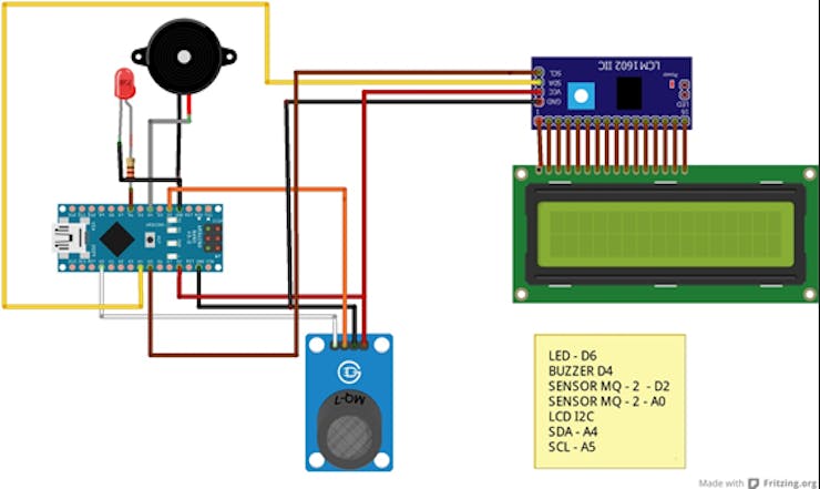

To perform the detection of this gas we will use the MQ2 sensor, this sensor has a resistance that varies according to the gas detection, it is possible to adjust its sensitivity through a trimpot present on the plate.
This detection system will consist of an Arduino Nano, MQ - 2 sensor, red led, buzzer, and I2C 16 x 2 LCD display.

As previously mentioned, the project consists of creating a kitchen gas detection system with the MQ - 2 sensor. Next, we will explain the details of the operation of this sensor.

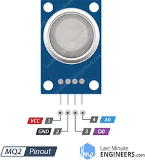

The MQ2 Sensor
The MQ - 2 sensor is a sensor capable of detecting flammable gases such as LPG, Propane, Butane, Methane, among other flammable gases.
This sensor has two outputs: a digital one that when the gas is detected it goes to 0 V and an analog output that varies its value according to the presence of the gas in the environment.
In figure 2 we have the schematic circuit with the necessary connections for assembling the project.
Figure 2 - Schematic circuit with the connections of the MQ - 2 sensor and the LCD display to the Arduino nano.
After assembling the electronic circuit according to figure 2, we will program the Arduino UNO JLCPCB to read the sensor and display the values on the LCD display, activating the LED and the buzzer.
