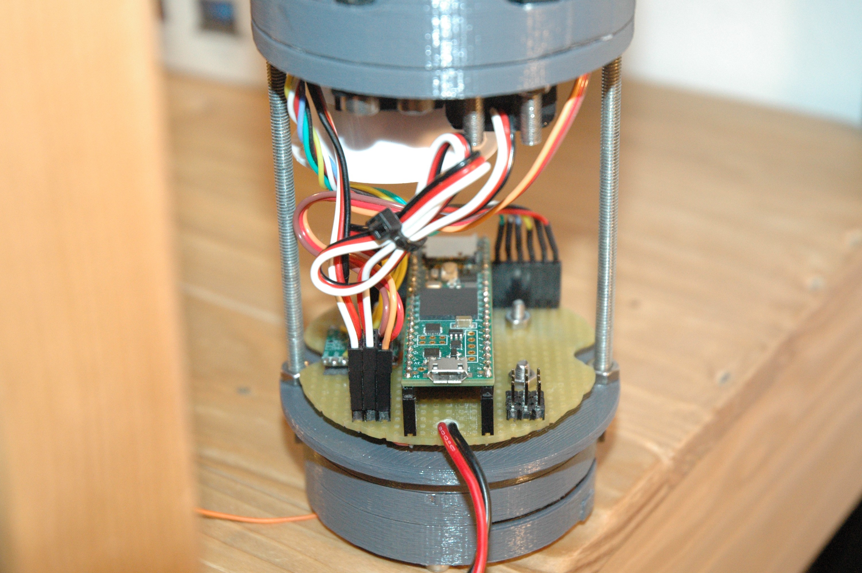

While developing this autopilot, R2Home has been slightly transformed in its shape to be able to make flights much more often. This other version includes a motor and allows to fly directly from the ground, but inside, exactly the same components are used.
            A : Motor  B : LiPo battery  C : Steering servos D : Onboard computer
             The main component of the on-board computer (C) is a Teensy 4.1
        PCB and schematics files are available on the GitHub and in the "files" tab!
The purpose of this on-board computer is to manage the entire system autonomously, so it takes care of the automatic deployment of the canopy at the right altitude, but also the autonomous steering of the canopy.
It also takes care of recording all the flight data at a different frequency depending on the flight mode (climb, descent, canopy flight etc.) as well as sending them at a lower frequency by telemetry (to save power) to the ground. It also contains several different power supply circuits, to avoid problems of conflict between the motors and the control electronics.

A : GPS module (SAM-M8Q)                              B : Steering servo
C : Onboard computer                                       D : RGB Led
E : "Remove Before Flight" Switch                     F : Wing attachement point
G : Deployment servo                                        H : Telemetry transmitter
I : LiPo battery                                                     J : Runcam Split 4
K : Deployment mechanism                               L : BMP280 Barometer
