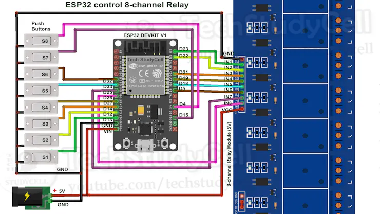

Circuit Diagram of the ESP32 Project:
This is the complete circuit diagram for this home automation project. I have explained the circuit in the tutorial video.
The circuit is very simple, I have used the GPIO pins D23, D22, D21, D19, D18, D5, D25 & D26 to control the 8 relays.
And the GPIO pins D13, D12, D14, D27, D33, D32, D15 & D4 connected with switches to control the 8 relays manually.
I have used the INPUT_PULLUP function in Arduino IDE instead of using the pull-up resistors.
I have used a 5V mobile charger to supply the smart relay module.

Control Relays Using Switches:
If the WiFi is not available, you can control the relays from the manual switches.
The ESP32 will check for the WiFi after every 3 seconds. When the WiFi is available, the ESP32 will automatically connect with the WiFi.
Please refer to the circuit diagram to connect the manual switches.

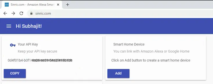

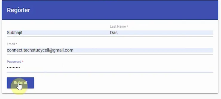

Create an Account in Sinric
First, visit https://sinric.com/login
Click on Register.
You have to create an account in Snric.
Then log in to Sinric Account.
You will get an API key which will be required in the code.

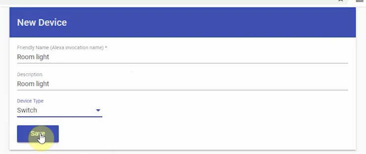

Now click on Add.
Add Devices in Sinric
Then enter a name for the device. Alexa will identify the device with that name.
Select the type as Switch.
Click on Save.
In this way add 8 devices in Sinric. Each device will get a unique device ID.

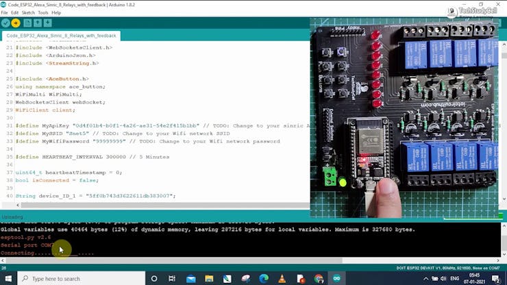

Program ESP32 Using Arduino IDE
First, you have to install the required libraries. I have shared all the links in the code.
Then enter the API key & WiFi credentials
#define MyApiKey "----------------"
#define MySSID "--------"
#define MyWifiPassword "------"
Then enter the device IDs for each device.
String device_ID_1 = "------------------------";
String device_ID_2 = "------------------------";
String device_ID_3 = "------------------------";
String device_ID_4 = "------------------------";
String device_ID_5 = "------------------------";
String device_ID_6 = "------------------------";
String device_ID_7 = "------------------------";
String device_ID_8 = "------------------------";
 After that select the DOIT ESP32 DEVKIT V1 board and the PORT. Then click on the upload button.
While uploading if you see the "Connecting.....___" text, press the BOOT button of ESP32.
