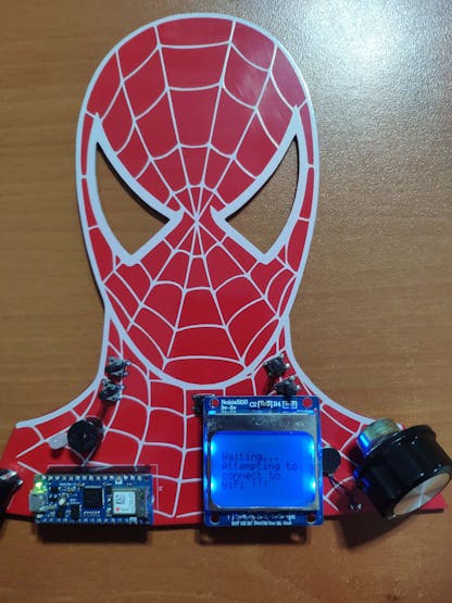

First of all, to obtain weekly comics release lists from the ShortBoxed comics API, I developed a web application in PHP running on Raspberry Pi.
Then, I used an Arduino Nano 33 IoT to get comics release lists transferred by the PHP web application and display them with a Nokia 5110 Screen.

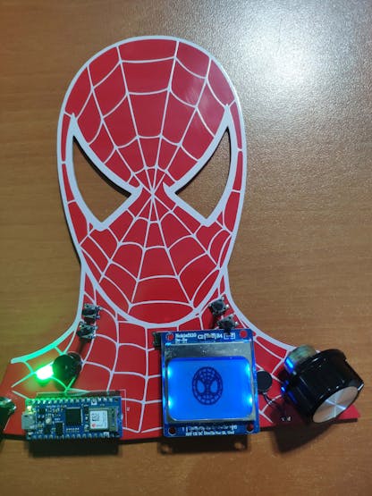

After completing wiring on a breadboard and testing the code, I designed a PCB (Comics Release List Tracker) inspired by one of my favorite comic book heroes: Spider-Man. It became a stylish and suitable addition to my comic book collection as an efficient new comics release list tracker with some spectacular features :)
The device shows the comics release list of:
Also, it has these unnecessary yet funny additional features 😃

Then, I designed the Comics Release List Tracker PCB by using KiCad. I attached the Gerber file of the PCB below, so if you want, you can order this PCB from PCBWay to create a stylish and fully-functional weekly new comics release list tracker inspired by Spider-Man :)
Click here to inspect and order this PCB directly on PCBWay.
First of all, by using a soldering iron, I attached headers (female), buzzer, potentiometer, vibration motor, 5mm common cathode RGB LED, 6x6 pushbuttons, 1K resistors, and the power jack.
Component list on the PCB:
A1 (Headers for Arduino Nano 33 IoT)
S1 (Headers for Nokia 5110 Screen)
BZ1 (Buzzer)
RV1 (Potentiometer)
V1 (Vibration Motor)
D1 (5mm Common Cathode RGB LED)
K1, K2, K3, K4, K5 (6x6 Pushbutton)
R1, R2, R3, R4, R5 (1K Resistor)
J1 (Power Jack)

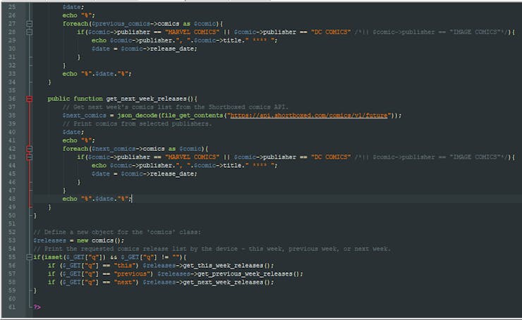

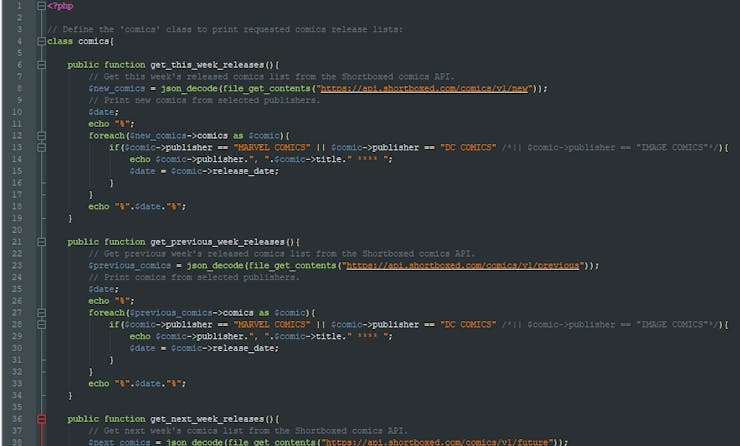

The web application consists of one file - index.php. You can download the web application below to install it on your Raspberry Pi - New_Comics_Releases.zip.
💻 index.php
⭐ Define the 'comics' class to print requested comics release lists.
⭐ In the get_this_week_releases() function:
⭐ Get this week's released comics list from the ShortBoxed comics API by using the json_decode() and file_get_contents() functions.
⭐ Print new comics from selected publishers - Marvel Comics and DC Comics.
⭐ Syntax:
%publisher, title ****...%date%
public function get_this_week_releases(){		// Get this week's released comics list from the Shortboxed comics API.		$new_comics = json_decode(file_get_contents("https://api.shortboxed.com/comics/v1/new"));		// Print new comics from selected publishers.		$date;		echo "%";		foreach($new_comics->comics as $comic){			if($comic->publisher == "MARVEL COMICS" || $comic->publisher == "DC COMICS" /*|| $comic->publisher == "IMAGE COMICS"*/){				echo $comic->publisher.", ".$comic->title." **** ";					$date = $comic->release_date;			}		}		echo "%".$date."%";	}
⭐ In the get_next_week_releases() function:
⭐ Get next week's comics list from the ShortBoxed comics API by using the json_decode() and file_get_contents() functions.
⭐ Print comics from selected publishers - Marvel Comics and DC Comics.
⭐ Syntax:
public function get_next_week_releases(){		// Get next week's comics list from the Shortboxed comics API.		$next_comics = json_decode(file_get_contents("https://api.shortboxed.com/comics/v1/future"));		// Print comics from selected publishers.		$date;		echo "%";		foreach($next_comics->comics as $comic){			if($comic->publisher == "MARVEL COMICS" || $comic->publisher == "DC COMICS" /*|| $comic->publisher == "IMAGE COMICS"*/){				echo $comic->publisher.", ".$comic->title." **** ";					$date = $comic->release_date;			}		}		echo "%".$date."%";	}
⭐ In the get_previous_week_releases() function:
⭐ Get previous week's released comics list from the ShortBoxed comics API by using the json_decode() and file_get_contents() functions.
⭐ Syntax:
public function get_previous_week_releases(){		// Get previous week's released comics list from the Shortboxed comics API.		$previous_comics = json_decode(file_get_contents("https://api.shortboxed.com/comics/v1/previous"));		// Print comics from selected publishers.		$date;		echo "%";		foreach($previous_comics->comics as $comic){			if($comic->publisher == "MARVEL COMICS" || $comic->publisher == "DC COMICS" /*|| $comic->publisher == "IMAGE COMICS"*/){				echo $comic->publisher.", ".$comic->title." **** ";					$date = $comic->release_date;			}		}		echo "%".$date."%";	}
⭐ Define a new object for the 'comics' class - releases.
⭐ Print the requested comics release list by the device via a Get request - this week, previous week, or next week.
$releases = new comics();// Print the requested comics release list by the device - this week, previous week, or next week.if(isset($_GET["q"]) && $_GET["q"] != ""){    if ($_GET["q"] == "this") $releases->get_this_week_releases();    if ($_GET["q"] == "previous") $releases->get_previous_week_releases();    if ($_GET["q"] == "next") $releases->get_next_week_releases();}

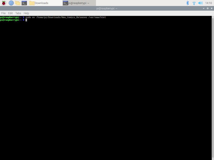

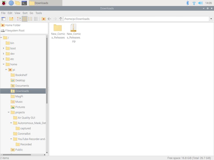

⭐ First of all, extract the New_Comics_Releases.zip folder and move the application folder (New_Comics_Releases) to the apache server (/var/www/html) by using the terminal since the apache server is a protected location.
sudo mv /home/pi/Downloads/New_Comics_Releases /var/www/html/

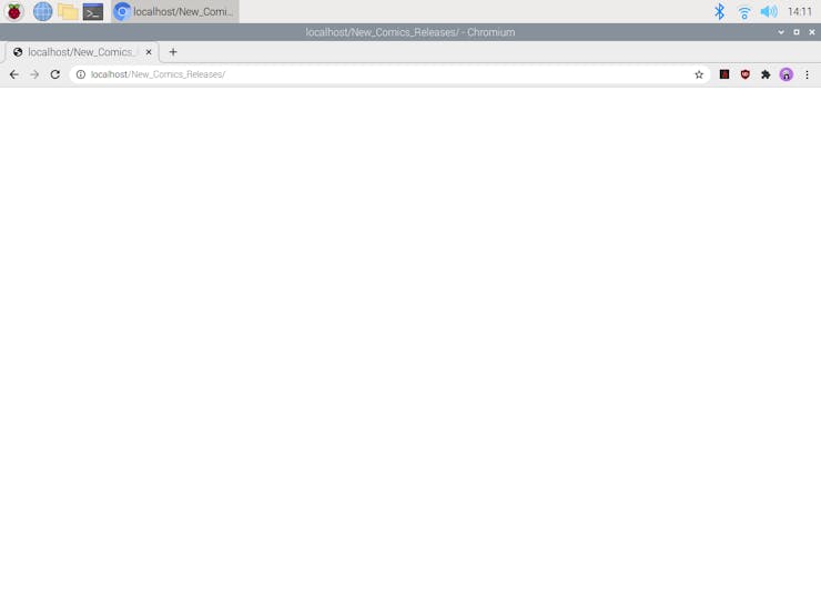

⭐ Go to the web application:
http://localhost/New_Comics_Releases/

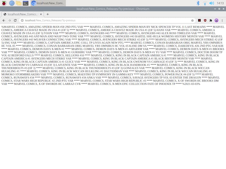

⭐ To test whether the web application obtains requested comics release lists successfully - this week, next week, and previous week:
http://localhost/New_Comics_Releases/?q=this
http://localhost/New_Comics_Releases/?q=next
http://localhost/New_Comics_Releases/?q=previous

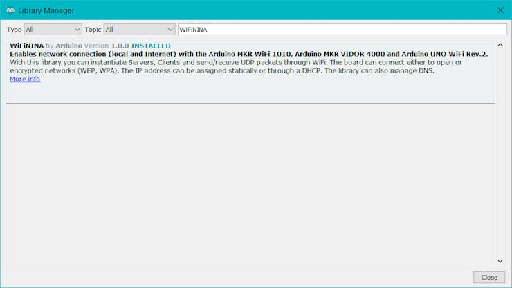

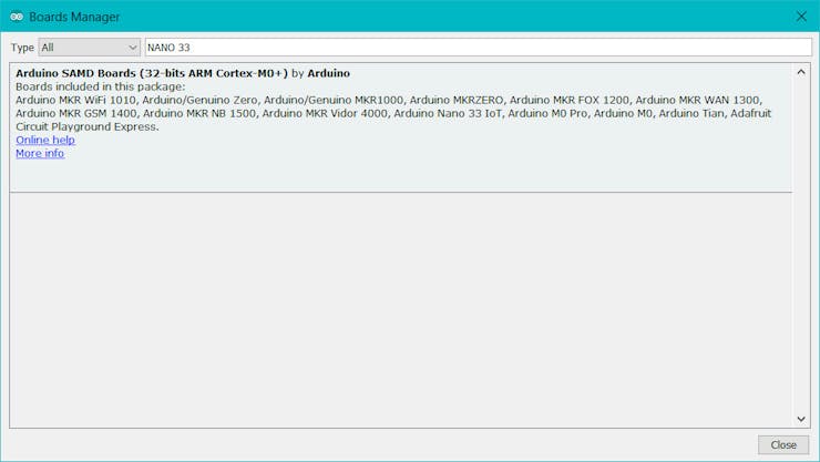

Step 4: Setting up the Arduino Nano 33 IoT
If you are a novice in programming with the Arduino Nano 33 IoT, follow the steps below to program it with the Arduino IDE.
⭐ Download the required drivers - Arduino SAMD Core - as explained here.
⭐ To be able to connect to the WiFi, download the WiFiNINA library from here.

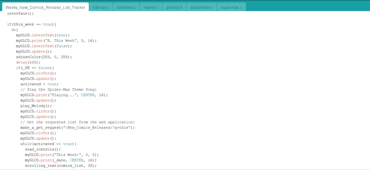

void change_menu_options(){  // Increase or decrease the option number using Up and Down buttons.  if(_up == false) { selected++; digitalWrite(vib_motor, HIGH); }  if(_down == false) { selected--; digitalWrite(vib_motor, HIGH); }  if(selected < 0) selected = 4;  if(selected > 4) selected = 1;  delay(100);  digitalWrite(vib_motor, LOW);  // Depending on the selected option number, change boolean status.  switch(selected){    case 1:      this_week = true;      next_week = false;      previous_week = false;      graphics = false;    break;    case 2:           this_week = false;      next_week = true;      previous_week = false;      graphics = false;    break;    case 3:      this_week = false;      next_week = false;      previous_week = true;      graphics = false;    break;    case 4:      this_week = false;      next_week = false;      previous_week = false;      graphics = true;    break;  }}
⭐ After selected, if this_weeknext_week, or previous_week menu option is activated by pressing the OK button:
⭐ Play the Spider-Man theme song (1967) with the buzzer.
⭐ Get the requested list from the web application - this week, next week, or the previous week.
⭐ Print the obtained comics release list and release date.
⭐ Scroll the fetched comics release list by using the Right and Left buttons.
⭐ If the Up or Down button is pressed, exit and return to the interface.
if(this_week == true){    do{      myGLCD.invertText(true);      myGLCD.print("A. This Week", 0, 16);      myGLCD.invertText(false);      myGLCD.update();      adjustColor(255, 0, 255);      delay(100);      if(_OK == false){        myGLCD.clrScr();        myGLCD.update();        activated = true;        // Play the Spider-Man Theme Song:        myGLCD.print("Playing...", CENTER, 16);        myGLCD.update();        play_Melody();        myGLCD.clrScr();        myGLCD.update();        // Get the requested list from the web application:        make_a_get_request("/New_Comics_Releases/?q=this");        myGLCD.clrScr();        myGLCD.update();        while(activated == true){          read_controls();          myGLCD.print("This Week:", 0, 0);          myGLCD.print(_date, CENTER, 16);          scrolling_text(comics_list, 32);          // Exit.          if(_up == false || _down == false){ activated = false; x = 0; _date = ""; comics_list = ""; myGLCD.clrScr(); myGLCD.update(); }                 }      }    }while(this_week == false);  }    ...

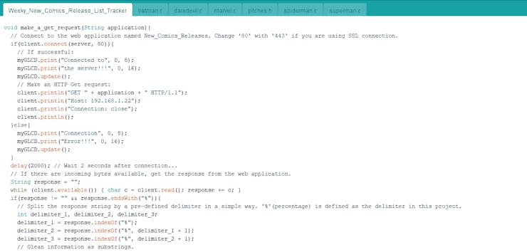

⭐ In the make_a_get_request() function:
⭐ Connect to the web application named New Comics Releases.
⭐ If the connection is successful, make a Get request to obtain weekly comics release lists of this week, next week, or the previous week.
⭐ If there are incoming bytes available, get the response from the web application.
⭐ Split the response string by the predefined delimiter (%) to glean information as substrings - comics_list and _date.
void make_a_get_request(String application){  // Connect to the web application named New_Comics_Releases. Change '80' with '443' if you are using SSL connection.  if(client.connect(server, 80)){    // If successful:    myGLCD.print("Connected to", 0, 8);    myGLCD.print("the server!!!", 0, 16);    myGLCD.update();    // Make an HTTP Get request:    client.println("GET " + application + " HTTP/1.1");    client.println("Host: 192.168.1.22");    client.println("Connection: close");    client.println();  }else{    myGLCD.print("Connection", 0, 8);    myGLCD.print("Error!!!", 0, 16);    myGLCD.update();  }  delay(2000); // Wait 2 seconds after connection...  // If there are incoming bytes available, get the response from the web application.  String response = "";  while (client.available()) { char c = client.read(); response += c; }  if(response != "" && response.endsWith("%")){    // Split the response string by a pre-defined delimiter in a simple way. '%'(percentage) is defined as the delimiter in this project.    int delimiter_1, delimiter_2, delimiter_3;    delimiter_1 = response.indexOf("%");    delimiter_2 = response.indexOf("%", delimiter_1 + 1);    delimiter_3 = response.indexOf("%", delimiter_2 + 1);    // Glean information as substrings.    comics_list = response.substring(delimiter_1 + 1, delimiter_2);    _date = response.substring(delimiter_2 + 1, delimiter_3);  }}

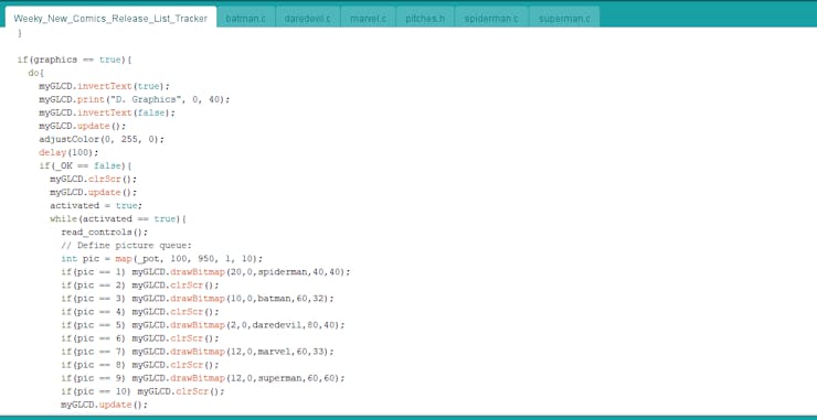

⭐ After selected, if the graphics menu option is activated by pressing the OK button:
⭐ Using the map() function, define a graphics (monochrome images) queue displayed depending on the potentiometer value - from 1 to 10.
if(graphics == true){    do{      myGLCD.invertText(true);      myGLCD.print("D. Graphics", 0, 40);      myGLCD.invertText(false);      myGLCD.update();      adjustColor(0, 255, 0);      delay(100);      if(_OK == false){        myGLCD.clrScr();        myGLCD.update();        activated = true;        while(activated == true){          read_controls();          // Define picture queue:          int pic = map(_pot, 100, 950, 1, 10);          if(pic == 1) myGLCD.drawBitmap(20,0,spiderman,40,40);          if(pic == 2) myGLCD.clrScr();          if(pic == 3) myGLCD.drawBitmap(10,0,batman,60,32);          if(pic == 4) myGLCD.clrScr();          if(pic == 5) myGLCD.drawBitmap(2,0,daredevil,80,40);          if(pic == 6) myGLCD.clrScr();          if(pic == 7) myGLCD.drawBitmap(12,0,marvel,60,33);          if(pic == 8) myGLCD.clrScr();          if(pic == 9) myGLCD.drawBitmap(12,0,superman,60,60);          if(pic == 10) myGLCD.clrScr();          myGLCD.update();          // Exit.          if(_up == false || _down == false){ activated = false; myGLCD.clrScr(); myGLCD.update(); }         }      }    }while(graphics == false);  }

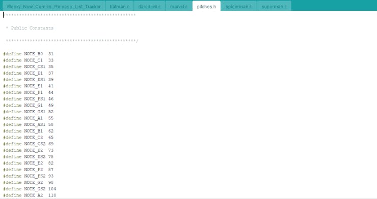

I used an extra file named pitches.h. This file contains all the pitch values for typical notes. For example, NOTE_C4 is middle C. NOTE_FS4 is F sharp, and so forth.
#define NOTE_B0  31#define NOTE_C1  33#define NOTE_CS1 35#define NOTE_D1  37#define NOTE_DS1 39#define NOTE_E1  41#define NOTE_F1  44#define NOTE_FS1 46#define NOTE_G1  49#define NOTE_GS1 52#define NOTE_A1  55#define NOTE_AS1 58#define NOTE_B1  62#define NOTE_C2  65#define NOTE_CS2 69#define NOTE_D2  73#define NOTE_DS2 78#define NOTE_E2  82#define NOTE_F2  87#define NOTE_FS2 93#define NOTE_G2  98#define NOTE_GS2 104...
To play the Spider-Man theme song (1967) with a buzzer using the tone() function, I elicited its notes and durations from here.

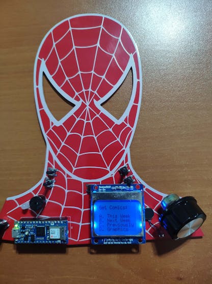

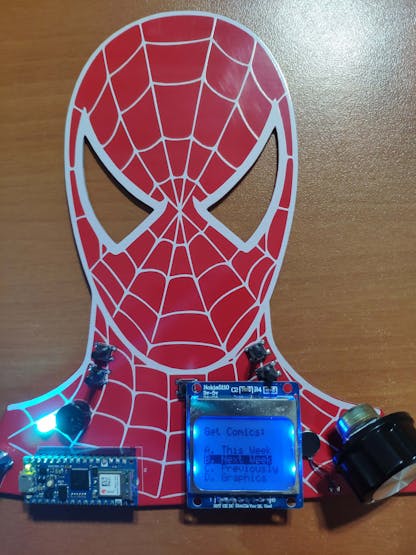

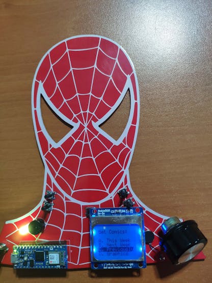

After completing and uploading the code, I attached all required components to the board via headers - the Arduino Nano 33 IoT, the Nokia 5110 Screen, and the potentiometer knob.
Modes and Features
🕷🕸 First of all, the device checks for a successful WiFi connection. Then, if connected, it displays the interface (menu).
🕷🕸 The device shows four different modes on the interface:
  • A. This Week
  • B. Next Week
  • C. Previously
  • D. Graphics
🕷🕸 The device allows the user to select a mode (option) on the interface via the control buttons:
  • Up ➡ Go Up
  • Down ➡ Go Down
  • OK ➡ Activate
🕷🕸 While selecting a mode on the interface with the Up and Down buttons, the device turns the RGB LED to a different color for each mode and activates the vibration motor to notify the user.
  • This Week ➡ Purple
  • Next Week ➡ Cyan
  • Previously ➡ Yellow
  • Graphics ➡ Green
🕷🕸 After activating any modes, the device lets the user return to the interface by pressing the Up or Down button.
📌 A. This Week
🕷🕸 The device plays the Spider-Man theme song (1967).
🕷🕸 The device connects to the web application (New Comics Releases) to retrieve and query this week's comics release list.
🕷🕸 The device displays the fetched comics release list and date, including these publishers:
  • Marvel Comics
  • DC Comics
  • Image Comics (optional)
🕷🕸 The device allows the user to scroll the obtained comics release list by using the Right and Left buttons.
📌 B. Next Week
🕷🕸 The device connects to the web application (New Comics Releases) to retrieve and query next week's comics release list.
  • Marvel Comics
  • DC Comics
📌 C. Previously
🕷🕸 The device connects to the web application (New Comics Releases) to retrieve and query the previous week's comics release list.
  • Marvel Comics
  • DC Comics
📌 D. Graphics
🕷🕸 The device lets the user show different graphics (monochrome images) by adjusting the potentiometer value from 1 to 10 :)
