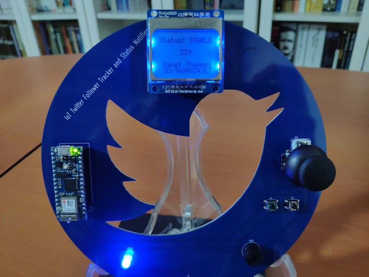

First of all, to manage to glean information from Twitter by avoiding any authentification process pertaining to the Twitter API, I chose to use a content delivery network (CDN) - cdn.syndication.twimg - to obtain the number of followers of a selected Twitter account by its screen name. When I managed to get information from Twitter, I programmed a web application in PHP, named Twitter Follower Tracker, running on Raspberry Pi to print a data packet containing:
Then, I used an Arduino Nano 33 IoT to get my Twitter account information and follower count transferred by the PHP web application and display them with a Nokia 5110 Screen.
Finally, I added a COM-09032 analog joystick and two buttons to control the menu options and scroll text.
After completing wiring on a breadboard and testing the code, I designed a PCB (Twitter Follower Tracker) having the Twitter logo carved at its center. It became a stylish and fitting addition to my desk as an efficient apparatus to track the follower count of my account :)
In addition to displaying information, the device:
Huge thanks to PCBWay for sponsoring this project.

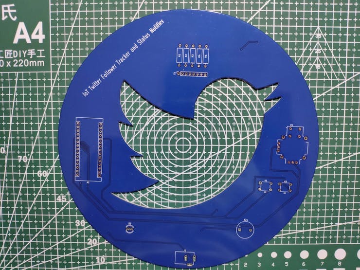

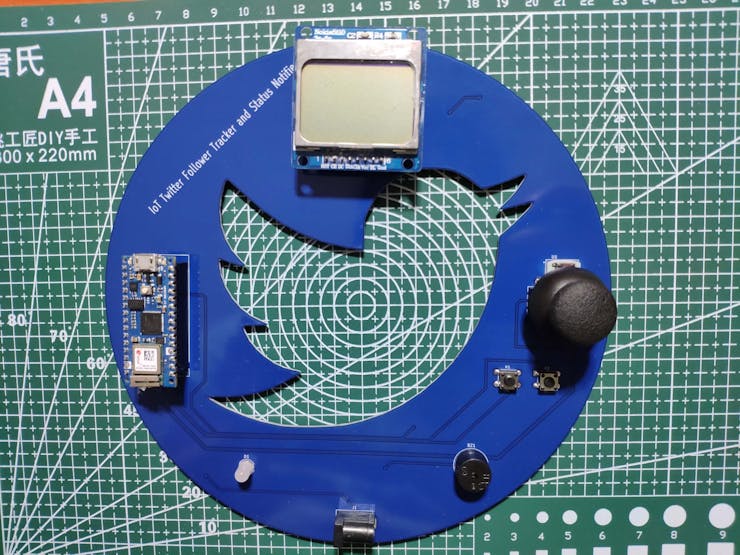

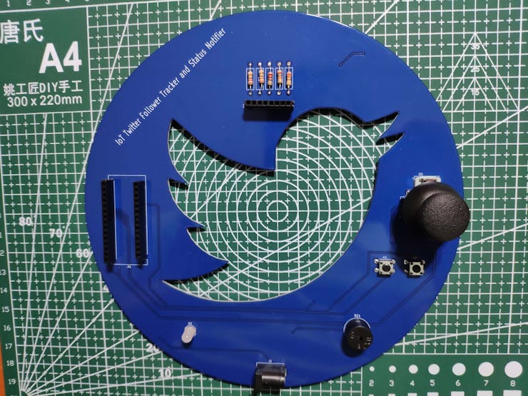

Step 1: Designing and soldering the Twitter Follower Tracker PCB
Before prototyping my PCB design, I tested all connections and wiring with the Arduino Nano 33 IoT on the breadboard.
Then, I designed the Twitter Follower Tracker and Status Notifier PCB by using KiCad. I attached the Gerber file of the PCB below, so if you want, you can order this PCB from PCBWay to create a stylish and fitting apparatus to display the follower count of a selected account and get notified when there is a change, inspired by the Twitter logo :)
Click here to inspect and order this PCB directly on PCBWay.

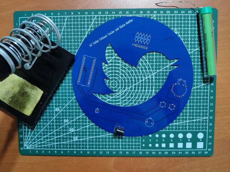

First of all, by using a soldering iron, I attached headers (female), COM-09032 analog joystick, buzzer, 5mm common cathode RGB LED, 6x6 pushbuttons, 1K resistors, and the power jack.
Component list on the PCB:
A1 (Headers for Arduino Nano 33 IoT)
S1 (Headers for Nokia 5110 Screen)
U1 (COM-09032 Analog Joystick)
BZ1 (Buzzer)
D1 (5mm Common Cathode RGB LED)
K1, K2 (6x6 Pushbutton)
R1, R2, R3, R4, R5 (1K Resistor)
J1 (Power Jack)

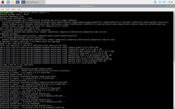

⭐ Open a terminal window by selecting Accessories > Terminal from the menu.
⭐ Install the apache2 package by typing the following command into the terminal and pressing Enter:
sudo apt-get install apache2 -y
⭐ To test the server, open Chromium by selecting Internet > Chromium Web Browser from the menu and enter http://localhost.
⭐ If you want, you can use the IP address of your Raspberry Pi as well.
hostname -I

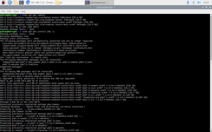

⭐ Install the PHP package with the following command:
⭐ Do not forget to update the Pi.
sudo apt-get update
sudo apt-get install php -y
⭐ To be able to obtain information from the cdn.syndication.twimg (CDN), install the php-curl package:
sudo apt-get install php-curl
⭐ Then, restart the apache server to be able to use the installed packages on the localhost:
sudo service apache2 restart

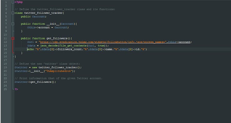

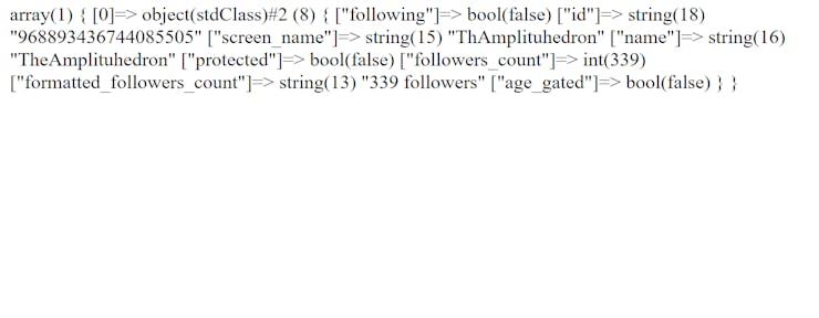

Step 3: Developing the Twitter Follower Tracker web application in PHP to elicit information from the CDN
Although Twitter provides an API to collate information on Twitter accounts, tweets, replies, etc., I decided to use a content delivery network (CDN) in this project since the Twitter API requires an authentification process and key.
CDN: cdn.syndication.twimg
⭐ CDN uses screen names of Twitter accounts to collect and return this information in JSON:
https://cdn.syndication.twimg.com/widgets/followbutton/info.json?screen_names=
The web application consists of one file - index.php. You can download the web application below to install it on your Raspberry Pi - Twitter_Follower_Tracker.zip.
💻 index.php
⭐ Define the twitter_follower_tracker class and its functions.
⭐ In the __init__ function, define the screen name of the Twitter account, such as ThAmplituhedron.
⭐ In the get_followers function, print information of the given Twitter account.
⭐ Syntax:
#/em>
#/em>
⭐ Define the twitter class object.
// Define the twitter_follower_tracker class and its functions:class twitter_follower_tracker{    public $account;        public function __init__($account){        $this->account = $account;    }        public function get_followers(){        $url = "https://cdn.syndication.twimg.com/widgets/followbutton/info.json?screen_names=".$this->account;        $data = json_decode(file_get_contents($url, true));        echo "%".$data[0]->followers_count."%".$data[0]->name."%".$data[0]->id."%";    }}// Define the new 'twitter' class object:$twitter = new twitter_follower_tracker();$twitter->__init__("ThAmplituhedron");// Print information that of the given Twitter account.$twitter->get_followers();

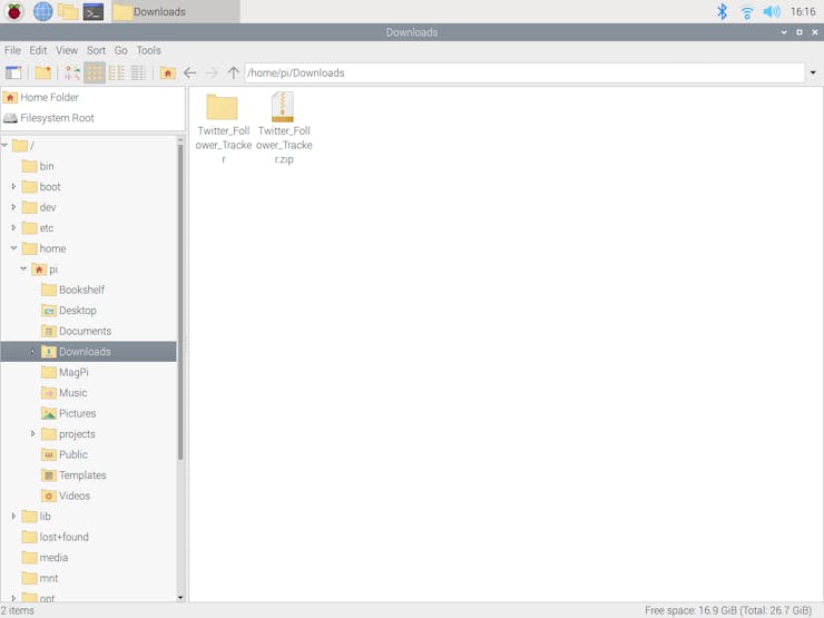

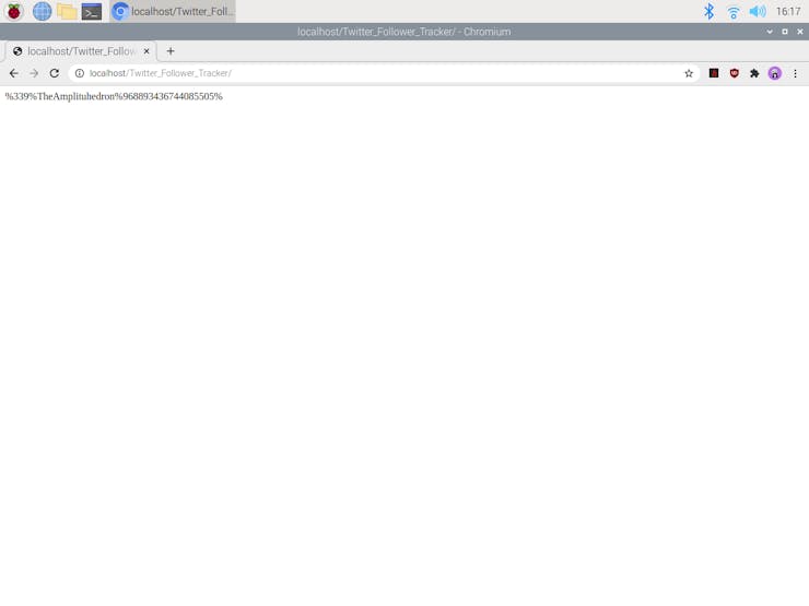

Step 3.1: Setting up the web application on Raspberry Pi
⭐ First of all, extract the Twitter_Follower_Tracker.zip folder and move the application folder (Twitter_Follower_Tracker) to the apache server (/var/www/html) by using the terminal since the apache server is a protected location.
sudo mv /home/pi/Downloads/Twitter_Follower_Tracker /var/www/html/
⭐ Go to the web application:
http://localhost/Twitter_Follower_Tracker/

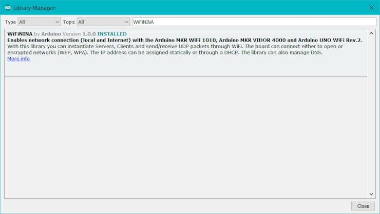

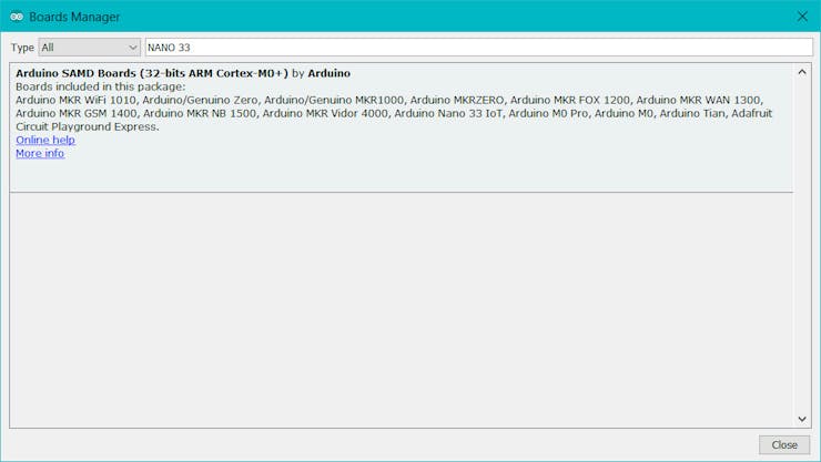

Step 4: Setting up the Arduino Nano 33 IoT
If you are a novice in programming with the Arduino Nano 33 IoT, follow the steps below to program it with the Arduino IDE.
⭐ Download the required drivers - Arduino SAMD Core - as explained here
⭐ To be able to connect to the WiFi, download the WiFiNINA library from here.

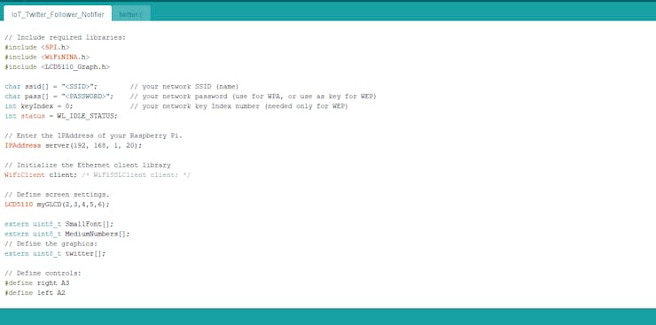

Download the required libraries to be able to control the modules:
Nokia 5110 Screen | Library

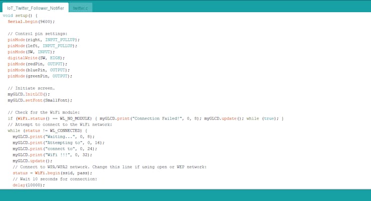

⭐ Include required libraries and define the WiFi settings.
// Include required libraries:#include <SPI.h>#include <WiFiNINA.h>#include <LCD5110_Graph.h>char ssid[] = "<SSID>";        // your network SSID (name)char pass[] = "<PASSWORD>";    // your network password (use for WPA, or use as key for WEP)int keyIndex = 0;              // your network key Index number (needed only for WEP)int status = WL_IDLE_STATUS;// Enter the IPAddress of your Raspberry Pi.IPAddress server(192, 168, 1, 20);// Initialize the Ethernet client libraryWiFiClient client; /* WiFiSSLClient client; */
⭐ Define the Nokia 5110 screen settings and the graphics (monochrome images).
⭐ To create different graphics (monochrome images), go to Monochrome Image Converter.
// Define screen settings.LCD5110 myGLCD(2,3,4,5,6);extern uint8_t SmallFont[];extern uint8_t MediumNumbers[];// Define the graphics:extern uint8_t twitter[];
⭐ Initiate the screen and check for the WiFi module to verify the connection.
// Initiate screen.  myGLCD.InitLCD();  myGLCD.setFont(SmallFont);  // Check for the WiFi module:  if (WiFi.status() == WL_NO_MODULE) { myGLCD.print("Connection Failed!", 0, 8); myGLCD.update(); while (true); }  // Attempt to connect to the WiFi network:  while (status != WL_CONNECTED) {    myGLCD.print("Waiting...", 0, 8);    myGLCD.print("Attempting to", 0, 16);    myGLCD.print("connect to", 0, 24);    myGLCD.print("WiFi !!!", 0, 32);    myGLCD.update();    // Connect to WPA/WPA2 network. Change this line if using open or WEP network:    status = WiFi.begin(ssid, pass);    // Wait 10 seconds for connection:    delay(10000);  }

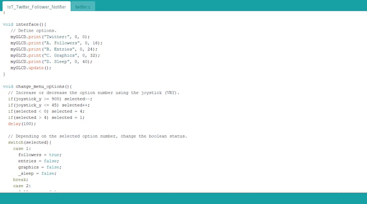

⭐ In the read_controls function, read joystick and control button values.
void read_controls(){  // Joystick:  joystick_x = analogRead(VRX);  joystick_y = analogRead(VRY);  joystick_sw = digitalRead(SW);  // Buttons:  _right = digitalRead(right);  _left = digitalRead(left);}
⭐ In the change_menu_options function:
⭐ Increase or decrease the menu option number (selected) using the Y-axis of the analog joystick.
⭐ Depending on the menu option number (selected), change the boolean status.
void change_menu_options(){  // Increase or decrease the option number using the joystick (VRY).  if(joystick_y >= 900) selected--;   if(joystick_y <= 45) selected++;   if(selected < 0) selected = 4;  if(selected > 4) selected = 1;  delay(100);  // Depending on the selected option number, change the boolean status.  switch(selected){    case 1:      followers = true;      entries = false;      graphics = false;      _sleep = false;    break;    case 2:           followers = false;      entries = true;      graphics = false;      _sleep = false;    break;    case 3:      followers = false;      entries = false;      graphics = true;      _sleep = false;    break;    case 4:      followers = false;      entries = false;      graphics = false;      _sleep = true;    break;  }}

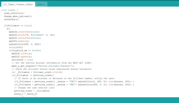

⭐ After being selected, if the followers menu option is activated by pressing the joystick button (SW):
⭐ Get the Twitter account information from the REST API (CDN).
⭐ Check the current follower status using registered status variables:
⭐ If there is an increase or decrease in the follower count, notify the user.
⭐ Update the last entries (follower counts) list.
⭐ Print the Twitter account information and status.
⭐ Scroll the fetched information by using the X-axis of the analog joystick.
⭐ If the Left button is pressed, halt notification (buzzer).
⭐ If the Right button is pressed, return to the interface.
if(followers == true){    do{      myGLCD.invertText(true);      myGLCD.print("A. Followers", 0, 16);      myGLCD.invertText(false);      myGLCD.update();      adjustColor(255, 0, 255);      delay(100);      if(joystick_sw == false){        myGLCD.clrScr();        myGLCD.update();        activated = true;        // Get the Twitter Account Information from the REST API (CDN):        make_a_get_request("/Twitter_Follower_Tracker/");        // Check the follower status using registered status variables:        int _followers = follower_count.toInt();        if(_followers != previous_count){          // If there is an increase or decrease in the follower number, notify the user:          if(_followers > previous_count){ _status = "INC"; adjustColor(0, 255, 0); tone(buzzer, 500); }          if(_followers < previous_count){ _status = "DEC"; adjustColor(255, 0, 0); tone(buzzer, 500); }          // Change the last entries list:          previous_count = _followers;          entry_3 = entry_2;          entry_2 = entry_1;          entry_1 = _followers;        }else{          _status = "STABLE";          adjustColor(0, 0, 255);        }        myGLCD.clrScr();        myGLCD.update();        while(activated == true){          read_controls();          myGLCD.print("Status: " + _status, 0, 0);          myGLCD.print(follower_count, CENTER, 16);          scrolling_text(" Name: " + account_name + " ", 32);          scrolling_text(" ID:" + account_id + " ", 40);          // Halt notification.          if(_left == false) noTone(buzzer);          // Exit.          if(_right == false){ activated = false; x = 0; myGLCD.clrScr(); myGLCD.update(); noTone(buzzer); }                 }      }    }while(followers == false);  }

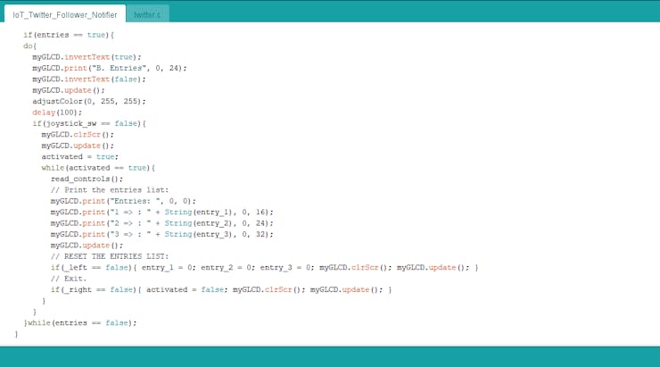

⭐ After being selected, if the entries menu option is activated by pressing the joystick button (SW):
⭐ Print the registered entries list - last three follower counts.
⭐ If the Left button is pressed, reset the entries list.
if(entries == true){    do{      myGLCD.invertText(true);      myGLCD.print("B. Entries", 0, 24);      myGLCD.invertText(false);      myGLCD.update();      adjustColor(0, 255, 255);      delay(100);      if(joystick_sw == false){        myGLCD.clrScr();        myGLCD.update();        activated = true;        while(activated == true){          read_controls();          // Print the entries list:          myGLCD.print("Entries: ", 0, 0);          myGLCD.print("1 => : " + String(entry_1), 0, 16);          myGLCD.print("2 => : " + String(entry_2), 0, 24);          myGLCD.print("3 => : " + String(entry_3), 0, 32);          myGLCD.update();          // RESET THE ENTRIES LIST:          if(_left == false){ entry_1 = 0; entry_2 = 0; entry_3 = 0; myGLCD.clrScr(); myGLCD.update(); }          // Exit.          if(_right == false){ activated = false; myGLCD.clrScr(); myGLCD.update(); }                 }      }    }while(entries == false);  }

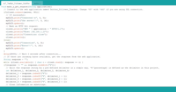

Step 5.1: Getting information from the web application and using the analog joystick to scroll text
⭐ In the make_a_get_request function:
⭐ Connect to the web application named Twitter Follower Tracker.
⭐ If the connection is successful, make a Get request to obtain the Twitter account information:
⭐ If there are incoming bytes available, get the response from the web application.
⭐ Split the response string by the predefined delimiter (%) to glean information as substrings - follower_countaccount_name, and account_id.
void make_a_get_request(String application){  // Connect to the web application named Twitter_Follower_Tracker. Change '80' with '443' if you are using SSL connection.  if(client.connect(server, 80)){    // If successful:    myGLCD.print("Connected to", 0, 8);    myGLCD.print("the server!!!", 0, 16);    myGLCD.update();    // Make an HTTP Get request:    client.println("GET " + application + " HTTP/1.1");    client.println("Host: 192.168.1.20");    client.println("Connection: close");    client.println();  }else{    myGLCD.print("Connection", 0, 8);    myGLCD.print("Error!!!", 0, 16);    myGLCD.update();  }  delay(2000); // Wait 2 seconds after connection...  // If there are incoming bytes available, get the response from the web application.  String response = "";  while (client.available()) { char c = client.read(); response += c; }  if(response != "" && response.endsWith("%")){    // Split the response string by a pre-defined delimiter in a simple way. '%'(percentage) is defined as the delimiter in this project.    int delimiter_1, delimiter_2, delimiter_3, delimiter_4;    delimiter_1 = response.indexOf("%");    delimiter_2 = response.indexOf("%", delimiter_1 + 1);    delimiter_3 = response.indexOf("%", delimiter_2 + 1);    delimiter_4 = response.indexOf("%", delimiter_3 + 1);    // Glean information as substrings.    follower_count = response.substring(delimiter_1 + 1, delimiter_2);    account_name = response.substring(delimiter_2 + 1, delimiter_3);    account_id = response.substring(delimiter_3 + 1, delimiter_4);  }}
⭐ In the scrolling_text function:
⭐ Scroll a given string using the X-axis of the analog joystick on a given y coordinate (row).
void scrolling_text(String text, int y){  int len = text.length();  // Scroll text using the joystick (VRX).  if(joystick_x <= 45) x--;  if(joystick_x >= 900) x++;  if(x>84) x = 84;  if(x<=-(len*6)) x = -(len*6);  // Print.  myGLCD.print(text, x, y);  myGLCD.update();  delay(25);}

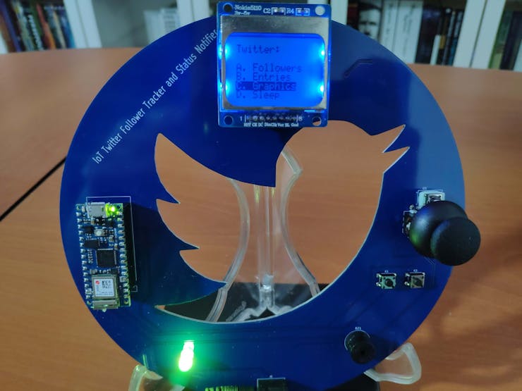

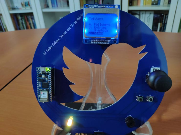

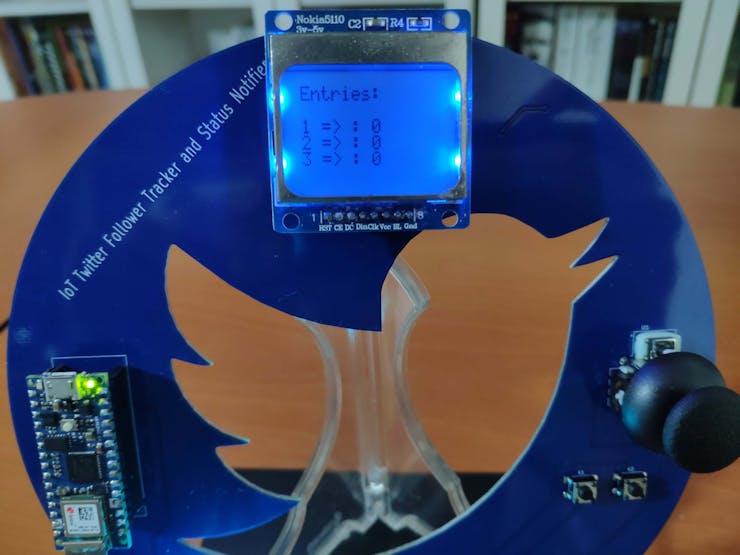

After completing and uploading the code, I attached all required components to the board via headers - the Arduino Nano 33 IoT and the Nokia 5110 Screen.
Modes and Features

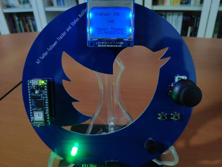

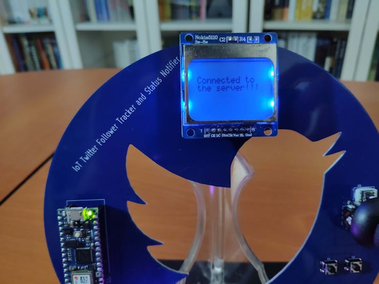

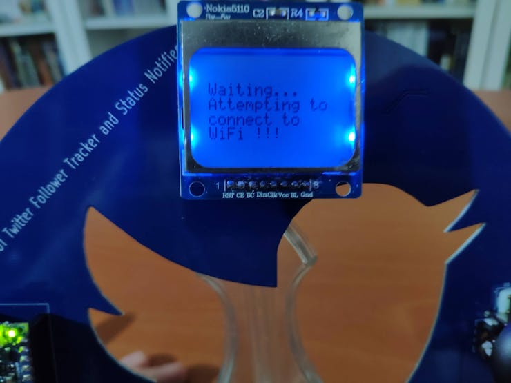

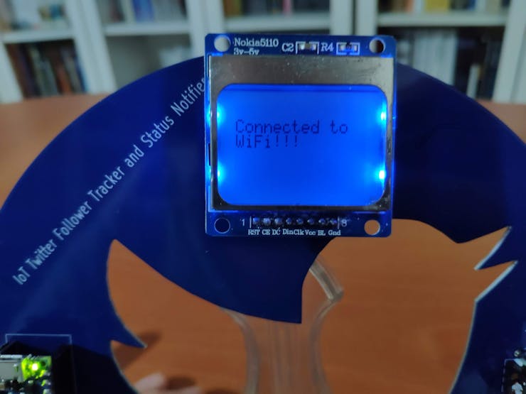

📊🔄 First of all, the device checks for a successful WiFi connection. Then, if connected, it displays the interface (menu).
📊🔄 The device shows four different modes on the interface:
📊🔄 The device allows the user to select a mode (option) on the interface via the analog joystick:
📊🔄 While selecting a mode on the interface with the Y-axis of the analog joystick, the device turns the RGB LED to a different color for each mode:
📊🔄 After activating any modes, the device lets the user return to the interface by pressing the Right button.

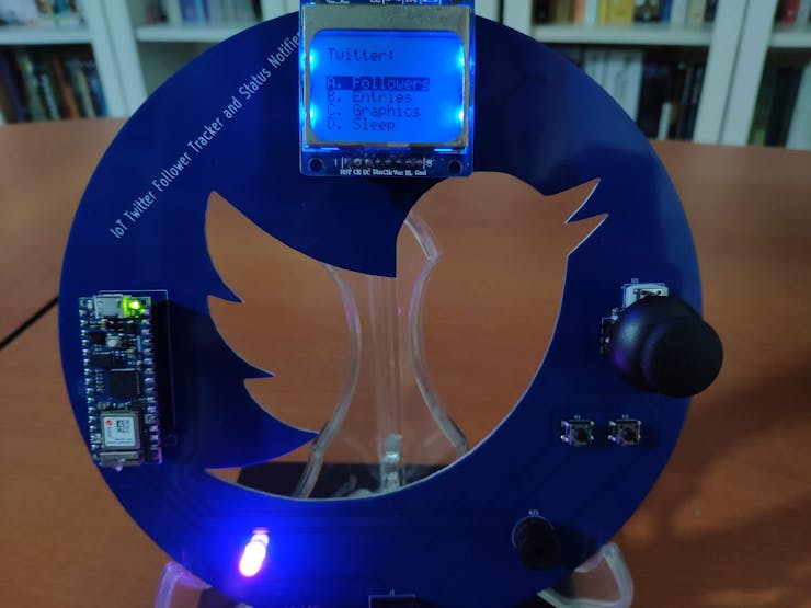

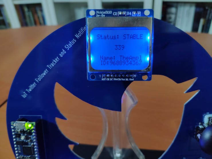

📌 A. Followers
📊🔄 The device connects to the web application (Twitter Follower Tracker) to obtain the Twitter account information:
📊🔄 The device checks the current follower status in comparison to the previously registered follower count:
📊🔄 Then, the device displays the current follower status, the current follower count, the account name, and the account ID.
📊🔄 If the current follower status is STABLE, which means no change in the follower count, the device turns the RGB LED to blue.
📊🔄 If the current follower status is INC, which means an increase in the follower count, the device turns the RGB LED to green and notifies the user via the buzzer.
📊🔄 If the current follower status is DEC, which means a decrease in the follower count, the device turns the RGB LED to red and notifies the user via the buzzer.
📊🔄 If the Left button is pressed, the device halts the buzzer (notification) and keeps displaying the account information.
📊🔄 The device allows the user to scroll the fetched account information with the X-axis of the analog joystick.

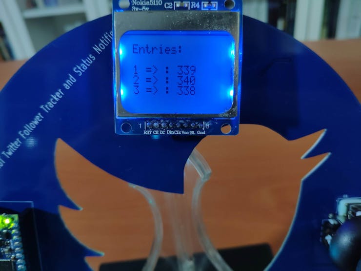

📌 B. Entries
📊🔄 The device displays the last three registered follower counts (entries) chronologically.
📊🔄 If the Left button is pressed, the device resets the entries (follower counts) list.

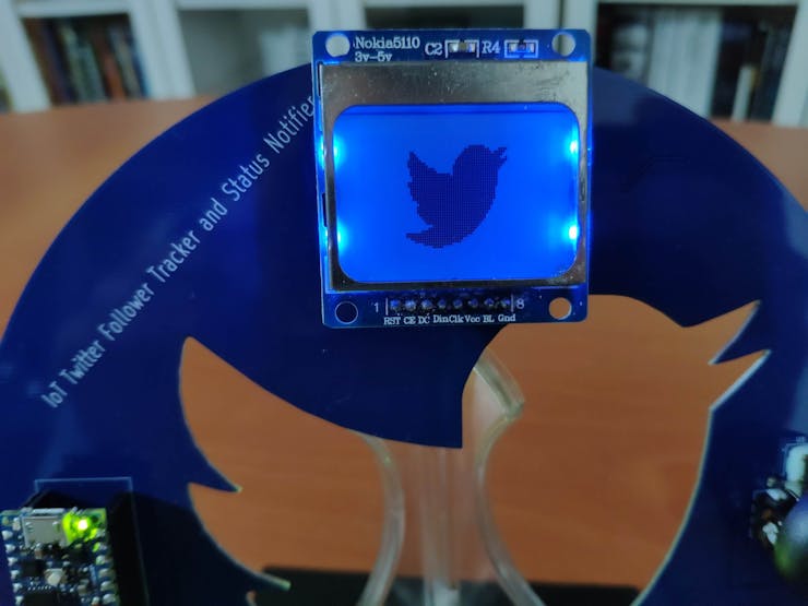

📌 C. Graphics
📊🔄 The device shows the Twitter logo (monochrome image) as the screensaver.

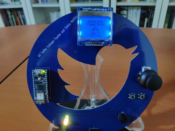

📌 D. Sleep
📊🔄 The device activates the sleep mode in 10 seconds while printing the remaining seconds.
📊🔄 The device displays the color pattern - red, green, blue, purple, white - during the sleep mode.
Videos and Conclusion
After completing all steps above, I placed the device on my desk by utilizing a plastic easel as a fitting and stylish decoration for my room. It works stupendously :)
