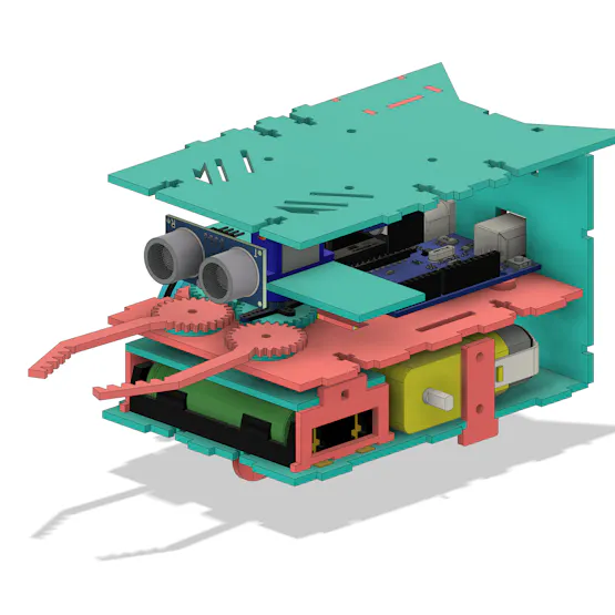

One of the characteristics of this robot is its size. It was built to be very compact and agile. The figure below shows the internal region of the robot.
In the internal structure, it is possible to observe the ultrasonic sensor, the DC motors, the support for rechargeable batteries, the drive module, and the battery charger module.
At some points, it is also possible to observe some tears, where the spare parts of the sides and surfaces of the prototype will be fitted.
Fittings designed for M3 nuts and bolts were designed to fix the structure.
The M3 screw has ideal size for this type of project, as a size above or below this, could unnecessarily increase the weight of the prototype, or make it more fragile, respectively. Figure 3 illustrates the internal and upper surfaces of the robot.
Figure 3 - Internal lower and upper surfaces of the robot.

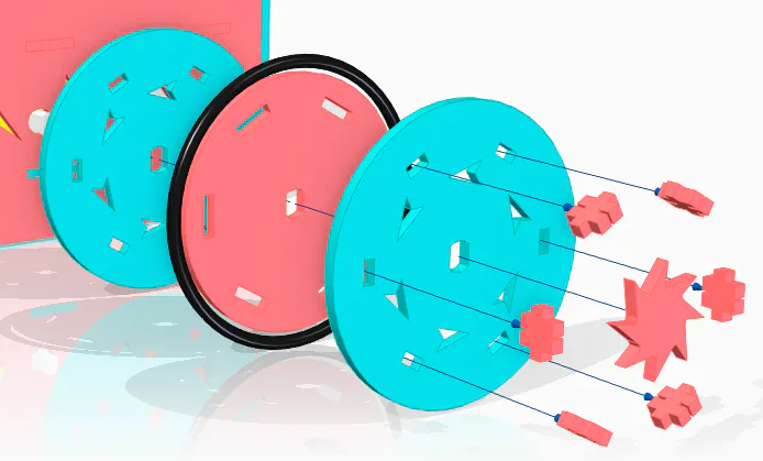

The wheel of this robot has three parts: the internal, the intermediate and the external. The internal and external have the same structure.
The three parts that make up the wheel are connected by 6 pin-like structures, however, with a rectangular shape, in order to leave the three parts fixed to each other.
In addition to this structure used to fix the three parts of the wheel, a part was also modeled to be in the center of the external wheel, in order to hide the hole in the motor shaft.
The following figure illustrates the composition of the Claw Fighting Robot wheel, along with an oring ring.
