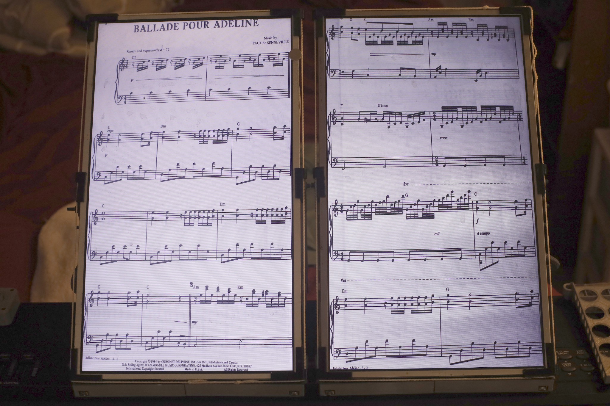

The lion kingdom's goal was always a cheap & large 2 page display, replicating the original book format.  The easiest way to get there was 2 monitors in portrait mode.  Cheap portable LCD monitors finally started appearing in 2019, but they weren't really cheap enough to dedicate to nothing but showing music.
The lion kingdom's stock of obsolete laptops finally reached an age where they were never going to be used again & cheap HDMI to LCD converters abounded.  They were the venerable LTN156AT24 & LP156WH4.  They both had 40 pin connectors & LED backlights.  They both ran on 6 bits per channel.  The point had arrived where a dual 15.6" 1366x768 display just might be possible for under $100.

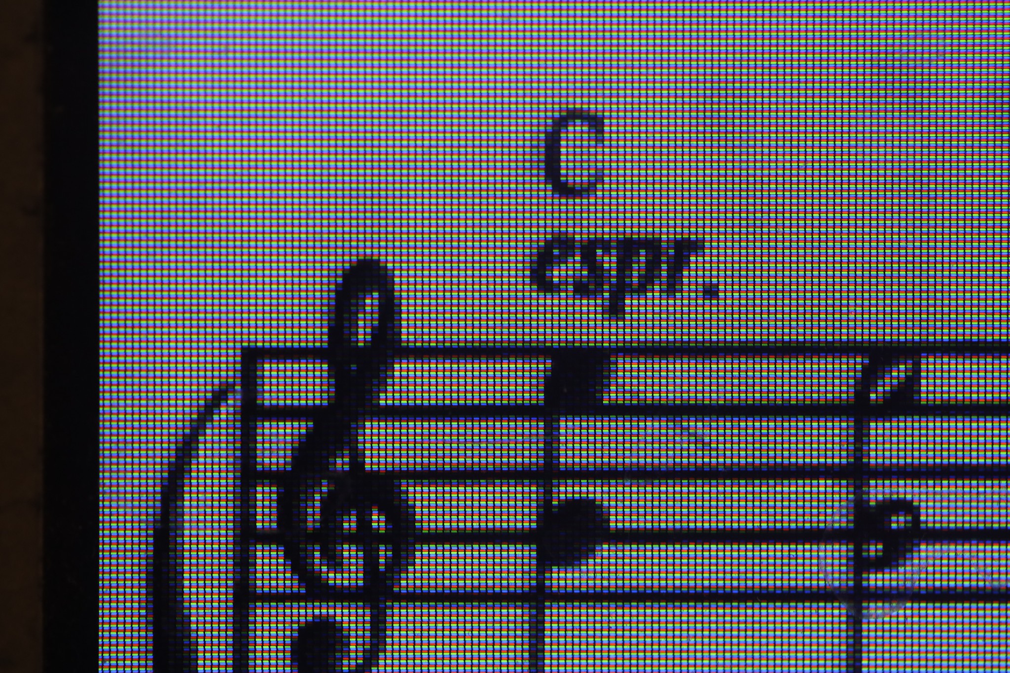

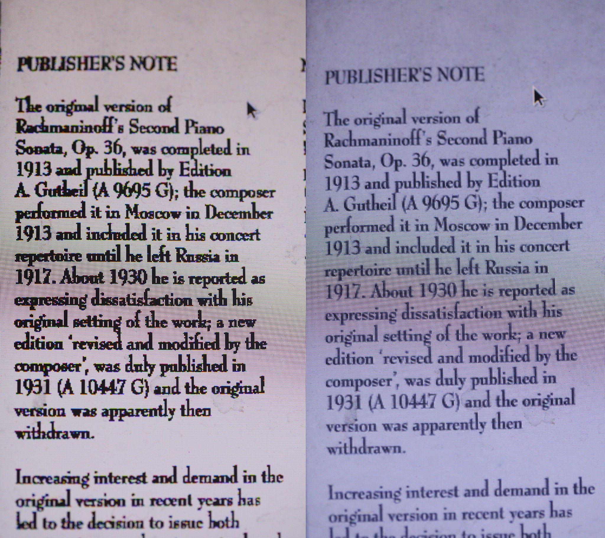

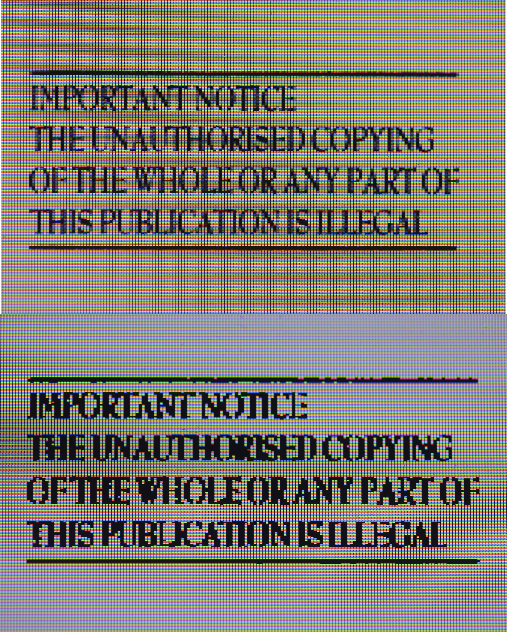

1366x768 might be just enough resolution to replace paper if the RGB channels were used as pixels & the text was cropped.  It still remaned a much cheaper option than 1920x1080 panels.
The mane problems with these panels are they're really tall & the electronicals take a lot of space.  Besides the HDMI converter, they would need a raspberry pi, HDMI cables, & power supply.
Finding a suitable LCD controller is manely about finding one with the right cable.  All LCD controllers seem to do the same basic conversion from HDMI to a certain number of LVD pairs & they all have a header for powering a backlight inverter.  None of the converters outside China had a 40 pin cable.  They all had 30 pin cables.  The goog finally came up with a bang good match.

They also have different cables for connecting a converter board to a 40 pin or 30 pin panel.  Presumably they all connect to the same Novatek board.  Sadly, trying different cables by mail ordering from China could take years.
The lion kingdom got lucky & the 40 pin cable worked with the 40 pin connector on the LTN156AT24 & LP156WH4.

A 3D printed stand, power cables, HDMI cables followed.
A highly efficient X11 program made the 1B's run as fast as 4B's.  Giant 14" tall pages from PDF finally returned.

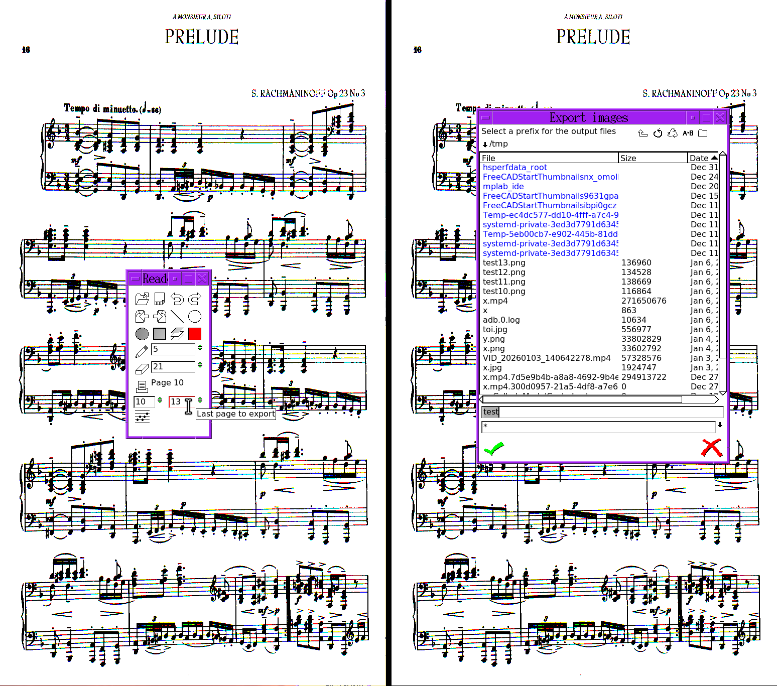

A custom pointing device could be used without a table.
Custom software allows annotating on 1 screen.

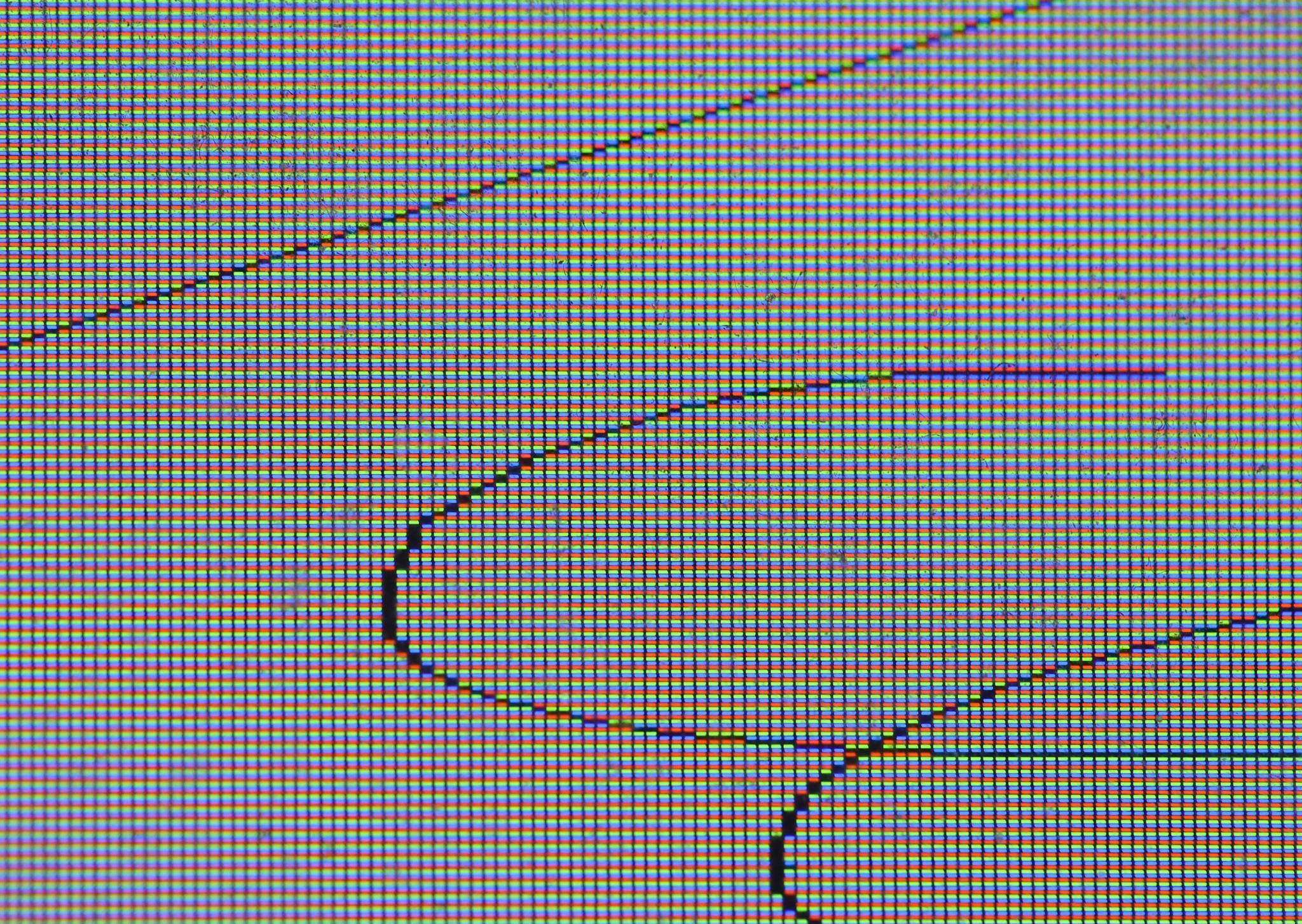

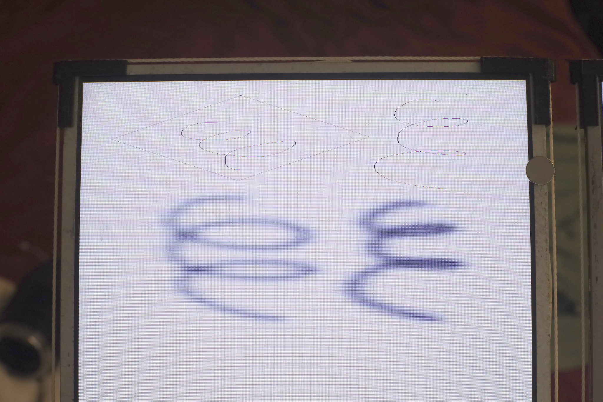

    Annotating music with this system has proven to be a dumpster fire.  Despite every effort with the zoom feature & the stylus, it just doesn't work.  The mane problem is the resolution is too low.  Even 1080x1920 wouldn't be high enough resolution to simulate writing tiny numbers on paper.   Every pixel has to count so cursor movements are real slow, trying to hit the exact pixel.  Drawing accurate lines with fat pixels is real hard.  Constraining to certain angles might be necessary.
    The zoom level makes a slight difference, but it still feels like the cursor is always on the edge of 2 pixels & you have to move very slowly to hit the right pixel.  The stylus isn't as smooth as hoped.  It sticks & stutters along.  It's not much better than drawing with a joystick in 1984.
    The line tool is slow but accurate for drawing text.  The pencil tool can draw slightly faster but very messy text.  The circle tools are essential for drawing notes, but it's real hard with fat pixels.  The pencil tool has only been useful for drawing dots.  Hollow & filled ellipses for the pencil tool might make it faster for drawing notes than the circle tool.  A virtual keyboard & a text tool seem to be the biggest need.
    Maybe a capacitive touch screen should replace the track pad, but that's an expensive proposition.  It might be time to reconsider a trackball.  There's also going with a small mouse or using a phone screen as a track pad.

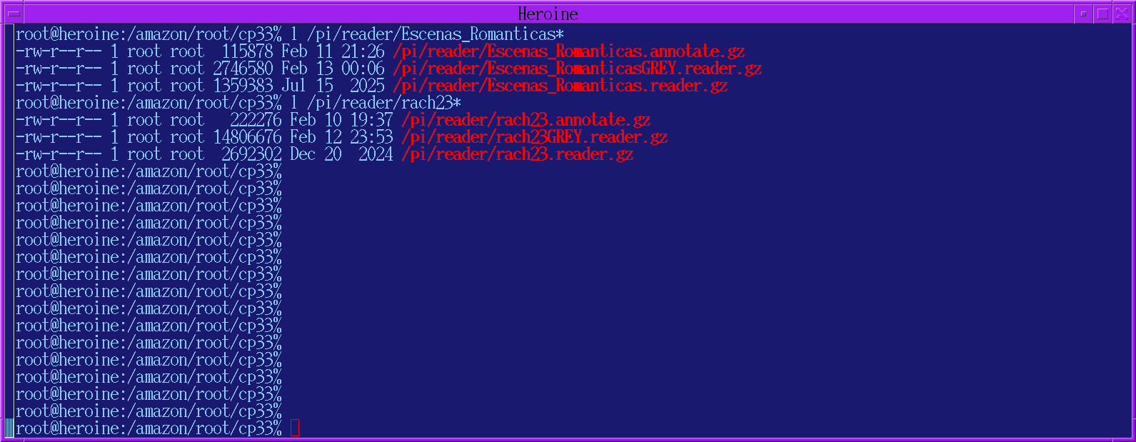

    Using dual 800Mhz raspberry pi's has been less than ideal.  The mane problem is it takes a real long time to load a score & save a score after annotating.  Page turning is fast.  The pi's also don't have a sleep mode, so they're getting expensive to keep on all day.

    The limitations of 1366x768 only became obvious in denser Liszt music.  Only by previously knowing what it should sound like is it legible.  The original PDF isn't very legible either.  Maybe there's a smarter way to preserve more details than thresholding & using RGB channels as pixels.  The x dimension is what kills it.  There would have to be a translation of common symbols in the PDF to a library of vector graphics, then precisely positioning & scaling the vector graphics.  Quite an effort with little gain in an age of 4k panels.  If the input pixels alternate horizontally between light & dark between the output pixels, it could force the output pixels to alternate horizontally without regard for position.
    Upgrading to 1920x1080 panels is tempting & would allow everything to run on a single raspberry.  16x9 is not as ideal as 4x3, but there aren't any 4x3 panels.  It would also entail ordering 2 sets of LVD cables.

    Being a low res 1366x768 bitmap of early 1990's vintage requires more accurate pointing.  When lions freepaw text on a PC, they always use a zoom feature.

    So the circular & hollow brushes proved useless & implementing XOR previews for a circular brush was more trouble than it was worth, so in keeping with minimalism, everything went back to a square brush.  Lions seem to recall PC Paint just supporting square brushes.  Helas, the hollow circles don't follow the contours of the XOR preview.
    Circle, disc, box, & line tools arrived.  Lions can appreciate why the Gimp doesn't have XOR previews of all the tools as PC Paint did.  The fast XOR preview entails writing every tool twice, handling corner cases for showing & hiding the XOR previews, making sure the XOR preview matches what's drawn.
    10 year old lions had no clue how to program an oval drawing routine & drawing ovals is still hard, in middle age.  Even the mighty koala paint didn't have an oval drawing routine, only circles.  The easiest way nowadays is to solve the pythagorean therum for every X to get Y on a circle, then scale the Y to get an oval.  To speed it up, it's done with a floating point lookup table.
    The result is the kind of blinking XOR cursors & line filled brush strokes that lions remember of PC Paint on an 8 Mhz Olivetti 24, but on all off 700Mhz.  Maybe it would have been faster on the framebuffer or using SDL.  The brush stroke routine is suboptimal in the limit.  Brush stroke & hollow circle definitely need improvements.  The XOR cursors are all Xorg routines drawing to the frame buffer.
    Instead of a full screen clear button, it has a filled box tool with 1 of the colors being erase.  That has greatly improved erasing to the point of almost completely replacing the erase tool.
    The line, oval tools improved annotating but it's still manely a nightmare.  The low resolution makes precision a lot more important, like it was in the days of 640x400.  Either it needs a zoom function, a way to lock lines on the axes, or a way to selectively decelerate the pointer.  A trackpad won't do the job if it's already hard with a mouse.  Lions believe a trackpad with stylus could be the best pointing device.
