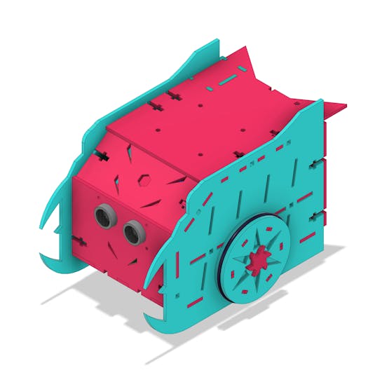

The robot was created with a reduced size and few parts. The objective is to allow the robot to be light and fast for sumo competition.
The figure below shows the complete structure of the sumo combat robot.

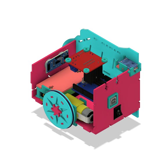

Its internal structure is divided into 2 parts: upper and lower. See the figure below.
In the upper structure we have the Arduino, the TP4056 module, the L293D driver and the ultrasonic sensor. Below we have the lithium batteries, the 2 motors and the button to turn the robot on/off.
In the figure below the components can be seen from another angle.

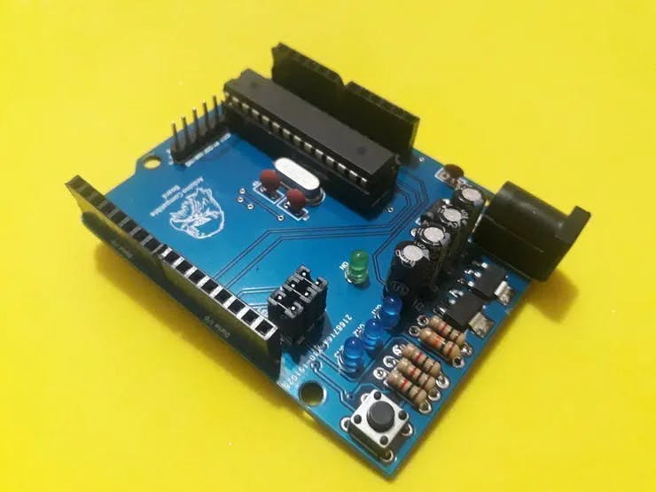

Use the JLCPCB Arduino Compatible printed circuit board presented below.
You can obtain the Arduino JLCPCB compatible PCB for your projects for $2 in your first order with the link: Earn my PCBs Arduino Compatible.

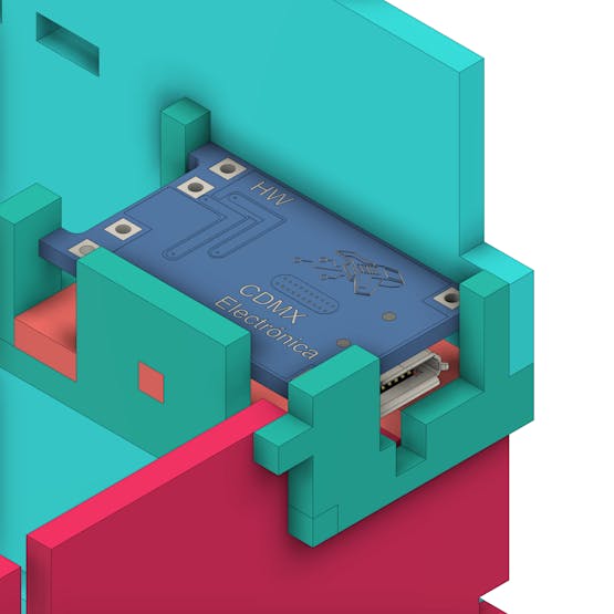

See the snap-on structure of our mobile robot's battery holder. The position of the support was defined on the front of the robot with the aim of reducing its size.
The batteries are installed in the bracket with a wire exit opening on its side.

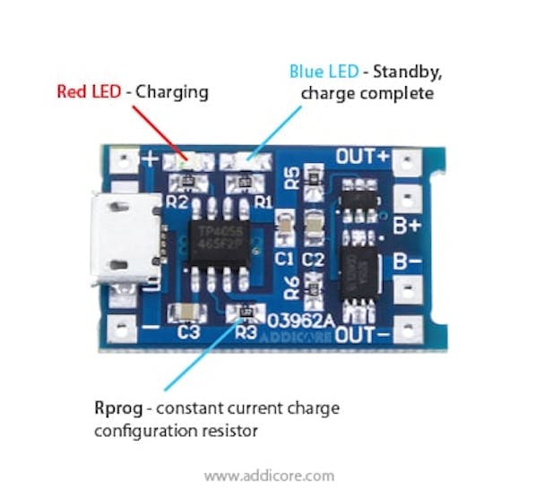

It is not necessary to remove the battery to charge its energy, as we are using the TP4056 module. See the module in the figure below.
The TP4056 module will be responsible for receiving power and recharging the 18650 lithium batteries.
How does it work and what are the main features of the TP4056 module?
This model is responsible for powering Li-Ion 18650 batteries through the constant voltage current charging method. The old modules did not have this protection system, however, this is already presented in the current models.
In this module there are two integrated circuits: the TP4056 and the DW01. The DW01 integrated circuit is responsible for carrying out the battery current protection.
The TP4056 module supplies a charging current of 1A and, after that, it interrupts the current when the recharge is finished.

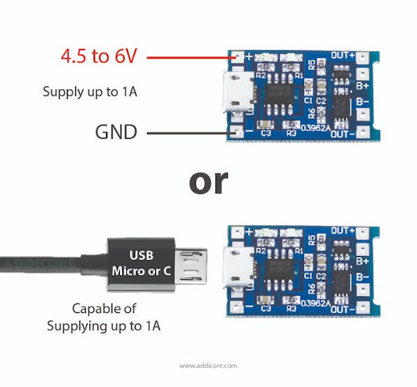

Which power supply should we connect to charge the batteries?
The power supply must provide at least 1A for the battery charging process to take place correctly. The power cable must be USB Micro or USB C type. In addition, you can use + and - pins. See the diagram in the figure below.
Most modern phone/USB chargers can deliver 1A or more.
Check the information in the power supply manual and carry out the process safely.
The module has 2 LED indicators during the battery charging process. Red indicates battery charging and blue indicates full charge.
See USB connector access structure to recharge the battery.
In the figure above, we can see the mini USB connector in the upper right corner. The user must connect the cable to start charging the battery.
In addition, it is possible to observe the Arduino's USB connector, to carry out the robot's programming. This avoids removing Arduino for logic programming and testing. The button, shown in the figure, is used to turn the robot system on and off.

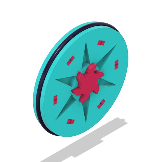

Let's look at the wheel structure of our mobile robot.
There are different models of wheels for mobile robots on the market. However, they are not easy to find in all stores and some are very expensive. Also, we were unable to customize the wheel for our project.
Thinking about this problem, we decided to create a model of a custom wheel for our robot.
The wheel has a design, shape and size that ensure a good match with our mobile sumo robot model.
This wheel is composed of 2 materials in its formation: MDF structure and the o-ring ring.
  • MDF is the material responsible for creating the wheel structure.
  • The o-ring is a circular rubber and is used to increase the wheel's grip on the ground.
