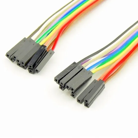

Most people use low-quality cables and this can create problems in the electrical connections of your circuit.
The first way to avoid loose connections is to choose high-quality cables with female connectors. They are more secure and are attached to male headers.
This type of connector is safe and inexpensive. It is quite used in many projects.

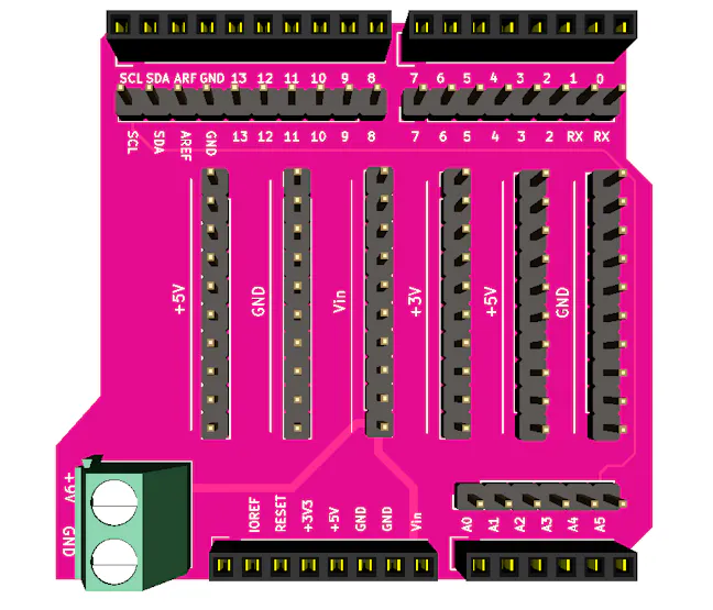

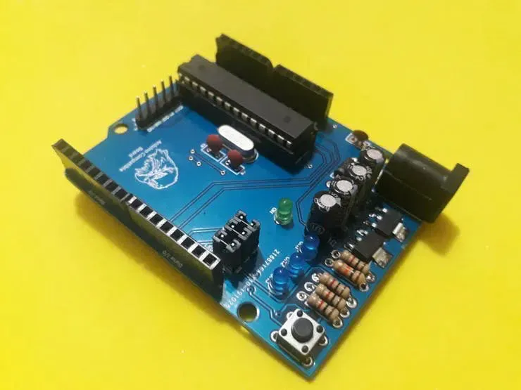

Thinking about this type of connector, we developed a board to facilitate connection and prototyping. It is a shield for Arduino.
Now, we will introduce its features and usage advantages.
Why was this board created?
The shield circuit board was developed with the objective of reducing loose connection in Arduino circuit of your project.
The board is connected to the female pins of the Arduino and has several male headers for connecting the wires. See the figure presented below.

In addition, we want offer other gift for you. You can download this Arduino Printed Circuit board.
Use the JLCPCB Arduino Compatible printed circuit board presented below.

To solve this problem we put in several buses. For example, we have 2 buses for GND.
This way you can connect each button to a pin on the bus, keep the structure organized and avoid any loose connection problems.

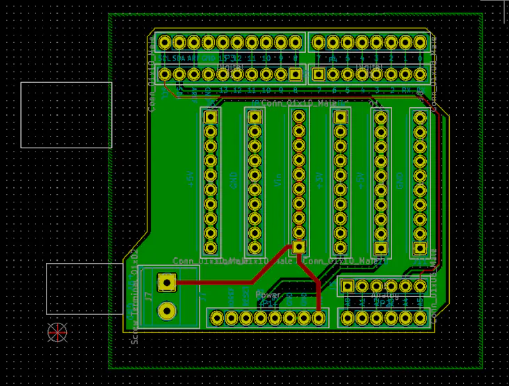

In the figure below, we have the image of the layout of the printed circuit board.
Now, see the connector to power supply the board.
In addition to the header connectors, I added a screw connector to power the project with a voltage of 9V.
