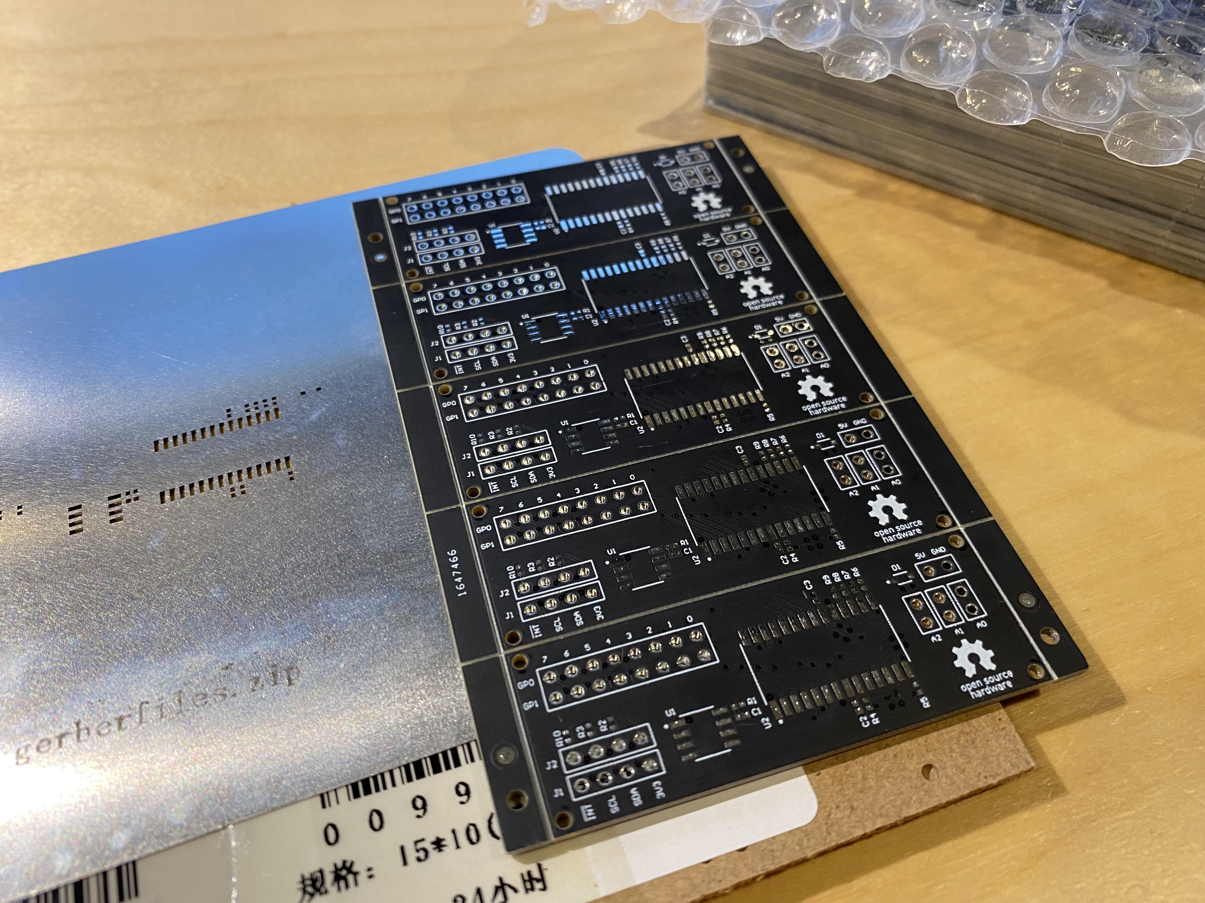

    Production panels with stencil. Only minor adjustments were needed for this revision; silkscreen artifacts in the prototype were cleaned up and tooling holes were added for test fixture placement.
