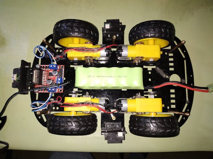

    --> Assembling 4WD Robot Car Chassis
    • Next, I show you with images how to assemble the parts printed in the previous step, the sensors and the programming boards on the "4WD Robot Car 'Chassis".

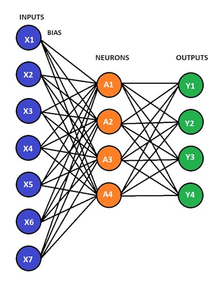

    --> Neural Networks
    • Here I explain how to design the neural network, how to improve the neural network, and how to get the coefficients of the neural network. The programming language used is Python.

    • I made several attempts to achieve a stable neural network; even I removed 14 combinations of possible 64 in table of the section five; these removed combinations were difficult to happen, for example when all entries are 1.

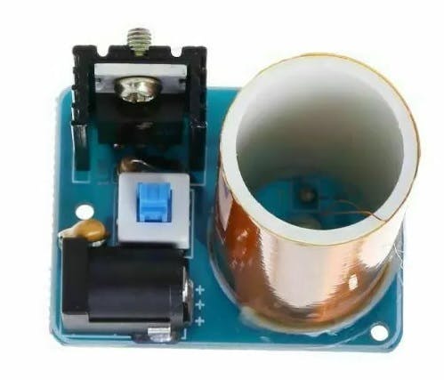

    Tesla Coil
    A Tesla coil is an electrical resonant transformer circuit designed by inventor Nikola Tesla in 1891. It is used to produce high-voltage, low-current, high frequency alternating-current electricity. Tesla experimented with a number of different configurations consisting of two, or sometimes three, coupled resonant electric circuits. Tesla used these circuits to conduct innovative experiments in electrical lighting, phosphorescence, X-ray generation, high frequency alternating current phenomena, electrotherapy, and the transmission of electrical energy without wires. Reference: https://en.wikipedia.org/wiki/Tesla_coil
    Tesla coil closeup
                                   Tesla coil close-up
    In this project I'm using this principle to transmit electrical energy to the UV lamp by means of a Tesla mini coil. Thanks to this great invention I have the following advantages:
    • I have saved money on the purchase of a ballast, and an AC converter;
    • The robot is less heavy and less big;
    • I'm not using UV LEDs, which have very low power, and I'm not simulating UV radiation. This is real.
    Where can I get this device? Example: https://www.elecrow.com/mini-diy-tesla-coil-kit.html
    Mini DIY Tesla Coil
                                   Mini DIY Tesla Coil

    Assembling Tesla coil and UV lamp, recommendations:
    • Mount the Tesla coil and UV lamp on the back of the autonomous robot.
    • My UV lamp was turned on at a maximum distance of 2 cm from the Tesla coil, so I set them at a distance of 1 cm to ensure the lighting of the UV lamp. You can try something similar.

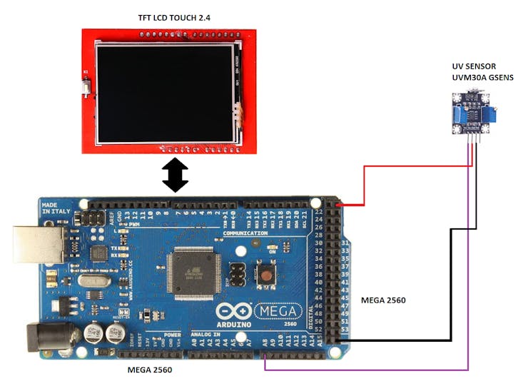

    UV Meter
    The World Health Organization publishes a practical guide on the UV index in which it explains the health risks of ultraviolet radiation and proposes some protective measures depending on their intensity.
    UV index
                                   UV index
    This is optional; to measure UV radiation I've developed this device, and using the UVM30A sensor. I show you the electrical diagram in the figure below:
    UV Meter
                                   UV Meter
    Code: uv-meter.ino

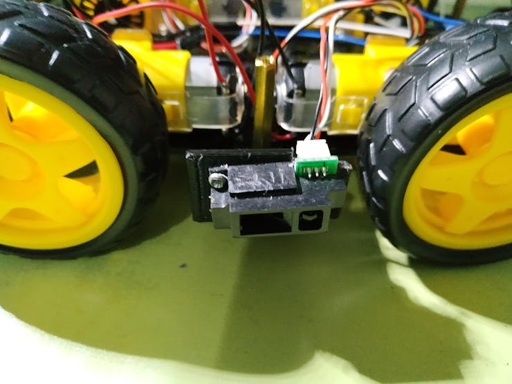

    The Autonomous robot is equipped with 3 analog infrared sensors, which detect the distance at which the walls are, one in front and two on the left and right sides. To calibrate the distances of the infrared sensors GP2Y0A41SK0F and GP2Y0A51SK0F, you can see the post and my code below: https://www.instructables.com/id/How-to-Use-the-Sharp-IR-Sensor-GP2Y0A41SK0F-Arduin/
    float ir_sensor_left =  6*pow(volts0, -1); // worked out from datasheet graph //GP2Y0A51SK0F - 2 a 15 cm
    float ir_sensor_center = 12.4*pow(volts1, -1); // worked out from datasheet graph //GP2Y0A41SK0F - 4 a 30 cm

    In this project we will create a neural network with Python and copy its weights to a network with forward propagation on the Arduino UNO board, and that will allow the Autonomous Robot to drive alone and without hitting the walls.
    For this exercise we will make the neural network have 4 outputs: two for each motor pair, since to the L298N driver we will connect 2 digital outputs of the board for each car motor pair (the two motors on the left are electrically linked, the same case with the two motors on the right.). In addition the outputs will be between 0 and 1 (depolarize or polarize the motor).
    Neural Networks
                                  Neural Networks
    We will have seven inputs:
    • First input is the activation of the Autonomous Robot that we saw on section 4 (Second case of Alexa's voice commands).
    • The next five inputs correspond to the infrared and ultrasound sensors; and
    • The seventh input is for the BIAS, the values will be 0 and 1.
    The inputs are assigned with the following logic:
    • The GP2Y0A51SK0F IR sensors on the left and right sides will have a value of 1 if the distance is less than 15 cm, and will have a value of 0 if the distance is greater than 15 cm;
    • The GP2Y0A41SK0F IR center sensor will have a value of 1 if the distance is less than 30 cm, and will have a value of 0 if the distance is greater than 30 cm;
    • The same case, HC-SR04 and the SRF05 ultrasound sensors will have a value of 1 if the distance is less than 30 cm, and will have a value of 0 if the distance is greater than 30 cm; and
    • The BIAS will have a value of 1.
    Here we see the changes in the table below:
    Inputs, Outputs and Actions of the gearmotors                              Inputs, Outputs and Actions of the Gearmotors

    Assembling autonomous robot, recommendations:
    • On the lower platform mount: Battery, gearmotors with wheels, L298N driver, power switch, and IR distance sensors.
    • On the upper platform mount: Battery, Tesla coil, UV Lamp, Relay, Arduino and ESP32-WROOM-32 boards, and the ultrasonic sensors.
    • On the top platform add (Not in Motion Version): Raspberry Pi and Arduino Pro Mini boards, rasperry pi camera, and reflector with servo.
    • I used 22 additional screws to the ones in the chassis kit.
    Now, I show you the parts assembled with their sensors mounted on the 4WD Robot Car Chassis in the figures below:
    4WD Robot + L298N driver + battery
                                  4WD Robot Car Chassis + L298 driver + BatteryGP2Y0A51SK0F
                                  GP2Y0A51SK0F IR Sensor

    UV lamp + Tesla coil
