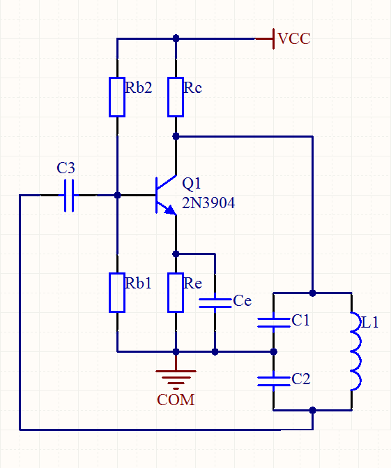

5. Capacitor feedback oscillator circuit
Connect the three ends of the two capacitors of the LC oscillating circuit to the three poles of the transistor respectively to obtain a capacitor feedback oscillating circuit. This oscillation circuit uses LC oscillation, 2N3904 amplification, and voltage series configuration feedback.
Oscillation frequency: [formula]
Adjust C1, C2 and L to adjust the oscillation frequency. Here, the 1Hz oscillation frequency is low, and larger capacitors and inductances should be selected: C1 and C2 are both 5mF, and L is 10mH.
According to the vibration condition of the oscillation circuit [formula]
Affordable vibration conditions are: [Formula]
β is the magnification, r_be is the base-emitter internal resistance, and R_L is the load resistance. Use this formula to get the value of collector resistance Rc. Here Rc is 180Ω. It should be reminded: circuit production requires patience to adjust the value. However, the best value of each component is still traceable. Under normal circumstances, most components can be fixed, and only one or a few component values can be adjusted at a time. Because it needs to be adjusted all the time, it is not suitable for soldering. You can use breadboard or Tianzi circuit board.
