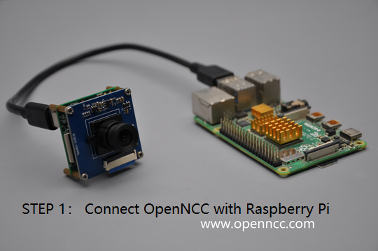

OpenNCC is a form of combining Intel NCS2 and camera module. It completes AI inference while imaging. The system has high integration and low comprehensive power consumption. It is easy to integrate an edge AI camera system with raspberry PI through a USB interface.
Connecting OpenNCC and raspberry pi
  • Power raspberry PI and install the OS
  • Connect raspberry PI 4 Model B and OpenNCC with USB. USB3.0 is recommended.
Configuring the Raspberry Pi
The following commands are operated on the board of Raspberry Pi. You need to connect raspberry with a monitor, mouse, and keyboard.
