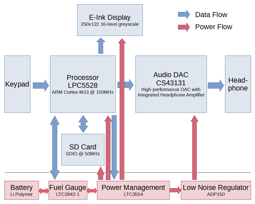

To best describe what's in the hardware, here is the block diagram
The main processor being used is the NXP LPC5528 microcontroller. It is an ARM Cortex-M33F based microcontroller manufactured at the latest (as of 2020) 40nm eNVM process. It has a hardware single-precision floating-point unit, which would allow running floating-point DSP algorithms much faster. It has 256KB of internal RAM and 512KB of internal flash. The DAC being used is the Cirrus Logic CS43131 DAC. It is a high-performance audio DAC with an internal charge pump and headphone driver. Integrated solutions allow us to make the device smaller. The screen is the GoodDisplay GDEH0213B72, which is a 2.13” E-ink display with a resolution of 250x122. Additionally, ADI LTC3554 and ADI ADP150 are being used for voltage regulating and charge control, regulating the power. For precise estimation of the remaining battery capacity, a fuel gauge (LTC2942-1) is also used onboard, providing tracking for the total energy used. This can be also useful for measuring power consumption.

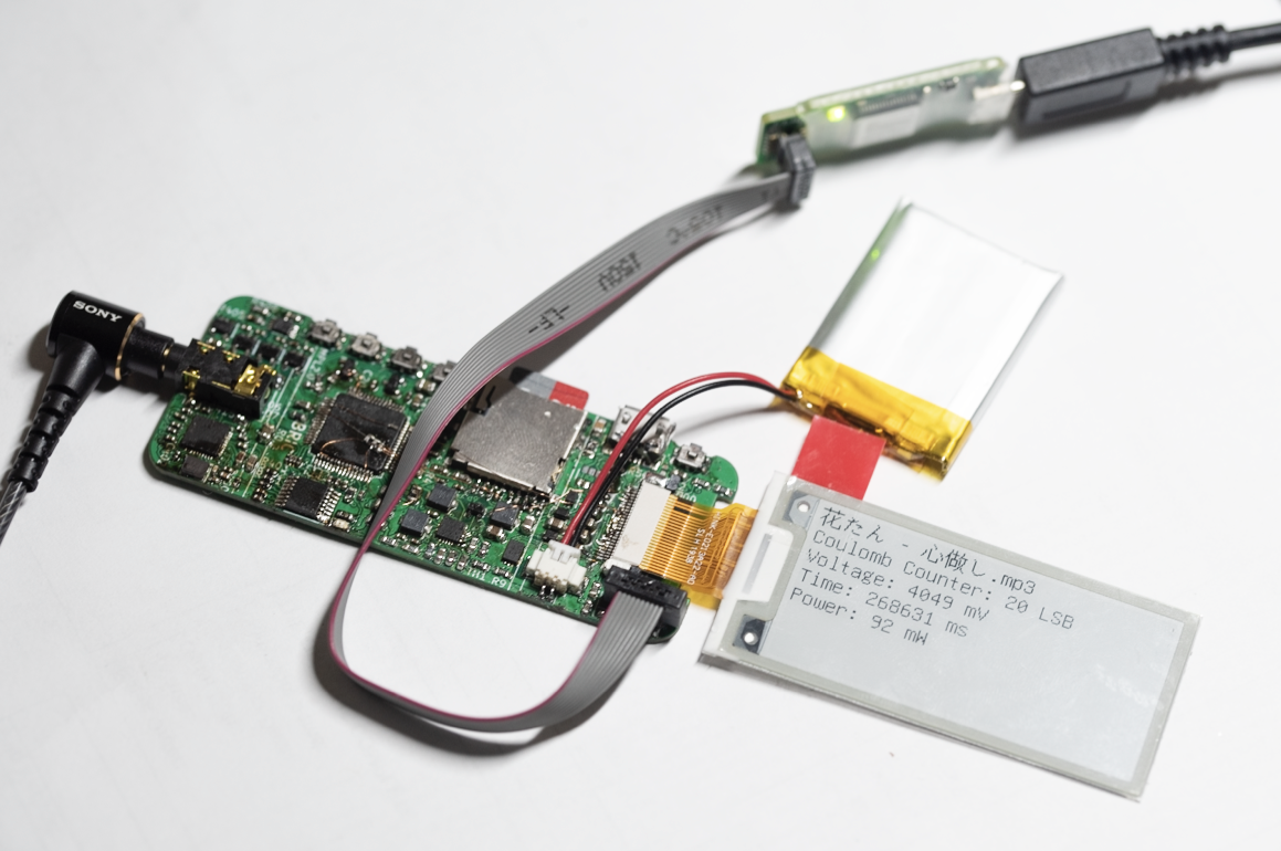

(R0.2 hardware running software MP3 decoder and showing power consumption)
