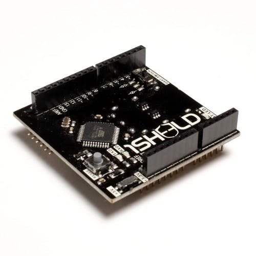

Arduino is an open-source platform based on flexible, easy-to-use hardware and software. It is intended for anyone who has an idea for a project and wants to bring it to the real life. To make a project with Arduino you need to buy some accessories to connect your Arduino to the real world, these accessories are called shields. 1SHEELD is a shield that allows you to use your smartphone as an Arduino shield like GSM, WIFI, Gyroscope, etc.
The main advantage of 1SHEELD is that it replaces all other shields with just your smartphone and saves you a fortune. It connects the Arduino to your smartphone using the Bluetooth and it gives you the ability to use more than shield at a time like GSM, WIFI, Accelerometer, Gyroscope etc.

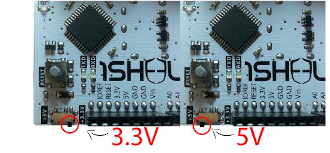

Step2: Adjust 1Sheeld

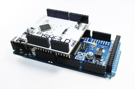

If you use an Arduino that works with 3.3 V like Arduino due you must switch your 1Sheeld to operate on 3.3V since it may damage your board.
If you use an Arduino that works with 5 V like Arduino Uno then switch your 1Sheeld to operate on 5V.

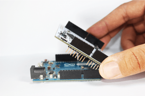

Place your 1Sheeld on your Arduino board then plug the Arduino to your laptop or PC.
If you use an Arduino mega then connect your 1SHEELD to the mega as shown in the image

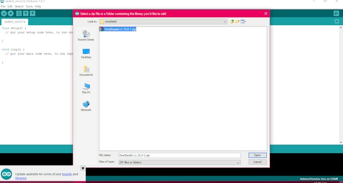

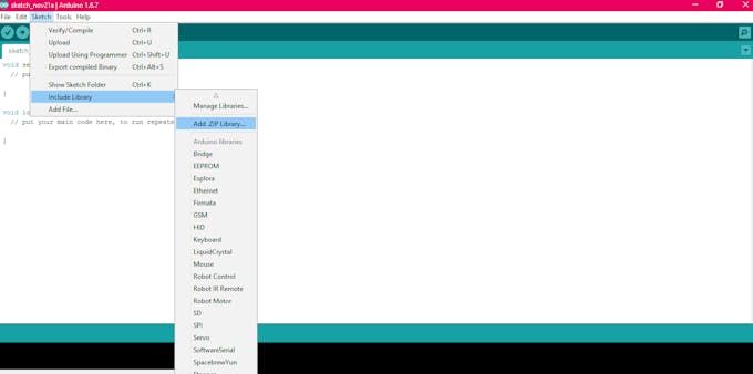

Step 4: download 1sheeld library to your computer
Download the liberty from here
Then, after you successfully downloaded the library, add the library .ZIP file to your Arduino program
