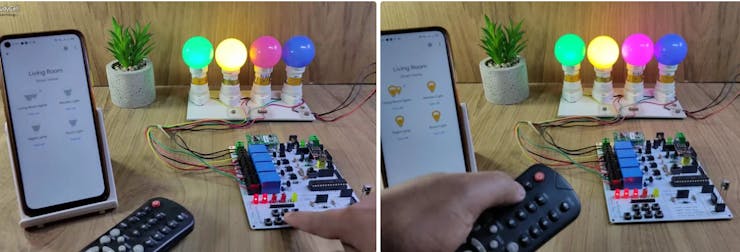

In this IoT project, I have shown how to make an IoT-based Arduino Smart Home with Google Assistant & Alexa using ESP-01 to control 4 home appliances with voice commands, IR remote, and manual switches.
If the internet is not available, then you can control the home appliances from IR remote & manual switches. During the article, I have shown all the steps to make this smart home system.
Tutorial video on Arduino IoT Project
This Arduino Home Automation system has the following features:
- Control appliances with Google Assistant.
- Control appliances with Alexa.
- Used Arduino EEPROM to remember previous states
- Control appliances with IR remote.
- Control appliances manually with switches or pushbuttons
- Monitor real-time feedback in the Google Home and Amazon Alexa App.
- Control home appliances manually without internet.
- All resources used for this project are FREE.
So if you follow all the steps, you can easily make this IoT project just by using Arduino UNO, ESP01, and relay module.
Although the PCB is not mandatory, I have used PCB to make the circuit compact and give the project a professional look.

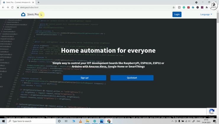

Create an Account in Sinric Pro
First, visit https://sinric.pro/
You have to create an account in Snric Pro.
Then log in to Sinric Pro Account.
You will get an APP KEY and APP SECRET for the account, which will be required in the code.

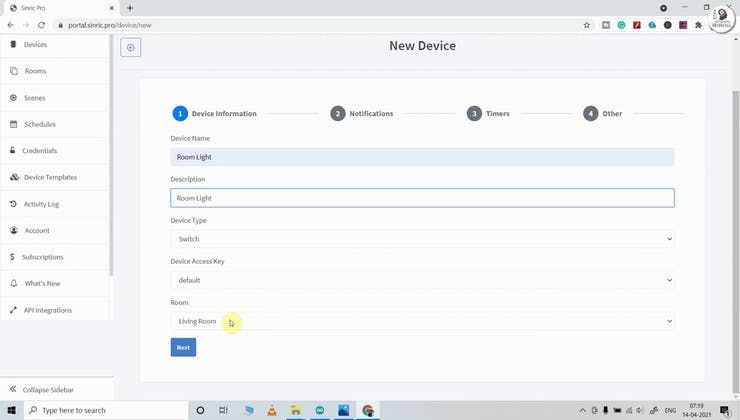

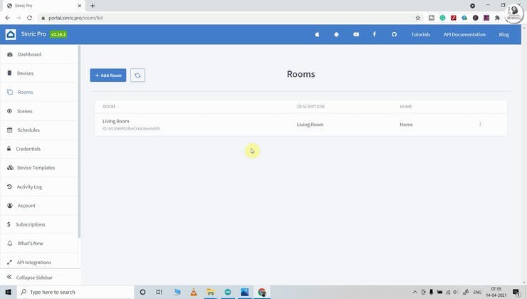

Add Room in Sinric Pro account
After that add a room and give a nickname to that room (Ex: Living Room)

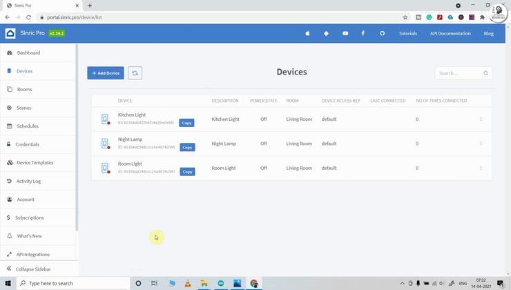

Add Devices in Sinric Pro account
Then Add devices one by one and give the nickname for each device. Sinric will assign a unique device ID for each device.
Here, I have used the free Sinric Pro account, so I can add a maximum of 3 devices for free.

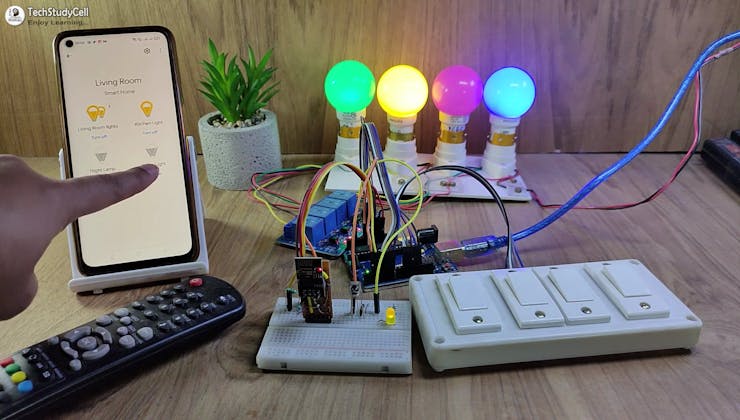

Testing the Circuit Before Designing the PCB
Before designing the PCB, I have made the circuit with Arduino UNO, ESP01, some resistors, and an IR receiver for testing all the features.

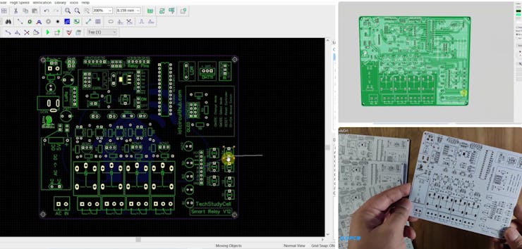

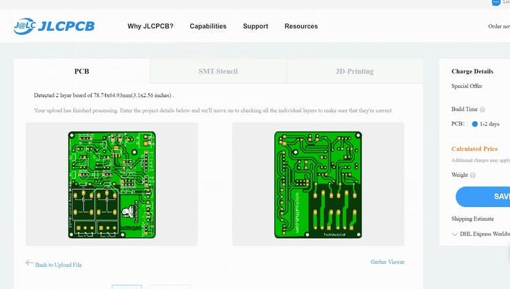

Design the PCB for This Smart Home System
To make the circuit compact and give a professional look, I have designed the PCB after testing all the features of the smart relay module.
You can download the PCB Gerber file of this home automation project from the following link:
Download PCB Gerber from GitHub

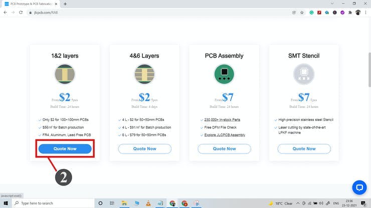

Order the PCB
After downloading the Garber file you can easily order the PCB
1. Visit https://jlcpcb.com and Sign in / Sign up.
2. Click on the QUOTE NOW button.
3. Click on the "Add your Gerber file" button. Then browse and select the Gerber file you have downloaded.

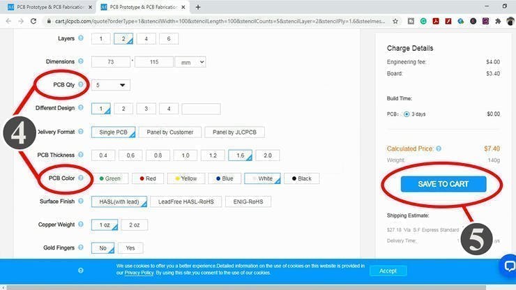

Uploading the Gerber File and Set the Parameters
4. Set the required parameter like Quantity, PCB masking color, etc.
5. After selecting all the Parameters for PCB click on SAVE TO CART button.

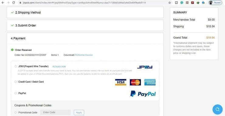

Select Shipping Address and Payment Mode
6. Type the Shipping Address.
7. Select the Shipping Method suitable for you.
8. Submit the order and proceed with the payment.
You can also track your order from the JLCPCB
My PCBs took 2 days to get manufactured and arrived within a week using the DHL delivery option.
PCBs were well packed and the quality was really good at this affordable price.

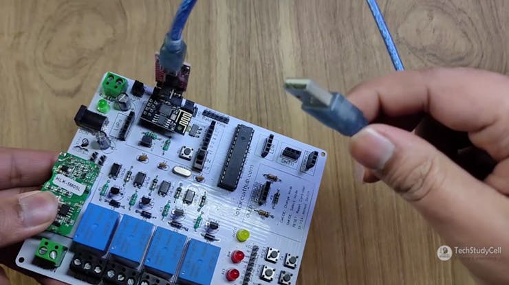

Solder All the Components on PCB
After that, I have soldered all the components as per the circuit diagram.
Then connect the ESP01 board with the PCB.

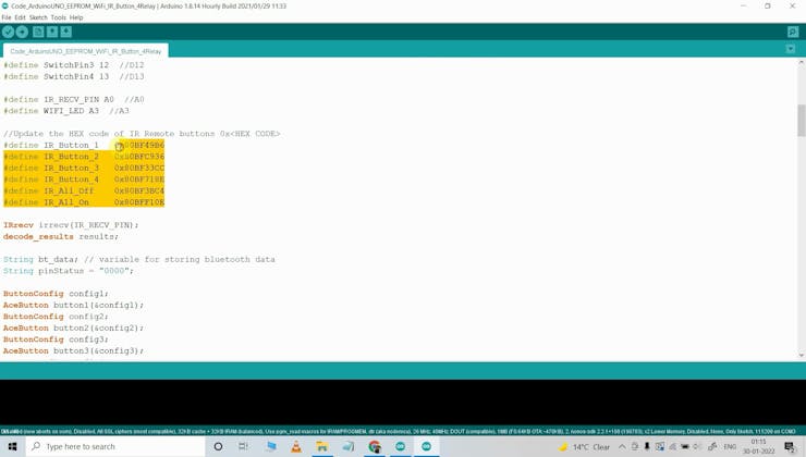

Get the IR Codes (HEX Code) From Remote
Now, to get the HEX codes from the remote, first, we have to connect the IR receiver output pin with the A0 pin of Arduino UNO. And give the 5V across the VCC and GND. The IR receiver must have a metallic casing, otherwise, you may face issues.
Then follow the following steps to get the HEX codes:
- Install the IRremote library in Arduino IDE.
- Download the attached code, and upload it to Arduino UNO.
- Open Serial Monitor with Baud rate 9600.
- Now, press the IR remote button.
- The respective HEX code will populate in the serial monitor.
- Save all the HEX codes in a text file. You have to update these HEX codes in the main sketch.

For the main sketch, you need to install the following libraries
Then you have to update the HEX code in the sketch for IR remote control.
For momentary switch use the code: Code_ArduinoUNO_EEPROM_WiFi_IR_Button_4Relay.ino
and for latched switch use the code: Code_ArduinoUNO_EEPROM_WiFi_IR_Switch_4Relay.ino

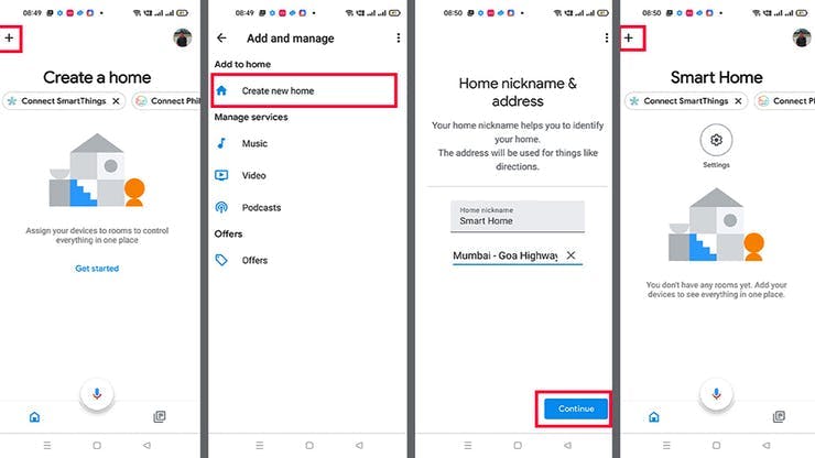

Setup the Google Home App
First, download and install the Google Home App. then follow the steps to create Home in Google Home app
- Tap on the "+" icon (upper left corner).
- Tap on Create new home.
- Enter the Home nickname and address.
- Then click on Continue.
The Home is created. Now again tap on the "+" icon to add devices.

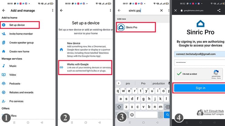

Connect Sinric Pro With Google Home App | Add Devices
After creating the Home in the Google Home app, you can connect the Sinric Pro with the Google Home app
- Tap on the "+" icon, then select Set up device.
- Tap on Works with Google.
- Search for Sinric Pro, then select Sinric Pro.
- Enter the email id and password used for the Sinric account,
- Then tap on Sign in.
Thus, all the devices from Sinric Pro will be added to Google Home Account.

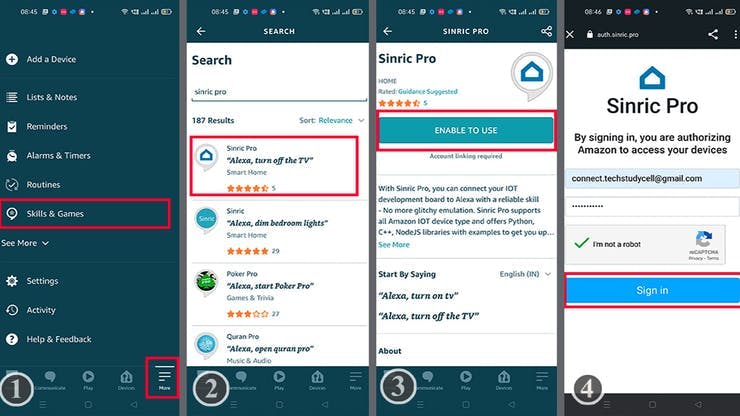

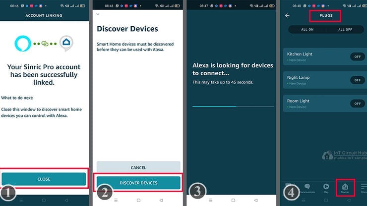

Configure the Alexa App for This Smart Home System
Download and install the Amazon Alexa App from the Google play store or App Store.
- Go to "More", then select "Skills & Games"
- Search for Sinric Pro and tap on "Sinric Pro".
- Tap on "ENABLE TO USE"
- Log in with the Sinric account credentials.
Connecting Devices With Alexa
- Tap on CLOSE.
- Tap on "DISCOVER DEVICES".
- It will take a minute to add devices. During this time the NodeMCU should be connected with the WiFi.
- Tap on "Devices", and tap on "Plug" to see all the devices.
Thus, all the devices from Sinric Pro will be added to Amazon Alexa App.

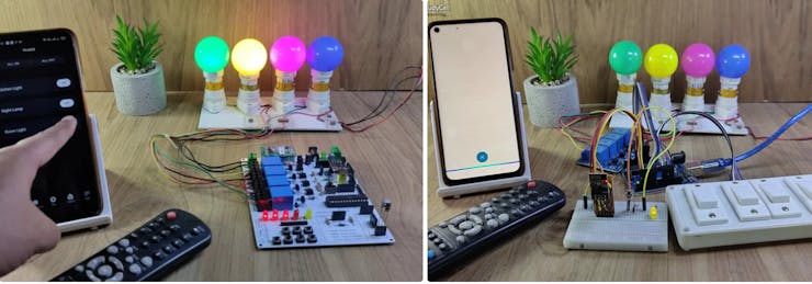

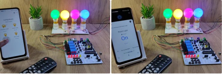

Controlling Relays With Google Assistant and Google Home
If the ESP01 is connected with the WiFi, then you can control the home appliances from Google Home App.
You can also ask Google Assistant to turn on and off the appliances.
You can control, monitor the real-time status of the relays in the Google Home App from anywhere in the world.
You don't need any Google Home Nest device for this home automation project.
Controlling Relays With Alexa
You can also control the home appliances from Amazon Alexa App if the ESP01 is connected with the WiFi.
You can also ask Alexa to turn on and off the appliances.
You can also control the appliances from the manual switches or IR remote and monitor the real-time feedback of the relays in the Amazon Alexa App from anywhere in the world.
You don't need any Echo DOT device for this home automation project.
Controlling Relays Manual Switches & IR Remote
If the WiFi is not available, you can control the relays from the manual switches or IR remote.
The ESP01 will check for the WiFi after every 4 seconds.
When the WiFi is available, the ESP01 will automatically connect with the WiFi.
Please refer to the circuit diagram to connect the manual switches or pushbuttons.
