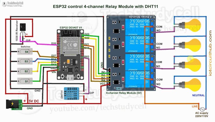

Circuit Diagram of the ESP32 IoT Project
The circuit is very simple, I have used the GPIO pins D23, D22, D21 & D19 to control the 4 relays.
And the GPIO pins D13, D12, D14 & D27 are connected with switches to control the 4 relays manually.
I used the INPUT_PULLUP function in Arduino IDE instead of the pull-up resistors.
IR remote receiver (TSOP1838) connected with D35. And the DHT11 sensor is connected with RX2.
I have used a 5V mobile charger to supply the smart relay module.
Please take proper safety precautions while working with high voltage.

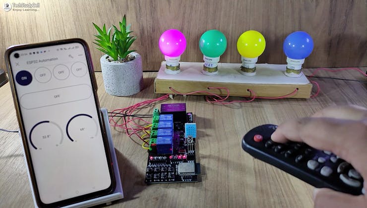

Blynk & Google Assistant Control Relay Using ESP32
In this IoT project, you can also control the relays with sensors and Timer using Blynk Automation.
Here, I have controlled the 3rd relay with temperature and the 4th relay with the predefined time schedule.
IR Remote & Manual Switch Control Relay Using ESP32
You can always control the relays from the IR remote or switches. For this project, you can use any IR remote.
You can monitor the real-time feedback in the Blynk IoT App.
