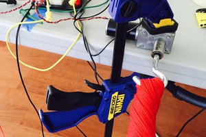

    Prior Planning makes tedious jobs easier
    Attaching 14" leads to 30 vibration motors using thin wires is a complete PITA, so I took some time to come up with a fast way.
    It occurred to me that if one were to hook one wire on another with a weight at the end, the hooks would keep the wires in contact while soldering. The motors act as an acceptable weight, and the whole process becomes much simpler.
    I was able to process 16 motors in in an hour using the following technique. Someone with younger eyes could probably do it a little faster - I always seem to have trouble "threading the needle" when hooking the motors.
    You may be able to extend and adapt this system for even better results.

    Step 1: Make a wire jig
    The first step is to make a jig to allow fast measurements and cuts of wire. Some hobby sticks and rubber bands attached to a ruler fit the bill.
    Here's a hobby stick fastened at the 15 inch mark:
    And here's the other end, at the 1" mark. Total 14 inches of lead.
    Wind the wire across the two jutting sticks
    Using twist ties (the grey thing on the ruler), clamp the wires onto the ruler to keep them together. Use two or more ties - at least one at each end.
    With the wires clamped, cut the wires loops at each end.
    When done, bend the wires out so that they are held tidy by the twist ties. Bend the bottom section of wires (not shown) up 180 degrees and twist them together. This will help keep both ends in place.
    Result: N wires neatly held to the rules, where N is the number of wire loops.
