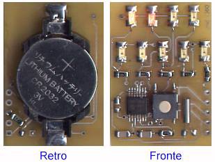

Here is the prototype (back / front):
This is the PCB design (just small image, but the 1:1 PDF is in zip file)
Note that the circuit uses conductive vias.

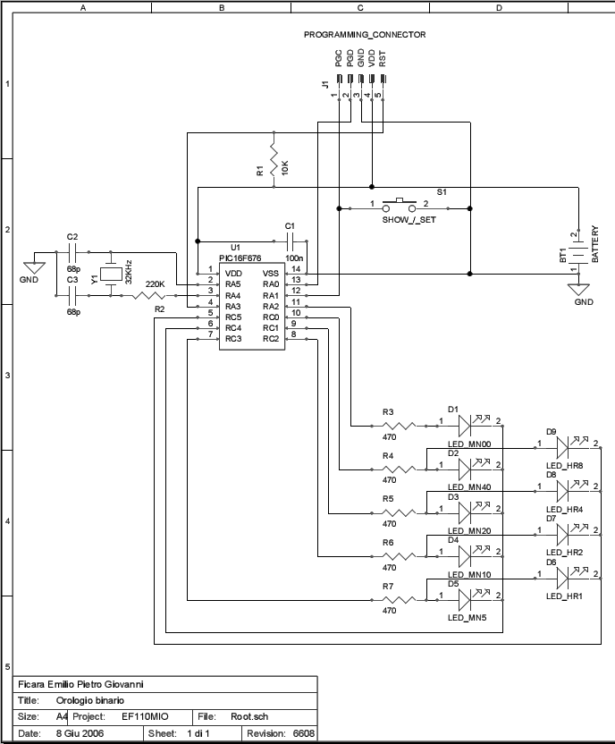

And finally the schematic diagram (PDF version is included in the downloadable ZIP)

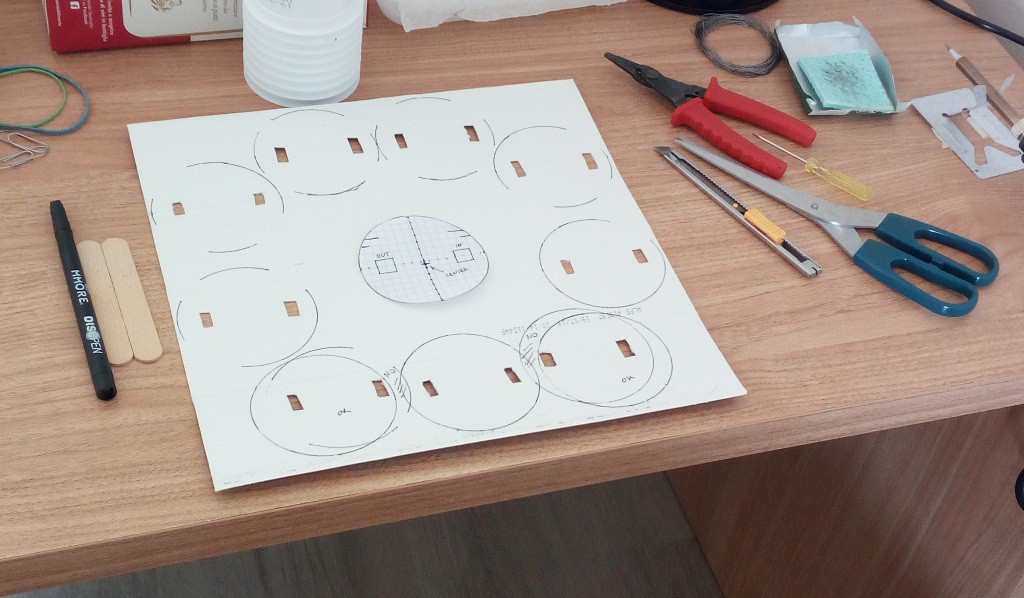

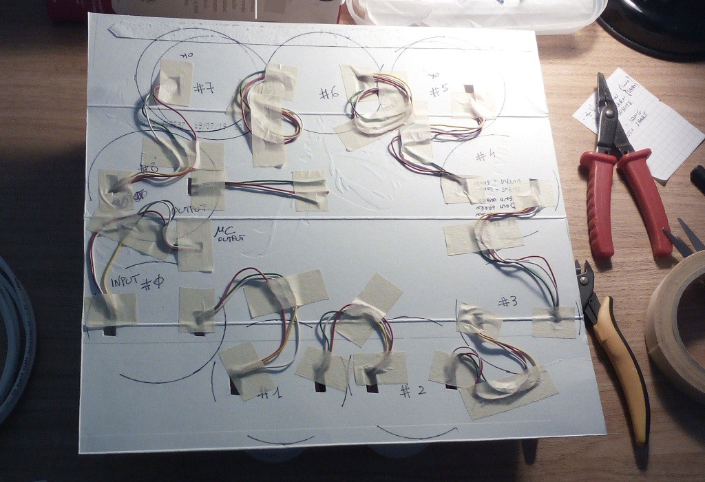

The most complicated part, of course, was the creation of the display. I cut out the strip in the various pieces of 3 leds and then I reconnected the wires. As "diffuser" elements I used (empty) yoghurt jars.
step1: element mapping
step 2: wiring (what a pain)

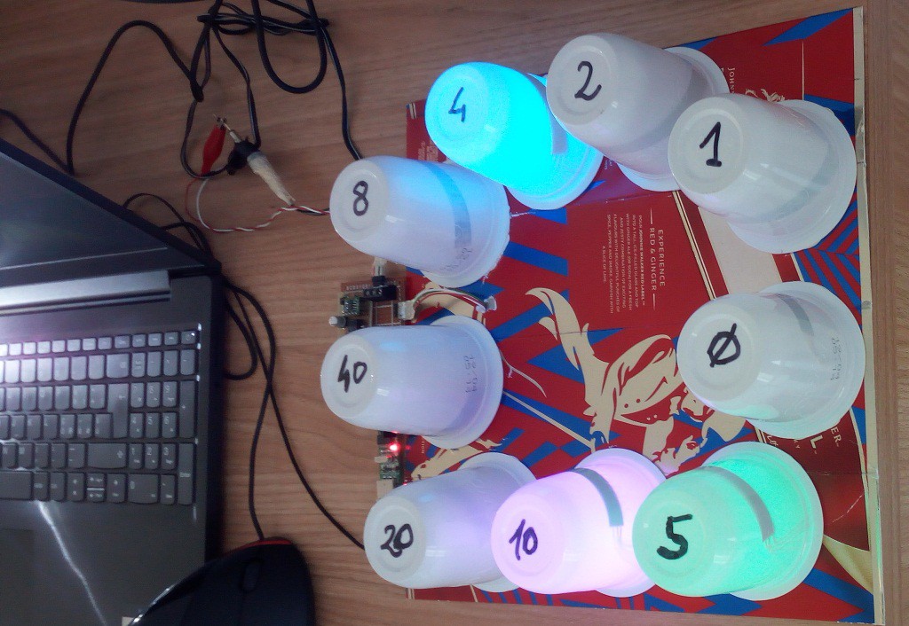

step 3: operational test (4.15 pm)
As you can see from the image, the minutes are counted from five to five and the hours range from 1 to 12 (all in binary, add the ON LEDs for the result). There is an additional led for the “zero minutes” situation because I don't like having the whole line off. The total pixels are therefore nine, the advanced one I keep it aside to do something...
