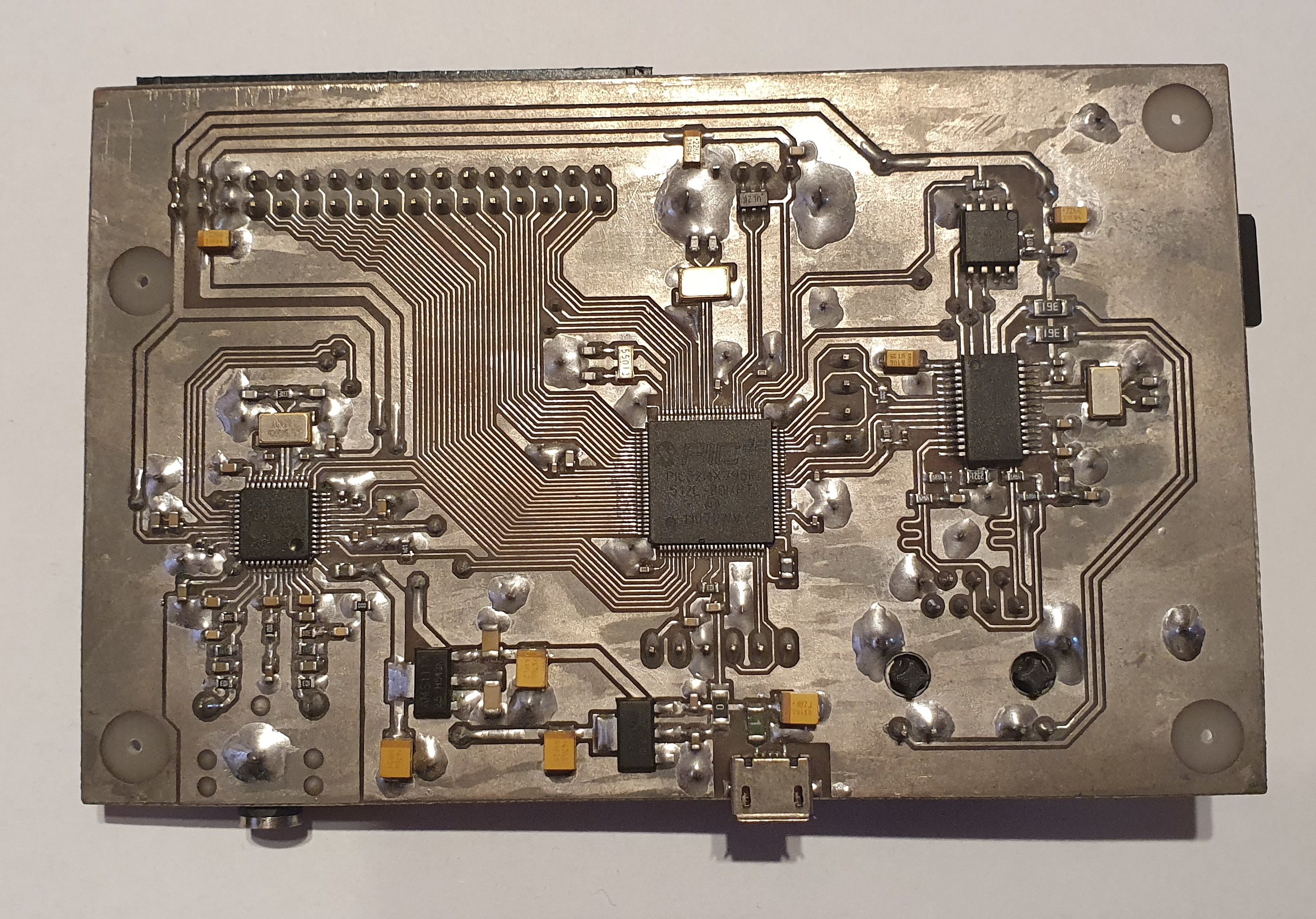

I decided to design and build such a device. First approach was rather straightforward - I decided to use a Raspberry Pi and MPD to play files and streams. That's how eMPeDocles project was born. At this point it was just for fun, as Chromecasts Audio and other similar devices were widely available. Basing device on Linux computer opened some interesting possibilities, but also had it's own set of drawbacks, like long boot time and relatively high power consumption for what was just a music player.
I decided to try yet another approach. Few years ago I began designing prototype board with PIC24FJ265DA210 microcontroller, VS1053 decoder chip and ENC28J60 Ethernet controller. When board was completed, to my dismay I discovered that despite MCU I used has plenty of RAM, most of it is not directly mapped to the address space and requires using special commands to access large part of it. This would force me to modify some libraries I was using.
Additionally microcontroller turned out to be a little bit too slow for playing audio streams from the internet. Main clock running at 32 MHz allowed me to set up max SPI frequency of 16 MHz, at which ENC28J60 was struggling to pass all of the data of some audio streams in time. Low quality radio streams - no problem, but trying to play better ones resulted in choppy audio. It became clear that upgrade was necessary..
I decided to upgrade MCU witch much better and more powerful PIC32MX795F512. Initially new version of a board was still using ENC28J60 as its gateway to the world. I knew new MCU has integrated Fast Ethernet MAC. I was curious if I will be able to use it with external PHY, on my homemade PCB. So I began redesigning board once again. It turned out that integrated Ethernet works fine.
With final hardware revision complete and mounted inside metal enclosure, I was finally able to focus on writing software. This is still ongoing project, but for now device does the most important thing - it plays local audio files and streams from the internet. Still much remains to be done: I need to write proper user interface + some webUI and remove some bugs.
