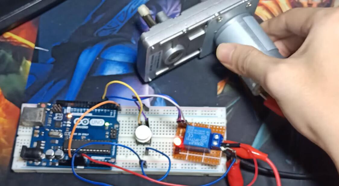

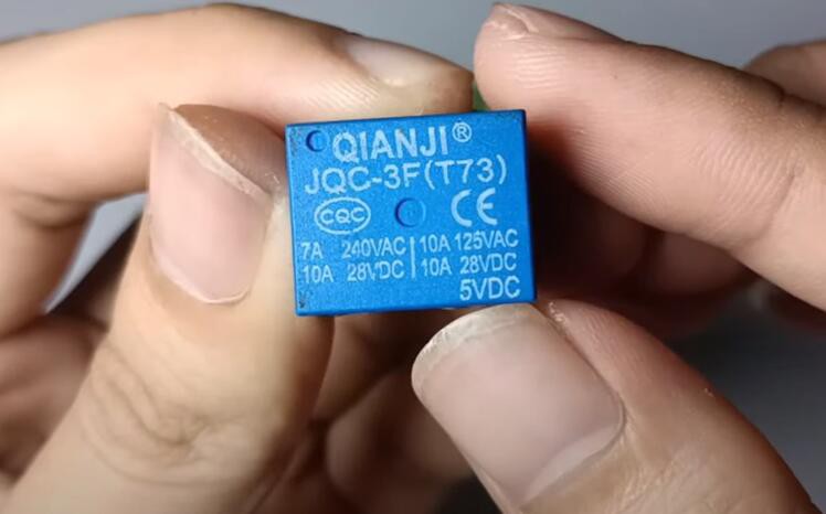

Today I will show to how to make Electronics projects 2021 with bc547,relay,led,
All the material you need for this project:
Here are the steps of this project:
1.
2.
3.
4.
5.
6.
7.
Show results:
The product links as below:
IC chips: https://www.utsource.net/category/ele...
Modules: https://www.utsource.net/Modules?sour...
Passive components: https://www.utsource.net/PassiveDevic...
Sensors: https://www.utsource.net/home/sensors...
LED lightings: https://www.utsource.net/category/led...
More electronic components you may be interested:
BAV99 https://www.utsource.net/itm/p/11736390.html
FT232RL https://www.utsource.net/itm/p/11218420.html
IRFB4227 https://www.utsource.net/itm/p/11232732.html
M48T86PC1 https://www.utsource.net/itm/p/11302425.html
5046X005 https://www.utsource.net/itm/p/4079161.html
For more details, pls check the video on youtube:
