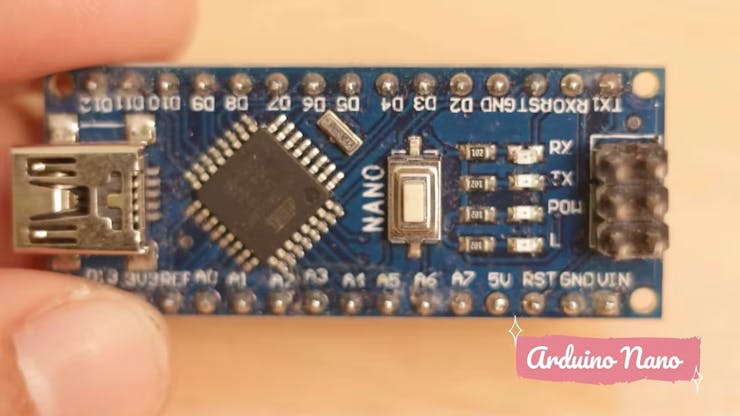

- ARDUINO NANO WITH CABLE

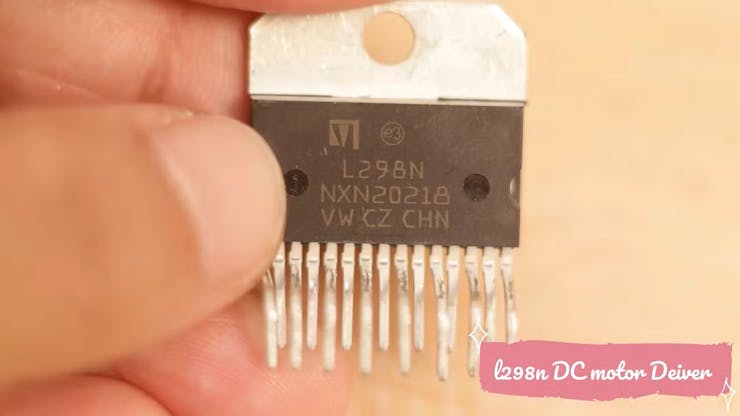

- L298N MOTOR DRIVER

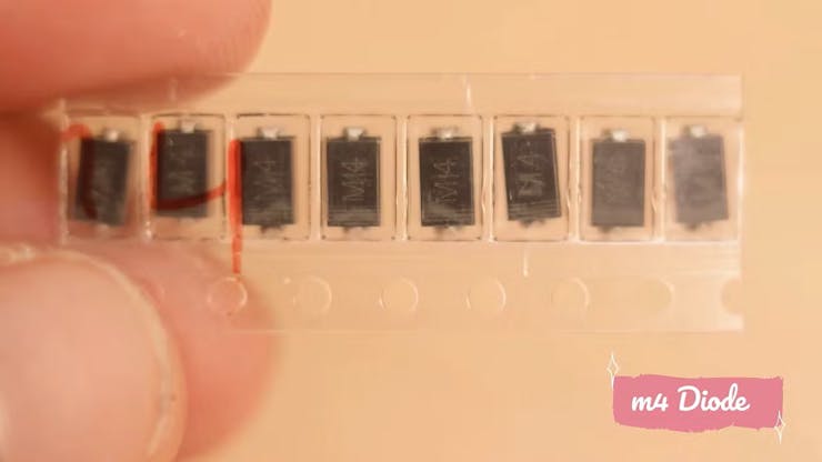

- M4 DIODE

Now please assemble all the components together to complete the project. this is very easy to do if you follow the simple connection diagram. But if you have any doubt on this you may watch this video for better understand
