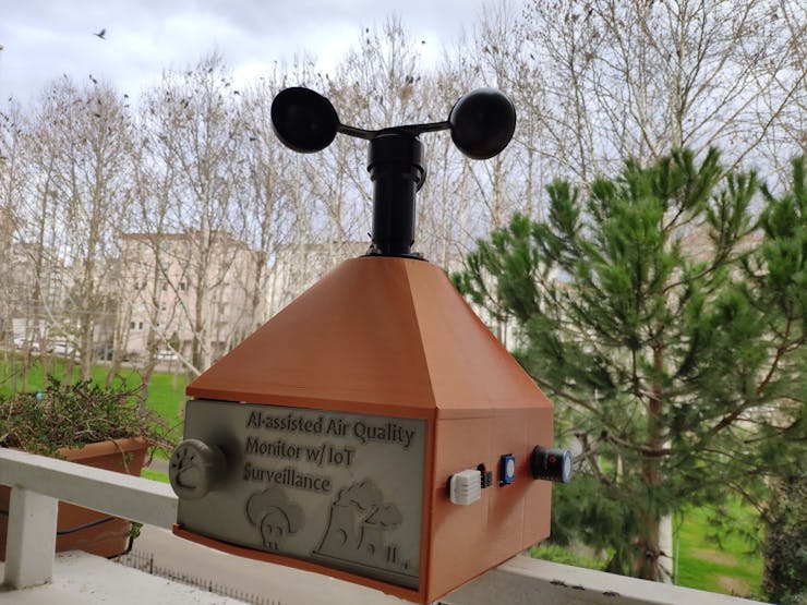

Step 1: Designing and printing a metallic air station case
Since I focused on building a budget-friendly and accessible air station that collects air quality data and runs a neural network model to inform the user of air pollution via a PHP web application, I decided to design a sturdy and compact metallic case allowing the user to access the SD card after logging data, place the air quality sensors, and adjust the OV7725 camera effortlessly. To avoid overexposure to dust and prevent loose wire connections, I added a sliding front cover with a handle to the case. Then, I designed a separate camera holder mountable to the left side of the case at four different angles. Also, I decided to inscribe air pollution indicators on the sliding front cover to highlight the imminent pollution risk.
Since I needed to attach an anemometer to the case to collect wind speed data, I decided to design a semi-convex structure for the case. This unique shape also serves as a wind deflector that protects the air quality sensors from potential wind damage.
I designed the metallic air station case, its sliding front cover, and the mountable camera holder in Autodesk Fusion 360. You can download their STL files below.
Then, I sliced all 3D models (STL files) in Ultimaker Cura.
Since I wanted to create a solid metallic structure for the air station case with the sliding front cover and apply a unique alloy combination complementing the metallic theme, I utilized these PLA filaments:
Finally, I printed all parts (models) with my Creality Sermoon V1 3D Printer and Creality CR-200B 3D Printer in combination with the Creality Sonic Pad. You can find more detailed information regarding the Sonic Pad in Step 1.1.
If you are a maker or hobbyist planning to print your 3D models to create more complex and detailed projects, I highly recommend the Sermoon V1. Since the Sermoon V1 is fully-enclosed, you can print high-resolution 3D models with PLA and ABS filaments. Also, it has a smart filament runout sensor and the resume printing option for power failures.
Furthermore, the Sermoon V1 provides a flexible metal magnetic suction platform on the heated bed. So, you can remove your prints without any struggle. Also, you can feed and remove filaments automatically (one-touch) due to its unique sprite extruder (hot end) design supporting dual-gear feeding. Most importantly, you can level the bed automatically due to its user-friendly and assisted bed leveling function.

Step 1.2: Assembling the case and making connections & adjustments
// Connections
// FireBeetle ESP32 :
//                                Arduino Mega
// D4   --------------------------- D18 (RX1)
// D2   --------------------------- D19 (TX1)
// Connections
// Arduino Mega :
//                                FireBeetle ESP32
// D18  --------------------------- D4
// D19  --------------------------- D2
//                                DFRobot Gravity: Electrochemical Ozone Sensor
// D20  --------------------------- SDA
// D21  --------------------------- SCL
//                                DFRobot Gravity: Electrochemical Nitrogen Dioxide Sensor
//                                SH1106 OLED Display (128x64)
// D23  --------------------------- SDA
// D22  --------------------------- SCK
// D24  --------------------------- RST
// D25  --------------------------- DC
// D26  --------------------------- CS
//                                DHT22 Temperature and Humidity Sensor
// D27  --------------------------- DATA
//                                DFRobot Anemometer Kit
// A0   --------------------------- S (Yellow)
//                                Keyes 10mm RGB LED Module (140C05)
// D2   --------------------------- R
// D3   --------------------------- G
// D4   --------------------------- B
//                                Control Button (A)
// D5   --------------------------- +
//                                Control Button (B)
// D6   --------------------------- +
//                                Control Button (C)
// D7   --------------------------- +
First of all, I soldered female pin headers to FireBeetle ESP32 and male pin headers to the FireBeetle (Covers) media board before attaching the OV7725 camera.
Due to the Arduino library incompatibilities and the memory allocation issues, I decided to connect the electrochemical NO2 sensor, the electrochemical ozone sensor, the anemometer kit, and the DHT22 sensor to Arduino Mega so as to collect the required air quality data. Then, I utilized Arduino Mega to transmit the collected air quality data to FireBeetle ESP32 via serial communication.
#️⃣ When the electrochemical NO2 sensor and the electrochemical ozone sensor are powered up for the first time, both sensors require operating for about 24-48 hours to generate calibrated and stable gas concentrations. In my case, I was able to obtain stable results after 30 hours of warming up. Although the electrochemical sensors need to be calibrated once, they have a preheat (warm-up) time of about 5 minutes to evaluate gas concentrations accurately after being interrupted.
#️⃣ Since the anemometer kit requires a 9-24V supply voltage and generates a 0-5V output voltage (signal), I connected a USB buck-boost converter board to my Xiaomi power bank to elicit a stable 20V supply voltage to power the anemometer.
Since Arduino Mega operates at 5V and FireBeetle ESP32 requires 3.3V logic level voltage, they cannot be connected with each other directly. Therefore, I utilized a bi-directional logic level converter to shift the voltage for the connections between FireBeetle ESP32 and Arduino Mega.
To display the collected information and notifications, I utilized an SH1106 OLED screen. To assign air pollution levels empirically while saving the collected data to individual CSV files on the SD card, I used the built-in MicroSD card module on the media board and added three control buttons.

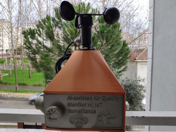

After printing all parts (models), I fastened all components except the OV7725 camera to their corresponding slots on the metallic air station case via a hot glue gun. I also utilized the anemometer's screw kit to attach it more tightly to its connection points on the top of the metallic case.
I placed the OV7725 camera in the mountable camera holder and attached the camera holder to the metallic case via its snap-fit joints.
Then, I placed the sliding front cover via the dents on the metallic case.
As mentioned earlier, the mountable camera holder can be utilized to adjust the OV7725 camera at four different angles via the snap-fit joints.
