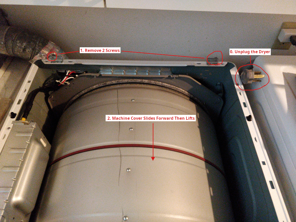

    Disconnect the power from the machine before doing anything!
    First, undo the two screws at the back of the dryer in order to remove the top panel. The top panel will slide forward then lift off once the two screws are removed.

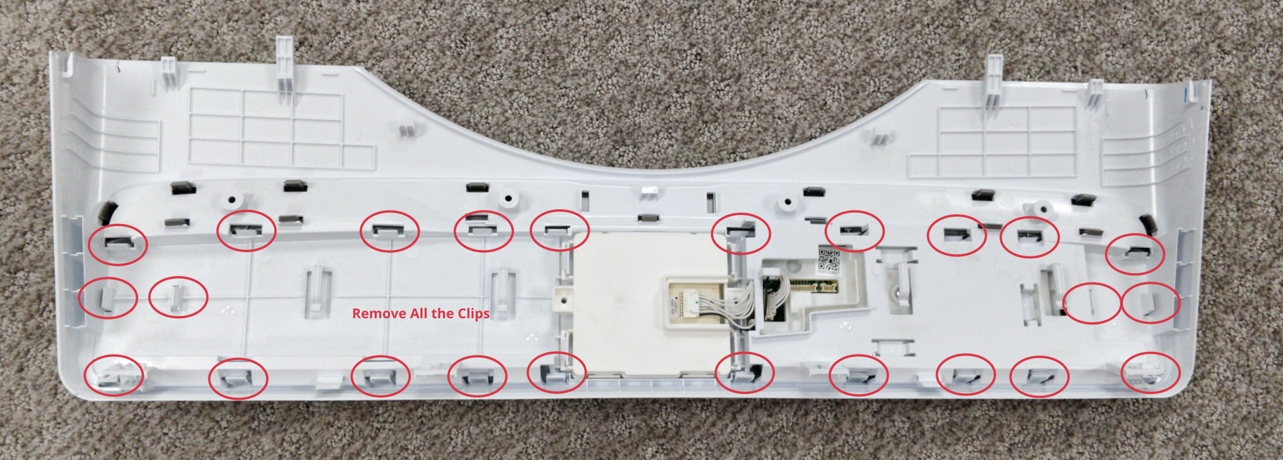

    Once the top is off, there are four screws along the front of the machine that hold the front panel piece on. Undo them, then carefully pop the front panel forward a bit. Behind the panel are two wires with connectors that clip on. Grab and squeeze the clips while removing the wires.
    Once the wires are disconnected, the whole front panel pieces comes off and can be taken elsewhere.

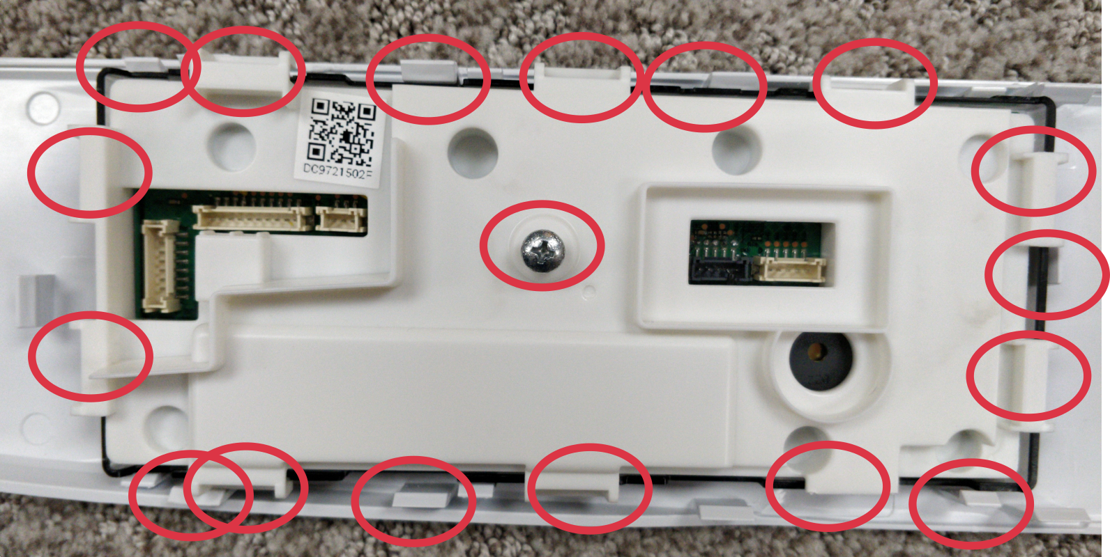

    Unclip the last wire from the control board (comes from the encoder), then you have to pop off all the clips.
    Finally, after a few more clips and one last screw we have access to the control board.

    I spent some time reverse engineering the board to figure out where to connect to. There is conformal coating which makes soldering a bit more tricky, but definitely possible.
    You can see the wires I ended up with. I connected to 12V, GND and RX3 (which comes from the central controller.
    You need an ESP-based board that manages to fit within the cover of the board.
