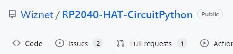

WIZnet/RP2040-HAT-CircuitPython
The library using the Wiznet Ethernet Chip on the RP2040, Pico's MCU, is located at the link above.This library allows you to simply attach W5100S to Pico.

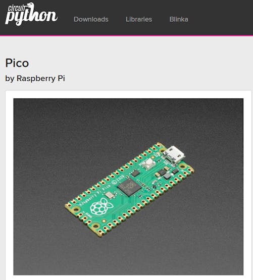

First of all, I worked in the CircuitPython environment. Therefore, RP2040 needs to be set up for the CircuitPython environment.
Circuitpython Raspberry pi Pico
You can easily set up the RP2040 for CircuitPython environment by downloading the UF2 file from the official website and putting it into a folder.

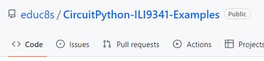

QVGA ILI9341 2.2 TFT SPI 240x320
I referred to the ILI9341 section in the Git I shared earlier. It is explained in detail and is easy to follow, so you can easily implement it.
CircuitPython-ILI9341-Examples
It's educ8s' Git, and since there was no information about the license, you used it. If there are any issues, you can take it down immediately.

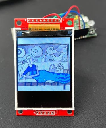

Saving the data in BMP format and displaying it on the LCD.
bmp_data = bytearray(buf)
with open ("test.bmp", "wb") as f:
f.write(bmp_data)
group = displayio.Group()
display.show(group)
bitmap = displayio.OnDiskBitmap("/test.bmp")
tile_grid = displayio.TileGrid(bitmap, pixel_shader=bitmap.pixel_shader)
group.append(tile_grid)
Now all that's left is to display the data received from the server on the LCD!
Congratulations, you've completed the project!
