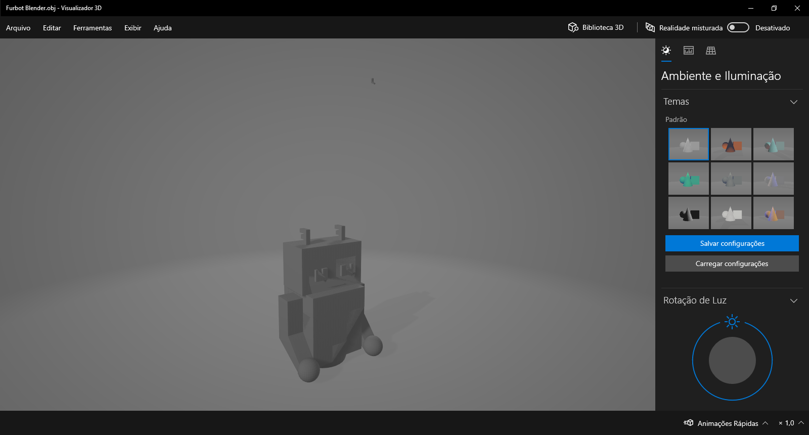

With the introduction of the National Common Curricular Base (BNCC) several discussions have taken place in order to identify what is the best way to effect the inclusion of Computer Science fundamentals, specifically related to Computational Thinking (PC),in basic education. During the last twelve years, a technology for the development of PC skills in undergraduate courses has been developed and improved, called Furbot, which four years ago became a game and was successfully applied in Elementary School I in state public schools in the Blumenau region. Thus, the game Furbot, developed in Unity 2D, aims for the player to leave a point of origin and reach a point of destination by guiding a robot along a path and dodging obstacles using programming commands.
The idea is to replace the virtual by a real Robot and make the movement using infrared, card images (Amazon Rekognizer), and voice (Amazon Alexa)
Replacing a human :) and make the kids happy!
The purpose of this project is to create a robot car with ominidirectional step motor wheels, and replace one of humans by a Robot in this large game board developted in the FURB, Blumenau´s University, Brazil. The control will be using infrared and the most importante, Voice and Image Rekognizer, both services of Amazon.
