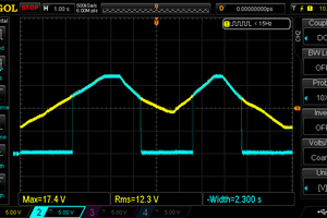

The brain is a HCF4060 14 bit counter.  It's driven by a resonator.  Bit 14 starts low, causing it to make the full current.  When bit 14 turns high, it makes trickle current.  The battery type changes the speed of the resonator.  It has different positive terminals for AAA, AA, C/D to vary the current.
The long desired interface was to manually put it in full current mode with the timer or to manually put it in trickle charge mode.  The problem with using the timer is it would always be vulnerable to glitching back into full current mode.  The decision was made to just disconnect the timer, manually select full current or trickle current with a switch.
