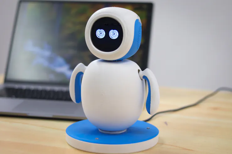

The whole design was done in Autodesk Fusion 360 and design incorporates a combination of solid and free-form modelling techniques.
To streamline the printing process, we divided the robot body into several parts that can be easily assembled using screws.
We carefully considered the placement of the power source, situating it at the base and allowing ample space for the power cable's unrestricted movement. While addressing the cable movement was our primary concern, we also ensured that the body maintains a slight contact with the base to enhance stability during motion.
To elevate the robot's visual appeal, we chose an attractive blue-and-white color scheme.
