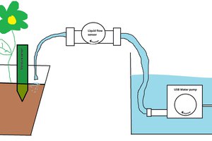

The first part I had was this huge jar that I thought was a nice base / water tank. So all the electronics were supposed to sit on top of it. The heart of it is an ESP-32 that connects to the wifi in my shop to check for the time. In the future I might connect it to a cloud to to track what is happening there as well.
The system is powered with a 12V Mini-USB phone charger. This can supply the pump directly and gets converted to 5V for:
- the ESP
- the 128 x128 OLED display
- two capacitive soil moisture sensors
- a water level sensor
The pump is controlled via a relay but can also be bypassed with the second button without even starting the esp. The moisture sensors are programmed to measure five times in a row and the average value of these is then displayed on the screen.

The pipes are just punctured aquarium tubes and one pump supplies both of them. Therefor there is a calculation that only starts pumping if both pots are dry enough.
