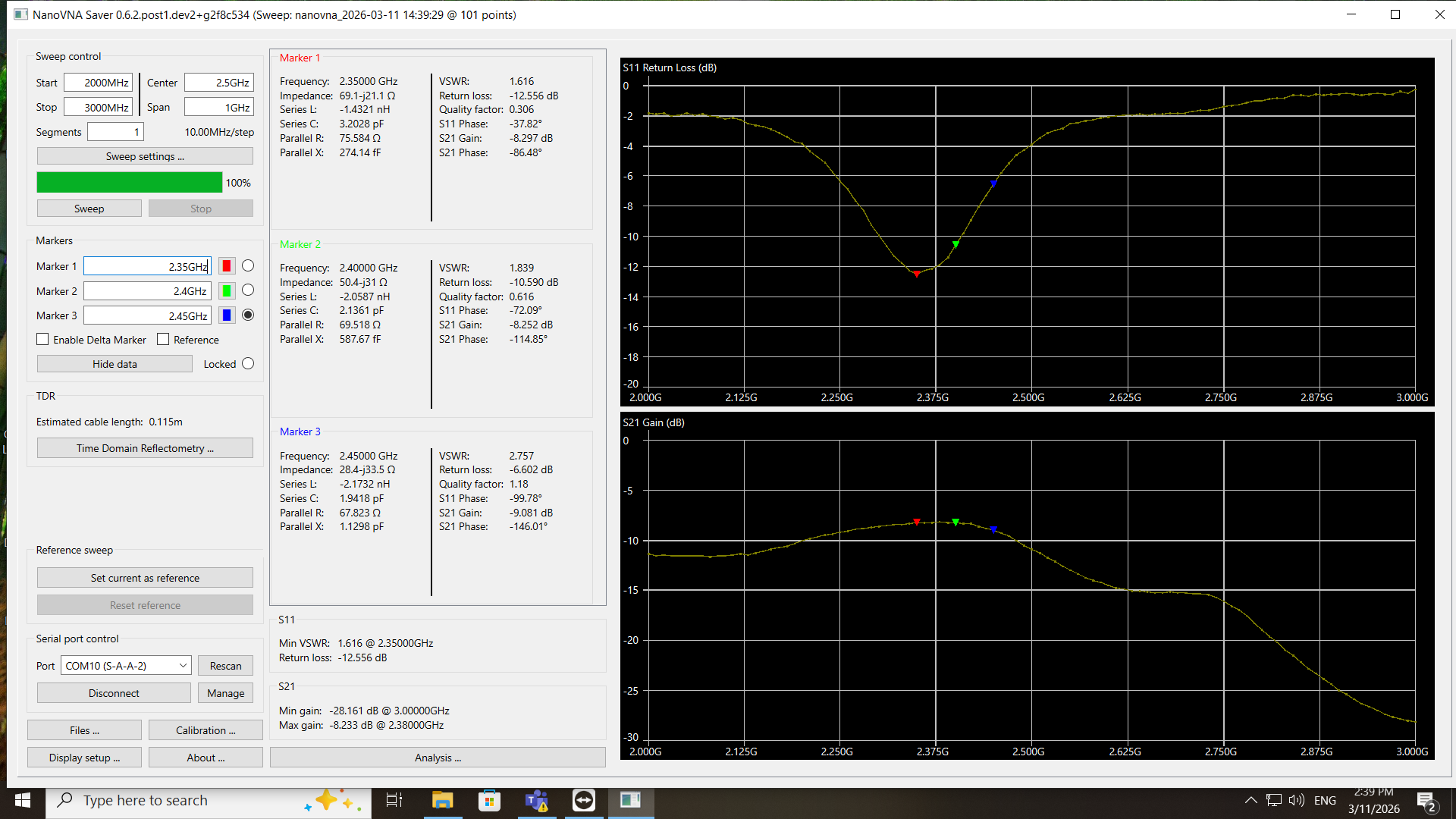

Experiment

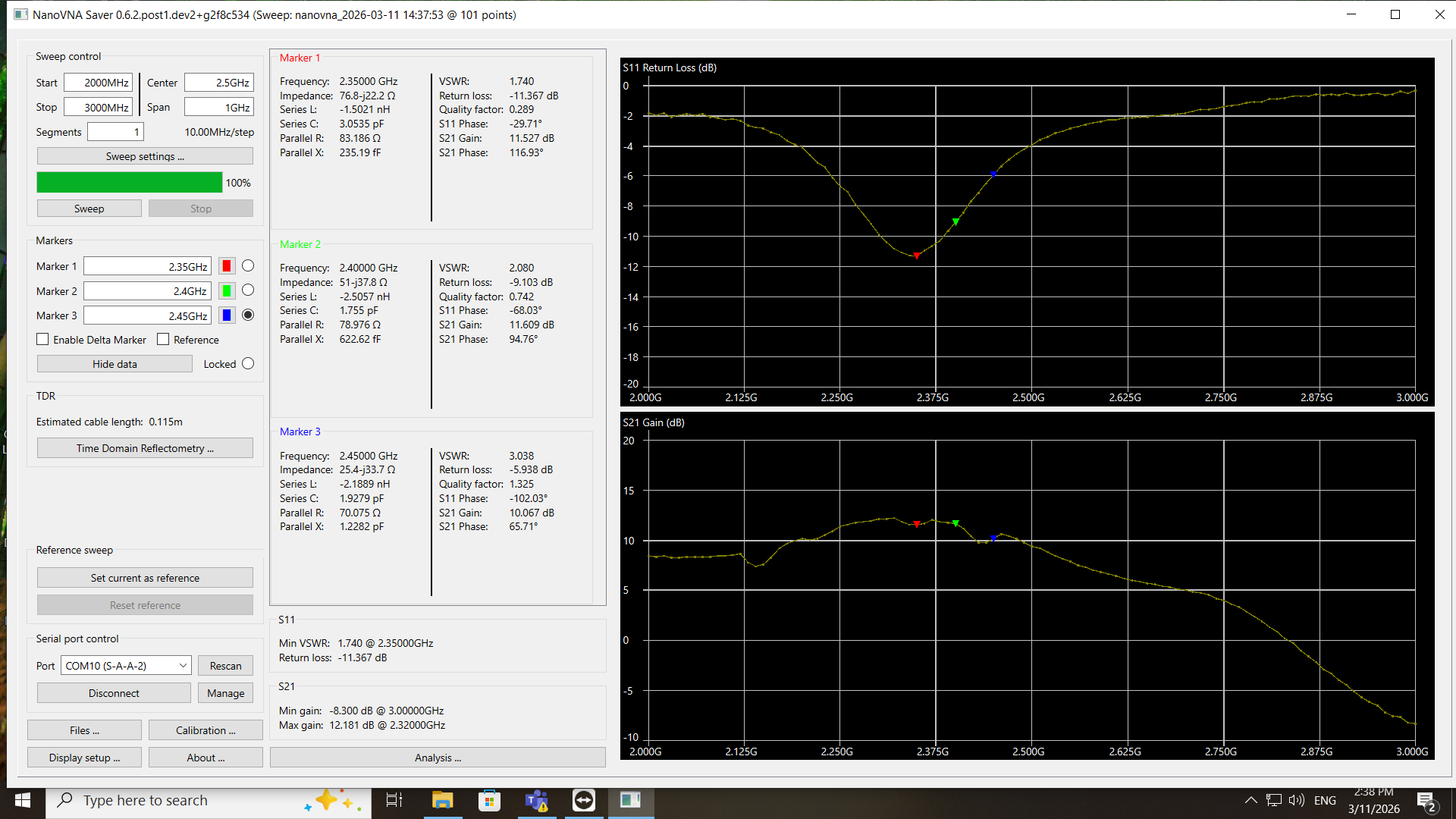

  • 20dB attenuator at spectrum analyzer input.
  • 10dB attenuator at RF2126 module input improves gain flatness, so seems like the signal generator source impedance is not perfectly equal to 50 Ohm. See the log for the second module modification results.
  • The result might be 1dB better, one cable (1m) extra with module measurement.
  • The gain measured around 8.5...9 dB which is a good match with the simulation.

  • Second RF2126 module modified
    Denys Zaikin09/08/2023 at 20:30 0 comments
    Notes
    • The second module was modified with the same modifications. Looks OK.
    No attenuator at the input, only a 20dB attenuator at the spectrum analyzer input
    10dB attenuator at the input of the RF2126 module
    Short/long cable comparison
    • 20dB attenuator at the input of the spectrum analyzer.
    • The cable length is 150mm (Wuerth RG174/U 65503503515303) from the generator to the input of the module.
    • Comparison between 150mm and approx. 1m (RG174) lengths on the output of the module.
    • Seems like 1m cable had approx. 1dB of losses.
View project log
