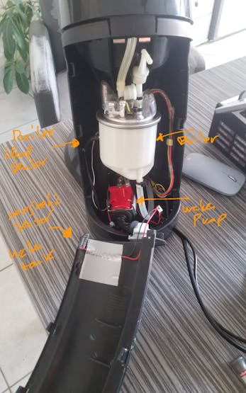

This Home Automation Smart Coffee Machine Add-on was designed and prototyped by me using KiCad. Is of easy installation on any home or office coffee machine, and enables any vintage coffee machine connectivity to the internet (or a personal network).
The PCB uses an ESP32 S3 packed with Bluetooth, BLE, and WiFi compatible with major software vendors such as Apple Home, Google Home, Matter/Zigbee, Home Assistant, and many others.

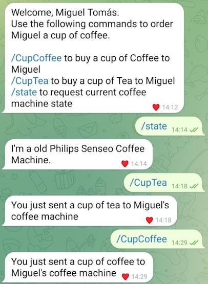

The custom firmware coded includes the functionality of someone sending for a cup of coffee (or other) request from the Telegram Messenger App. In return, it sends a receipt as proof a coffee was indeed brewed on the coffee machine.

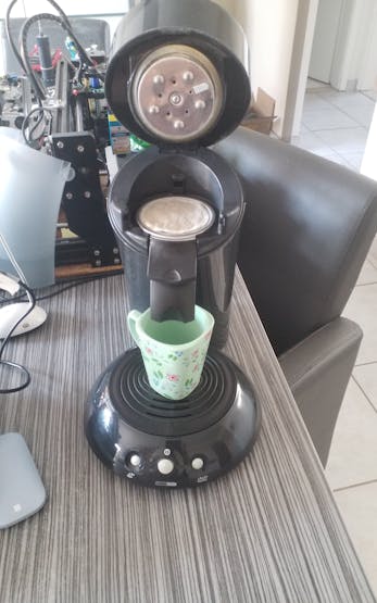

Philips Senseo Coffee Machine

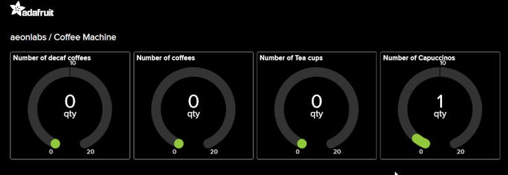

Functionalities available:

Try it right now on Telegram
Is now #official. Anyone can "buy me a coffee" on Telegram. Just start a conversation with MiguelCoffeeMachineBot here and send a message /start to view available commands. (office hours only , CET)
Example of a cup of coffee request made on Telegram
Available Commands
Try it out is free and is #FUN. No money is asked! Great for a meeting or a conversation online. No excuses not to have a cup of coffee with colleagues while working remotely. ( online during office hours, CET )
Testing the firmware code
Brewing the very first coffee request on the Philips #senseo coffee machine. How #cool 😎 😍 is that? And testing the cup/mug presence sensor. I've used Arduino Studio 1.8 and also MS Visual Code for coding the firmware. For debugging, I used the coolTerm Windows app for UART 2 USB serial communication.
Mod Installation Overview
To make this work it was necessary to install a magnetic sensor behind the water tank and also a DS18b20 temperature sensor on the white boiler. The water pump is activated using the already-existent Philips PCB electronics.
back of rhe Philips senseo coffee machine

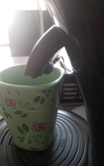

Below is possible to see in greater detail the installation of a cup/mug sensor. I utilized the VL6180x sensor which also allows measurement while filling the cup. Short, medium, and full cup options are possible with this smart add-on.
Detail of the cup/mug sensor
Data Usage Statistics
I've created a Dashboard on Adafruit IO with some simple usage statistics check it out here.
