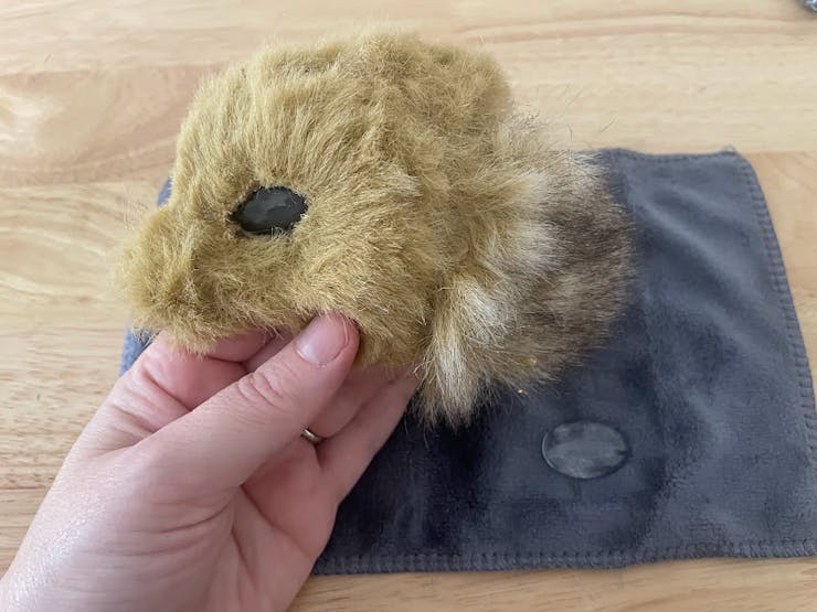

After the 3D skull was completely covered with Worbla I cut out a section of faux fur and shaved it down using a beard trimmer. Don't go as short as you want the finished project as you'll do some more trimming once everything is assembled, but getting some of the bulk of the fur removed early on is helpful for attaching it to the 3D printed skull. This was SUPER messy, do this outside if you can.
I then traced lines on the back radiating out from areas I knew it would have to curve around the shape of the skill, generally radiating from the bridge of the nose. Using a utility knife, I carefully cut the lines.
Make sure to only cut through until the base of the fabric separates, do not chop any of the fur on the other side.
I then heated the Worbla on the 3D printed skull and began sticking the fur to the activated adhesive. This part is tricky because your PLA will also get warm enough to start to warp so as it cools make sure you're helping the plastics reform to the right positions. You may need to cut a few extra lines, trim off excess or otherwise manipulate the fabric to be where you need it.
I also had to cut a few extra few extra pieces that I did not trim the fur on that would go behind the ears so it was a smooth transition when I eventually create a body for the fox.
This wasn't an exact science, do what you have to do to make it look right.
I then trimmed out the eye shape with sharp pair of embroidery scissors.

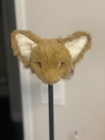

The ears were created using trimmed down fur of the same color as the head and also some trimmed down white fabric. I didn't capture photos of the process but here are the step I followed:
1. Cut out a triangle shape out of cardboard and cut a slightly curved line along the bottom that follows the general slop of your fox head where the ears will be places.
2. Use this as a template to cut out the Worbla, make sure to flip the template over for the second one, as you need ears sloping in opposite directions.
3. Cut out fur slightly bigger than your template.
4. Cut a wooden dowel about 2 inches long, The dowel should be around 1/4 inch thick or less but don't go too thin.
5. Heat your Worbla to the point where it feels stick on both sides and put your dowel so it's 1/2 inch from the bottom of the ear in the center of your ear. Place your normal fur color to one side, and the white fur to dowel side, press firmly until cooled.
6. Re-heat and gently shape the ear so it has a small rounded fold around the edges and gently curve over all.
7. Repeat for the other ear.
8. IMPORTANT: WAIT TO DO THIS STEP UNTIL YOU'RE READY TO MOUNT YOUR SEVOS. See further down in the instructions. Drill holes in the head the size of your dowel where the ears should be placed and insert ears. They should swivel freely without resistance when you try to move them.

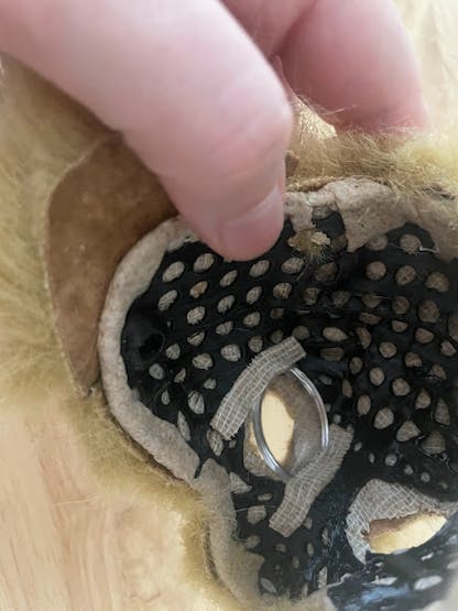

Next I made eye lenses so the eyes would have depth and reflection. I used the oval shape from this mold on Amazon and some clear hard cast resin. I then attached the lenses using some Worbla (always save your scraps!).
And that's it you've got a fox head ready for some tiny screens and servos! Along the way your head might have gotten warped. Don't be afraid to re-heat it and shape it back to how it's supposed to look.

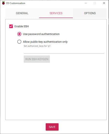

3. I like to pre-configure settings and recommend you do so as well:
Set username and password, configure wireless lan, and set locale settings:
Enable SSH incase you ever need it:

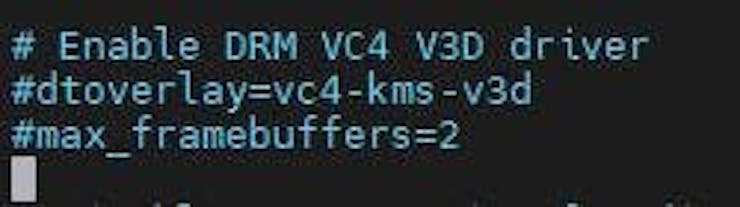

2. Remove the conflicting DRMVC4 statement, type:
sudo nano /boot/config.txt
Delete this section:
CTRL X to exit, Y to save

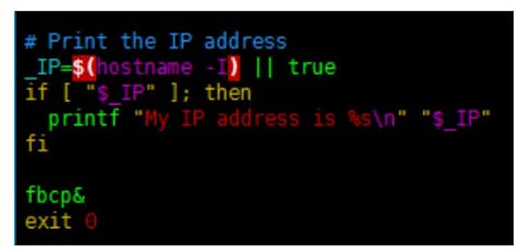

5. Setup this functionality to start automatically when you boot your Pi, type:
sudo cp ~/Waveshare_fbcp/build/fbcp /usr/local/bin/fbcp
sudo nano /etc/rc.local
Add fbcp& before exit 0.
Important: You must add "&" to run in the background. Otherwise, the system may not be able to start.

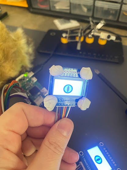

Mount the Eyes
First put globs of mounting putty on front and back corners of your screens. GENTLY get your screens into position resting flat against the lenses on the inside of the skull. If you press too hard your screens WILL break.
I recommend having your screens on with the animation playing so you can see where you're positioning your eyes. When you're happy with the placement carefully place mounting tape all around the edges of the back of the screen and the inside of the skull.

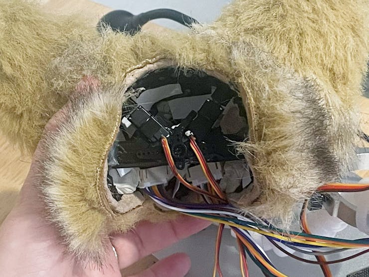

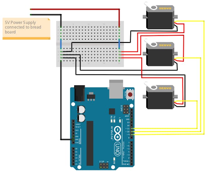

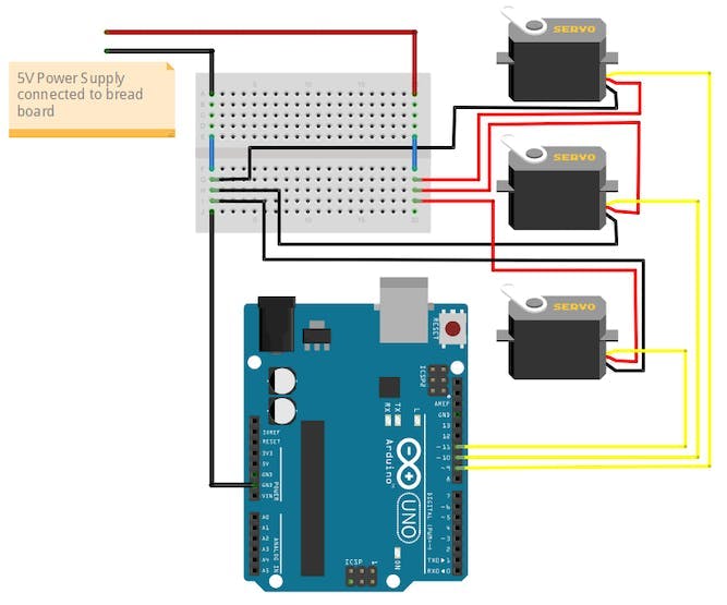

Hook Up Your Servos
The first step is to hook up your servos to your UNO. If you purchased the same servos I used from Amazon the wires are as follows:
The Uno has issues powering servos consistently at 5V and you'll be hooking up multiple servos to 5V, so I recommend using an 5V power supply.
The signal wires will connect to Uno Pins 9, 10, and 11 and the servo power and ground will connect to the power supply. ** Make sure you connect your power supply's ground to your Uno's ground**

Servo and Uno Circuit Diagram
How to connect the servos, uno, and power supply.

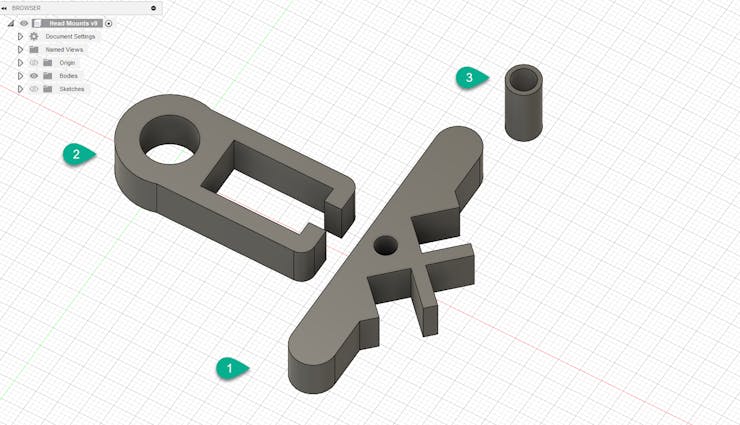

Mount Your Servos
I created mounting brackets and connectors for my servos in Fusion 360 and have attached the STL to this project.
1. Is a cross sectional bracket that will be glued to the inside of the skull under where the ears go and will hold the two ear servos.
2. Is a mounting bracket to hold the larger servo that controls the head tilt and is connected to whatever will be your spine apparatus. I designed the mounting hole to be compatible with this poseable ball socket armature, but I may swap this out for something else later.
3. Print 2 of these, they're the connectors between the small servos and the dowels extending from your fox ears.
Place the #1 cross sectional bracket where you want it in the skill, with the servo slots pointing towards the top of the head and hot glue in place.
Drill two holes in the skull slightly larger than your dowel connectors on your fox ears and lined up with where the servos will be placed and the where the connectors will extend to.
Next make sure to set your servos to 90 degrees:
In order for your ears and head to be at the right position and able to move to the left and right, you need to set your servos to be stuck in the 90 degree position, which is the middle position for your servos that can rotate between 0 and 180 degrees. By setting them to this position when you attach everything, they'll be in the "neutral" position.
Upload the following code to your Uno:
#include <Servo.h>//created by Smalls on Nov 8 2023Servo right; //create servo object to control a servoServo left; //create servo object to control a servoServo center; //create servo object to control a servo// twelve servo objects can be created on most boardsvoid setup() {right.attach(9); //attaches the servo on pin 9 to the servo objectleft.attach(10); //attaches the servo on pin 9 to the servo objectcenter.attach(11); //attaches the servo on pin 9 to the servo object}void loop() {right.write(90); //resets servo to neutral positionleft.write(90); //resets servo to neutral positioncenter.write(90); //resets servo to neutral position}
Advice I've gotten from others who have made companion bots is that you need to make it so some of your more common parts, like servos, can be easily replaced. To make sure this was possible I used hot glue to attach the dowel connectors to the servo heads, and mounting putty to place the servos into their slots.
Fill the dowel (wider) end of the dowel connectors with got glue, wiping away any excess from the top and then place your servos into their slots inside the head, push the rod from the outside of the head and then into the dowel connector on the other side, hold until dried. I recommend doing one at a time.
The larger servo that connects to the head can be slide into place and shouldn't require any glue, but you ca use some mounting putty to help ensure the servo never wanders:
I did glue my spine apparatus into place, but make sure you know exactly what you're going to use to attach the head to the body before you do so.
The las step is to connect in the hole cross connector to the larger servo post. This was designed to be a friction fit and should not require glue.
Re-upload the random servo code from earlier in the project to your Uno.
Plug in power to your Uno and Raspberry Pi and watch your little buddy come to life!
